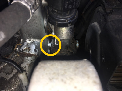

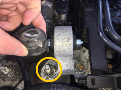

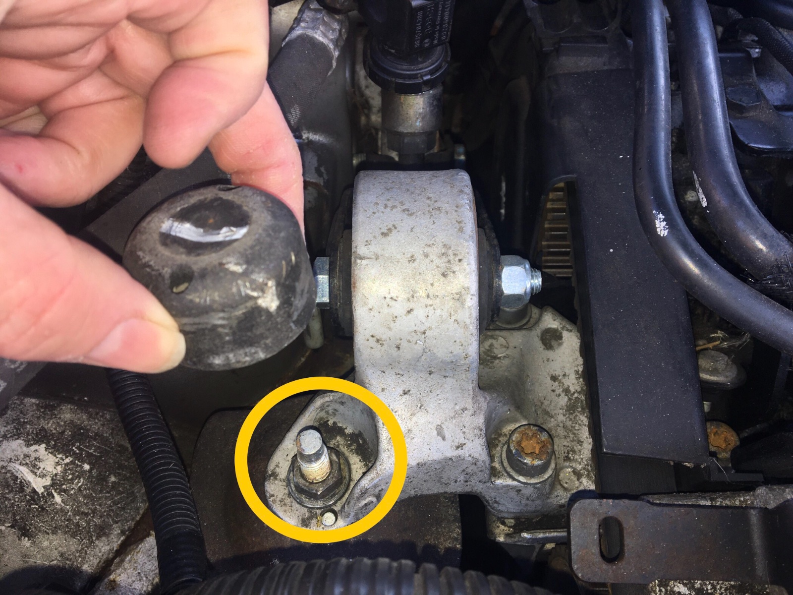

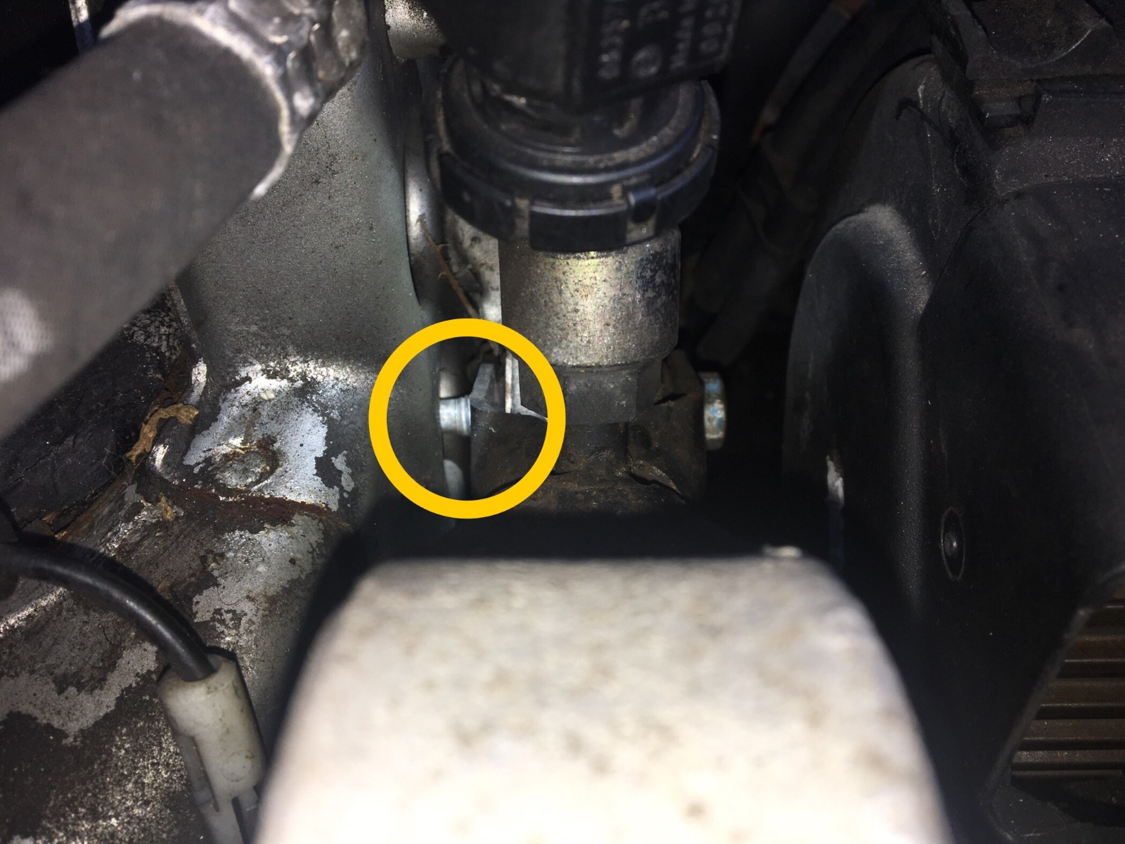

When the top engine mount got ripped apart early last year, the engine moved forward on the offside by about 4”.
Is the part of the engine restraint missing a nut does anyone know? There seems to be a threaded hole in the bulkhead but certainly NO space to get a nut inserted? Feeling confused as it’s over a year ago.
Second photo shows what I assume to be an anti-vibration weight. Do I just need to araldite that onto the highlighted stud?

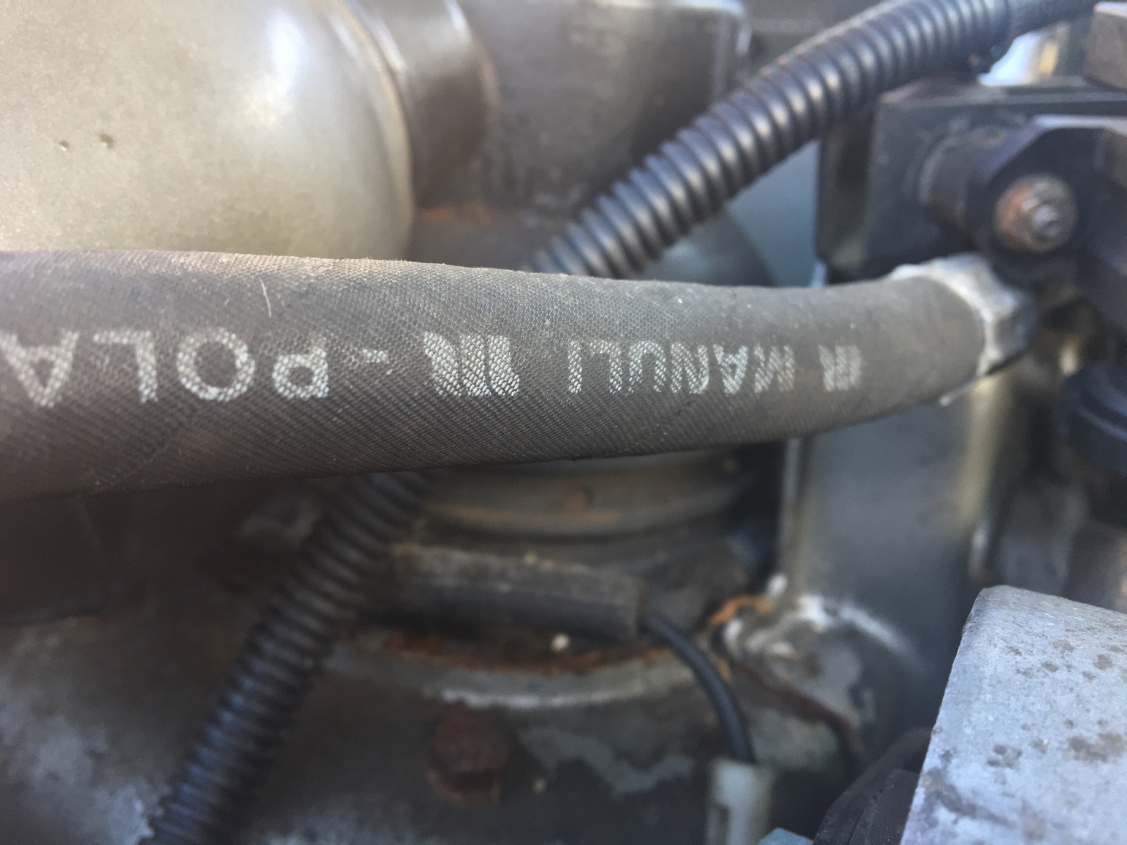

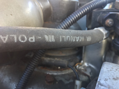

And finally the strut tops exhibit cracking to the rubber on the top and underside. But are they still OK? They look straight!

Roger, yes that is indeed what that weight is... It should just screw onto the highlighted stud... Don't araldite it on else you'll never be able to remove the engine mount again!
Holes in the strut top flange will be a fail...

CitroJim wrote: 09 Mar 2021, 09:09 Roger, yes that is indeed what that weight is... It should just screw onto the highlighted stud... Don't araldite it on else you'll never be able to remove the engine mount again!
There;s nothing to screw it in to, Jim! It just looks like rubber on the underside for the weight.
There are no holes in the strut tops just perished rubber at the moment.
