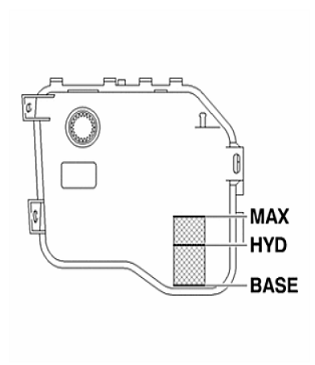

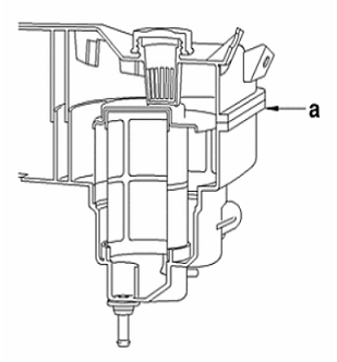

Hi
The info above in this thread was for a MK III C5.
For a MK I, the checking and filling of the LDS level is done with the vehicle on the LOW suspension setting (make sure you are on level ground).
There are different level markings for Hydractive 3 and for Hydractive 3+ systems:
" a" : LDS fluid minimum level.
If the level is below the " a" mark, add 1 litre of LDS fluid.
MAXI mark on the LDS fluid reservoir.
LDS fluid maximum level:
- Hydractive suspension 3 : Reference BASE
- Hydractive suspension 3+ : Reference HYD

Re: Suspension fluid reservoir
Thanks Marc, that is very helpful, so with the suspension on the lower settings the fluid need to be between base and max marks. I'll check this tomorrow, and about the Hydractive 3 vs 3+, I read somewhere that if the car has the sport button the system is a 3+, is that right?
Thanks, I couldn't wait and went check the level in the dark, and with the suspension on the lowest position the level is just below the base mark, and just a little above the little "basket" inside the reservoir. I'll let it settle until tomorrow and check it again.
