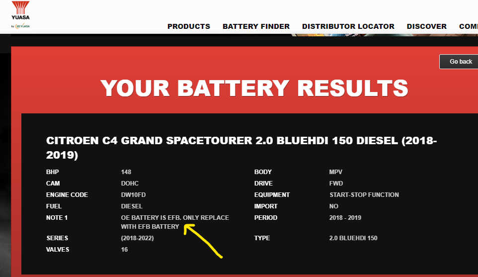

I just provided the official stance from Citroen - not your 'dealer mechanic's' personal interpretation!
Why do you think companies like YUASA clearly state this? See here in yellow:
Take it or leave it. Not sure why you bothered asking
