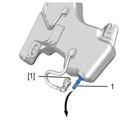

Ok, so for topping up 1 litre is recommended - generally, if you were replacing the additive tank completely, then you would fill it with the 3 litres.
To work out what you need, the tank can be removed and then tilted forward, but you'll need a set of plugs and all that....
Empty the reservoir into a measuring cylinder (Tilt the tank as in the illustration ).
Measure the quantity of additive and compare with the table below.
So looking at your mileage as an estimate and the guide above - and assuming they default amount filled at factory as per the 0 mileage in the table above is 1.57 litres, you should be able to work out what you've used roughly. So you may be able to get a couple of litres in at least.
| Distance covered ( miles ) | 0 | 18750 | 37500 | 56250 |
| Quantity ( litres ) | 1,57 | 1,114 | 0,658 | 0.202 |
