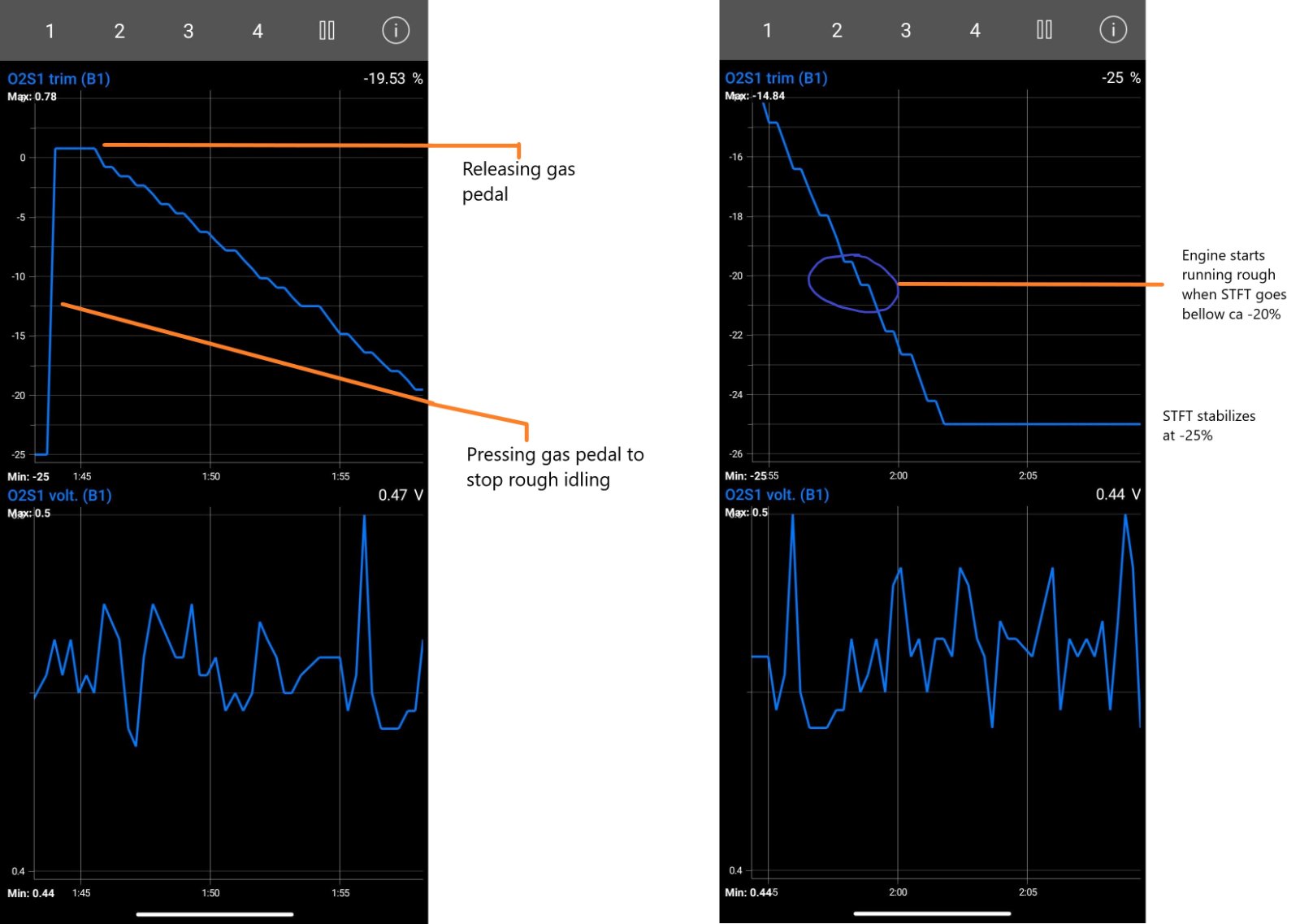

Bellow is a picture showing STFT and O2 bank 1 readings could it be related to the MAP sensor ? (this car does not have MAF sensor)xantia_v6 wrote: 24 Jan 2021, 03:42 The short term fuel trim is governed by the readings from the oxygen sensor. What do the readings from the oxygen sensor do at the same time?

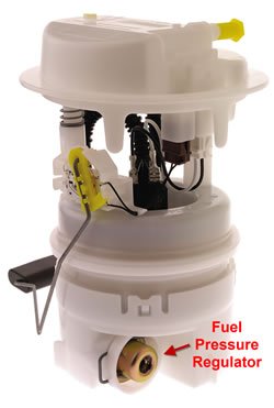

when I changed the fuel pump, I only changed the pump itself, not the whole assembly. I am starting to think there might be a Pressure regulator in the assembly that is causing the fuel pressure to be too high/low? haven't measured the fuel rail pressure yet but will do.

I am thinking that the "fuel pressure regulator" might be bad. So i will get the proper equipment to measure the rail pressure.

So I have now measured the fuel pressure, which is stable at 3.5 bars. But! I noticed the Negative terminal clamp on the battery was a little Slacks, Not loose but had some movement in it. I changed both clamps to the screw type as well as taking off all grounding points and sanding away any oxidation. to my surprise, the engine hasn't had a single stutter after this. I am hoping this has been the issue all along!
