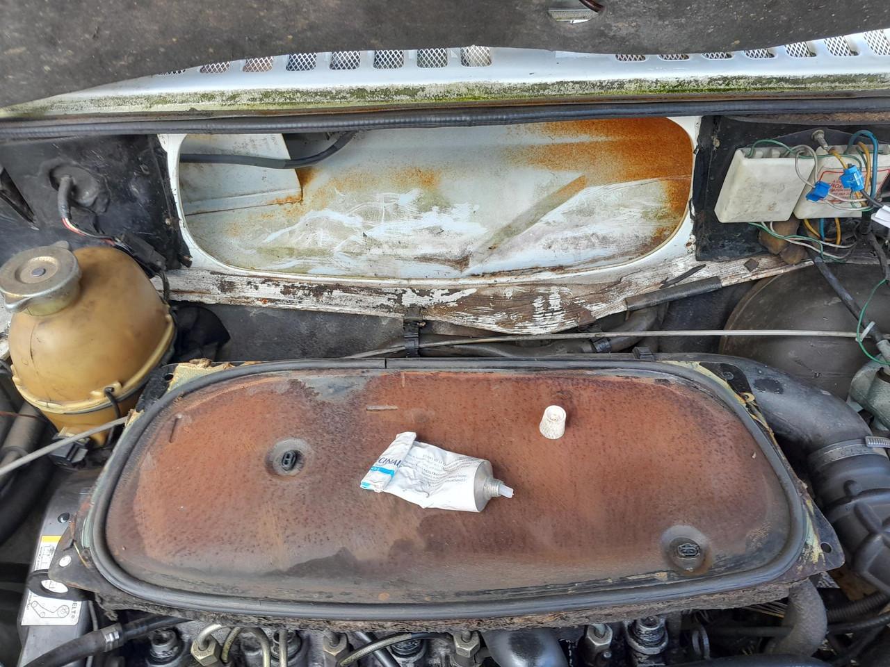

Bonjour everyone. Now we've got Christmas out of the way I need a little advice. My 95 C15 van is leaking water into the cabin and I'm sure it's coming in via the bulkhead air intake. The drain appears to be working but before I start taking the thing apart can anyone tell me whether there is an access panel behind the insulation where the jack & wheelbrace fit? If not it's looking like I'm going to have to set to and get my angle grinder out to create one. Putting a hose pipe into the scuttle top vent, there is plenty of water coming out of the drain hose but then I start to see drips coming into the cabin after a minute or so as though the drain isn't doing it's job hard enough.
I'm reluctant to start hacking away at it but I can't see any other way of getting in to where it needs to be sealed. It will be 30 years old day after tomorrow and it still runs like a good 'un.
Any help/advice would be much appreciated.
I have temporarily taped off the grille with duct tape to keep the rain out...

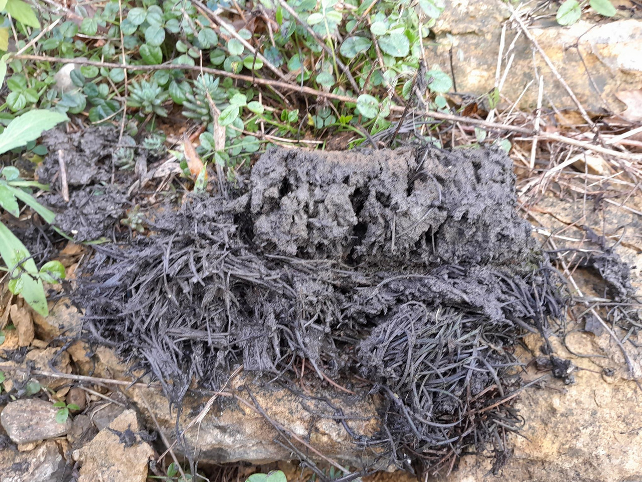

Today, after the excesses of Christmas & Boxing day I ventured under the bonnet of the Van. I removed the jack & wheelbrace and then the supporting brackets (4 x M6 bolts) with the intention of pulling off the sound insulation and cutting a hole in the front of the bilkhead. However, when I took the 4 bolts off I discovered that the sound insulation was actually stuck on to an inspection cover! The problem was what looked like a rats nest of mud, leaves and pine needles that were blocking the drain hole. Once I cleared it all ouit the drain was washed out with a watering can and all is good. I replaced the cover with some vaseline on the sealing rubber and put it all bazck together. What a birthday present for its 390th birthday tomorrow. Cushty!

Here's a copy of the bulkhead drain access:
and this was the pile of crud that was blocking it:

Nicely done!! Always good when you get a nice surprise having anticipated a nightmare!!

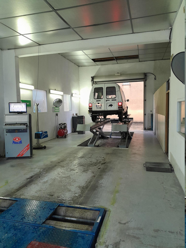

Update on progress. I got the attestation from the FFVE in a couple of weeks after application (Certificate of Authenticity), and today I took the van for its "Contrôle Technique" MOT which is necessary in order to change the log book over to Historic status. It passed no bother, albeit with a few nit picking advisoriers, but that's it now for 5 years. The application is in, and once I've got the new Carte Grise I can buy a set of silver on black number plates to complete the conversion.
This is the van during testing:
