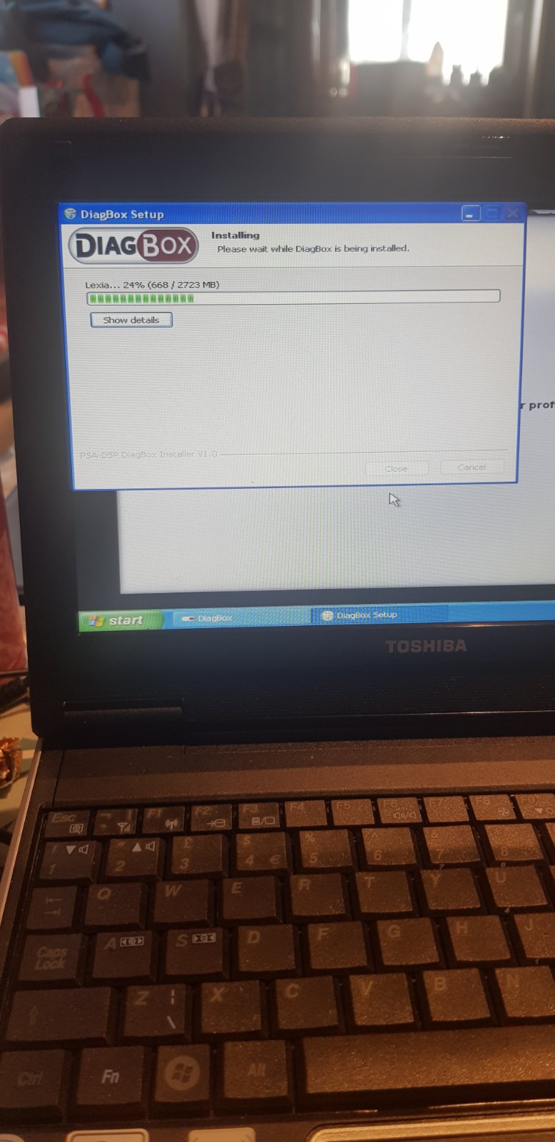

My next hurdle now...
Restart load diagbox and it does this...
A very sad...

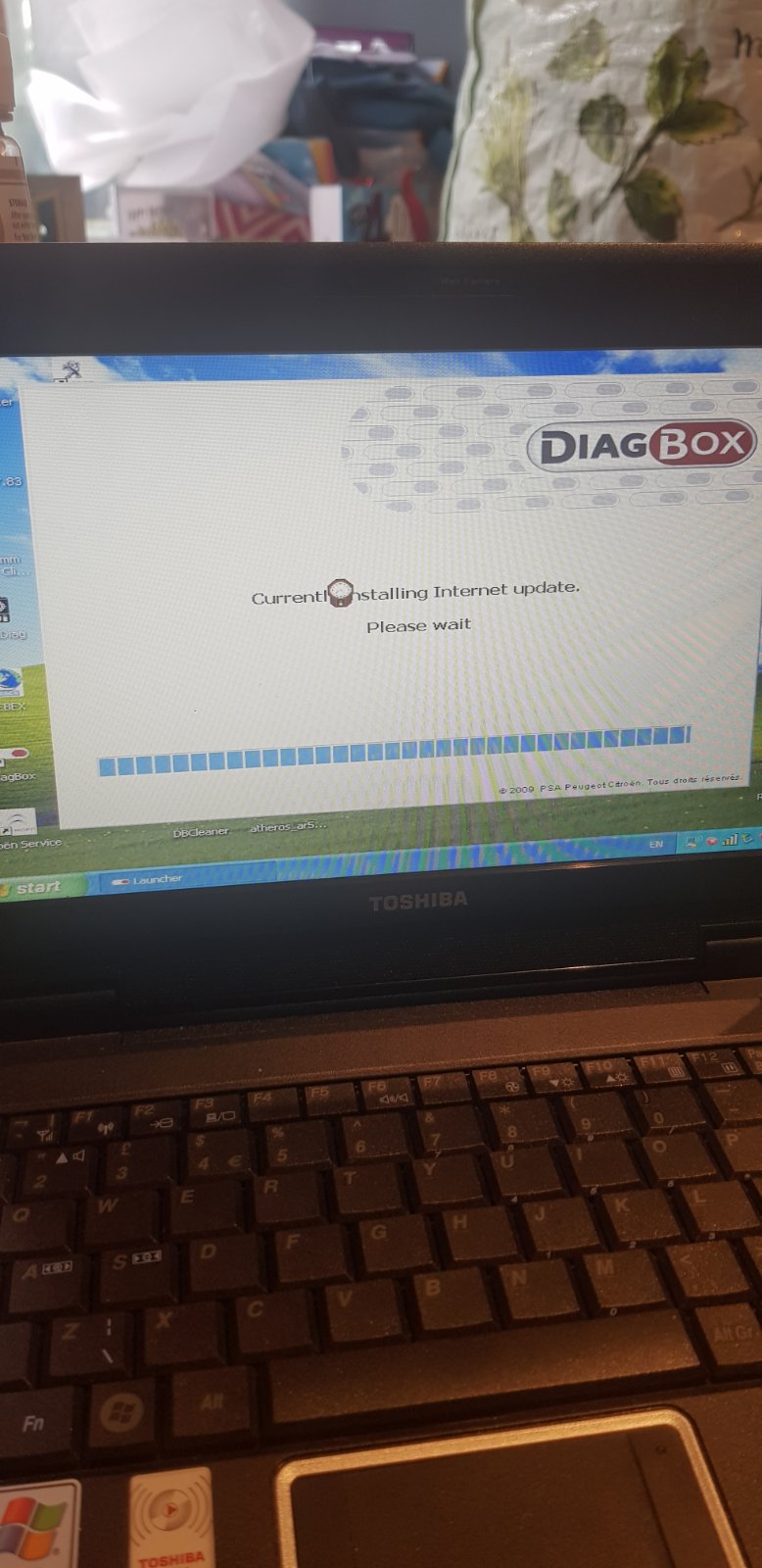

Re: Failing to install Diagbox
It's ok now..
It just took a long time lol
Next issue....
The communication card is incorrectly installed the tool mist be restarted...
Is this because I'm not physically connected to a.car..?
Next issue....

- Posts: 14276
- x 3281
Sometimes that happens. Unplug the USB cable, plug it back in, and restart that tool (you don't normally need to restart the whole application).

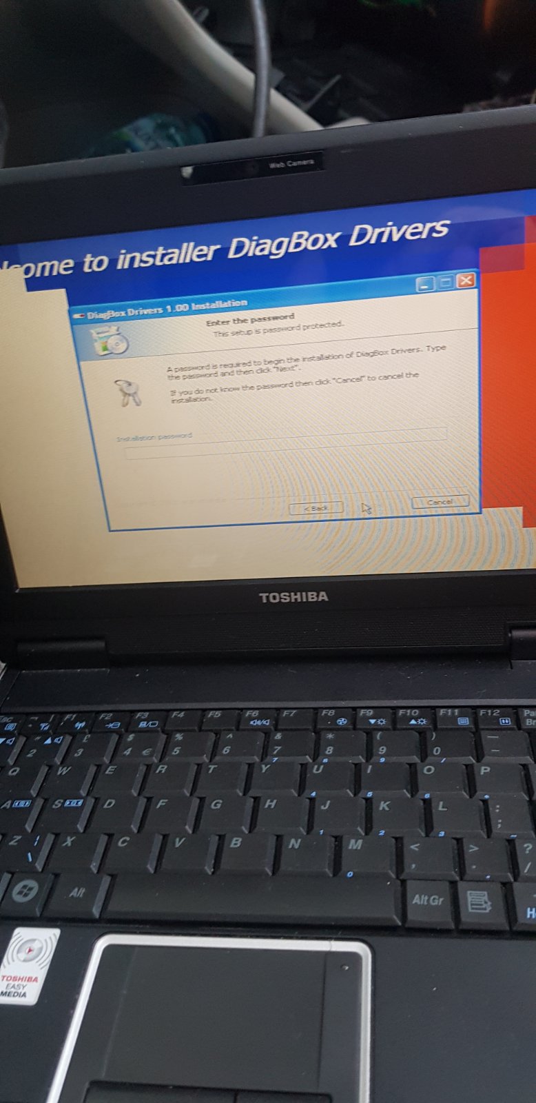

Ok new problem.. I dont have an interface driver... and when I run installer diagbox interface drivers program it wants a password...
Next... .lol
Next... .lol

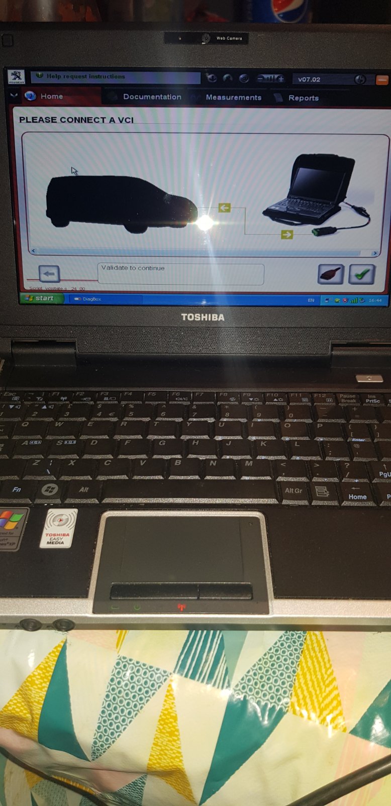

Right really getting pissed off worg this now..
This diagbox is.really complete s**t.. I hated it 10 years ago still do...
I've got the apparently latest actia driver.now installed for the interface.. I've tried all three usb ports.. windows sees it.. but pp2000 and lexia dont.. I get this in pp2000
A very sad...
1994 XM 2.1 d auto
A very sad...
1994 XM 2.1 d auto
- x 6954
Paul - that is asking for you to connect the cables from the VCI to the Diagnostic port on the car - and from here it looks like you're in the kitchen!
That screen is not Planet 2000, you are still in Diagbox. It usually only switches to the correct programme (Lexia / PP2000) for cars 2007 and earlier, when it detects the vehicle. If you are in the car and have some fancy car seat covers, then unplug the VCI, wait a bit then plug it back in. Is the green light on the VCI switched on?
