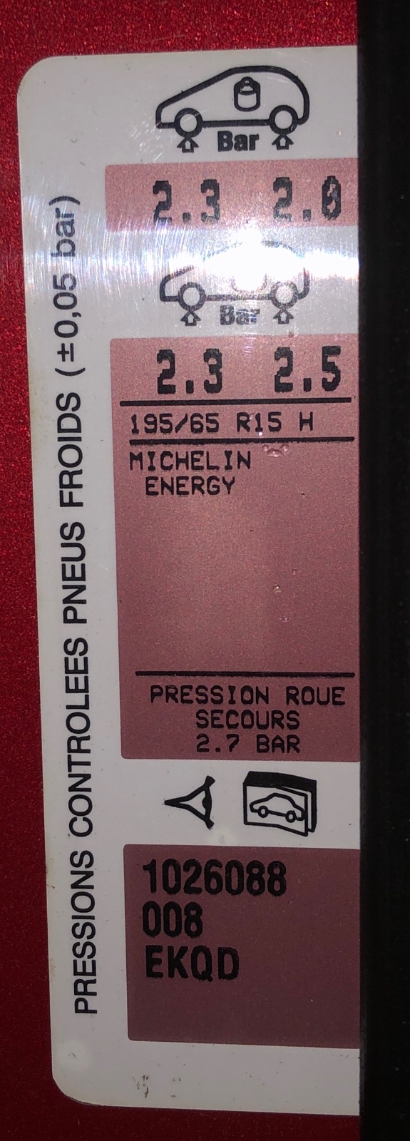

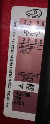

gordone
- Posts: 31
- Joined: 01 May 2019, 13:51
Re: C4 (2005) - ABS light.
I’m not sure, but I think it’s ESP button in the car, will check If the button is there.
Is it other ways to check also?
wheeler
- Posts: 7898
- Joined: 21 Sep 2002, 19:07
- x 1045
The simplest way is to check for the presence of the deactivation switch located on the switch panel above where your right knee would be (on RHD models).
Alternatively the last 8 digits of the VIN can give the info.

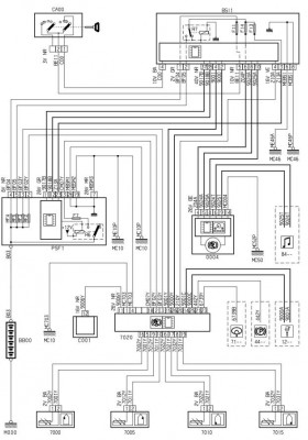

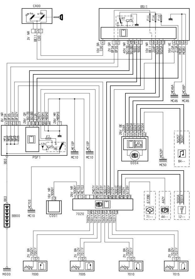

- Posts: 12499
- x 1451
Same one I found.. should be 12V on pin 18 ignition switched, fed from F7 on the underbonnet fuse box. Pins 2 and 3 should be permanent live, fed from Maxi Fuse 2 and 3 respectively - these should be beefy wires, as they are presumably the power feeds for the pump; I suspect it has backed up feeds for security. Pins 1 and 4 should be earth, 1 is probably the beefy one for the pump. Seems unlikely that both of these feeds have gone AWOL, backs up my thoughts that the pump is knackered, unless the earth on 1 is failed.

- Posts: 12499
- x 1451
There should be small numbers embossed on the plug, but they're difficult to see - the wires should be numbered every few cm, with the same numbers as on the wiring diagram, again difficult to see!
Today have I looked further into these, the pin number was quite easy to read.
Pin 18 was 12-13v against ground when the switch was on.
Pin 2 and 3 towards grond was dead....
Pin 1 and 4 against ground was 0hm....
These is maybe good news, its not nessarry that the pump is dead ?
What is the best step further now?
Thank you for your advise.
- Posts: 12499
- x 1451
You need to check the maxi fuses - these are under the under bonnet fuse box, you need to get the fuse box out to get at them. If these are blown, then check for continuity to earth down the wires - if you have a short then rewiring should fix it. If the wires are OK, then you are back to the pump.
