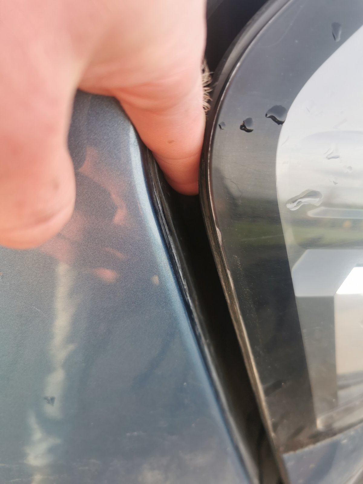

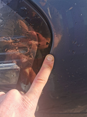

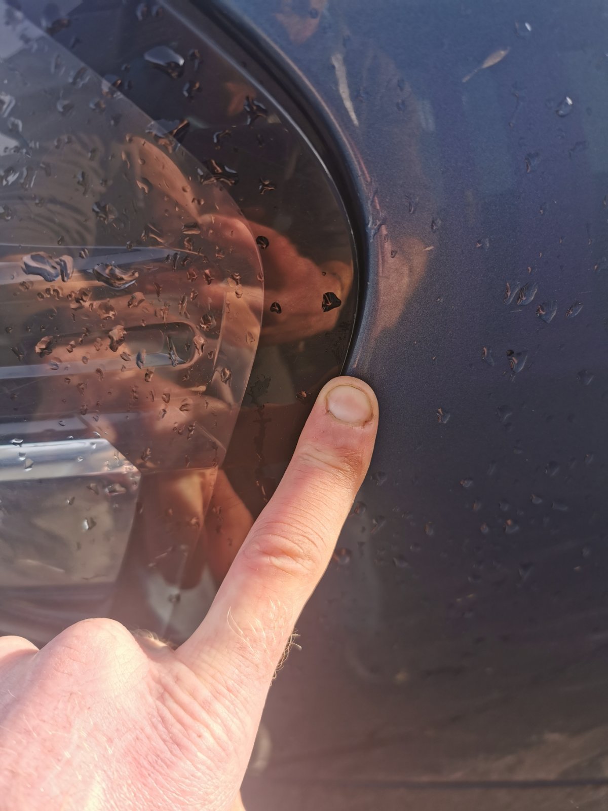

However recently the boot is only opening up about 1/3 of the way before 3 short beeps and it stops opening and wont close using the button. I have to manually lift or close the boot.
Also as per attached pictures the left hand side of the boot(passenger side with second hand strut) is not closing correctly(side with replaced electric strut) and i can put my finger in without any problems. On the other side(drivers side with original strut) the boot is tight against the chassis. #
Where are the sensors for the boot so i can check if they are blocked and not opening the boot up fully?
The second hand strut i bought and installed. Do i need to reconfigure or reset this so that its closing correctly?

There are 2 forms of obstacle detection:- direct and indirect.
On 7 seater versions, there is a seal that contains the anti pinch sensor strip - this is an upside down U shape and contained in the seal that extends from approx. where the parcel shelf is upwards. This is the direct detection on 7 seaters in addition to the indirect motors described below:
The indirect obstacle detection is determined by the motorised tailgate ECU which senses a peak in the current and stops the action. If this happens manual initialisation is required:
Initialisation of the motorised tailgate:
  • Manual opening of the motorised tailgate (If necessary)
  • Manual closing of the motorised tailgate
The struts are also balancing struts, so if they are not quite right there may be issues especially if one is more 'worn' than the other which may happen with a second hand one.

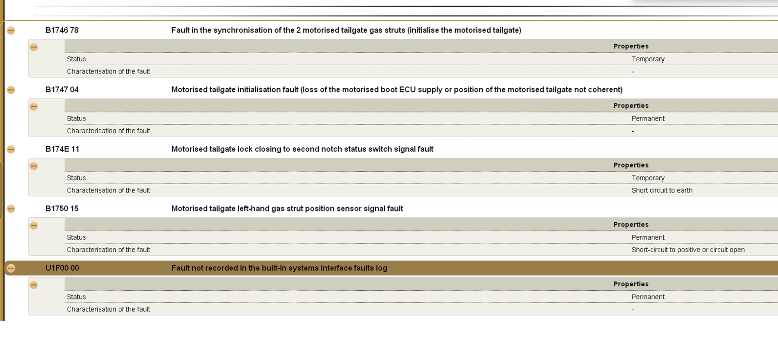

I did diagnostics I have the following errors:
(Seems attaching images doesn't work for me, or I am doing something wrong)
Do I understand correctly that the errors boil down to left strut is due for replacement, or this is just misalignment, i.e. requires recalibration?

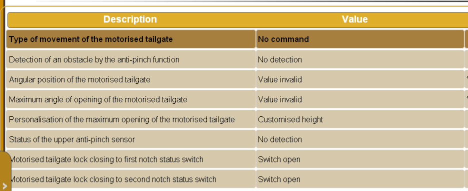

I also don't think it's the pinch sensor because I dug around some menus in DiagBox and got this:
(see first attachment)
There it seems antipinch is not triggered.
I do have a weak battery, but it was working fine on engine running... until it didn't now I open the boot and hear those three beeps of doom...
If this can be recalibrated do just go for repair and so on, and will be lead by hand in that process or do I need to actually go to a workshop with that?
I'm perfectly fine with doing stuff like that, but I don't want to mess things more than they already are...
I forgot to mention that I can open it manually but when gong down it a battle I need to go gentle with it: push it down a bit then up a bit and then more down until it's down...
