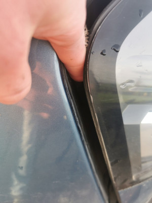

Re: 2014 C4 Grand Picasso Exclusive Boot not opening.
Hi
2014 GP
I replaced the faulty electric strut and boot was opening with no issues.
However recently the boot is only opening up about 1/3 of the way before 3 short beeps and it stops opening and wont close using the button. I have to manually lift or close the boot.
Also as per attached pictures the left hand side of the boot(passenger side with second hand strut) is not closing correctly(side with replaced electric strut) and i can put my finger in without any problems. On the other side(drivers side with original strut) the boot is tight against the chassis. #
Where are the sensors for the boot so i can check if they are blocked and not opening the boot up fully?
The second hand strut i bought and installed. Do i need to reconfigure or reset this so that its closing correctly?

- x 6950
There are 2 forms of obstacle detection:- direct and indirect.
On 7 seater versions, there is a seal that contains the anti pinch sensor strip - this is an upside down U shape and contained in the seal that extends from approx. where the parcel shelf is upwards. This is the direct detection on 7 seaters in addition to the indirect motors described below:
The indirect obstacle detection is determined by the motorised tailgate ECU which senses a peak in the current and stops the action. If this happens manual initialisation is required:
Initialisation of the motorised tailgate:
