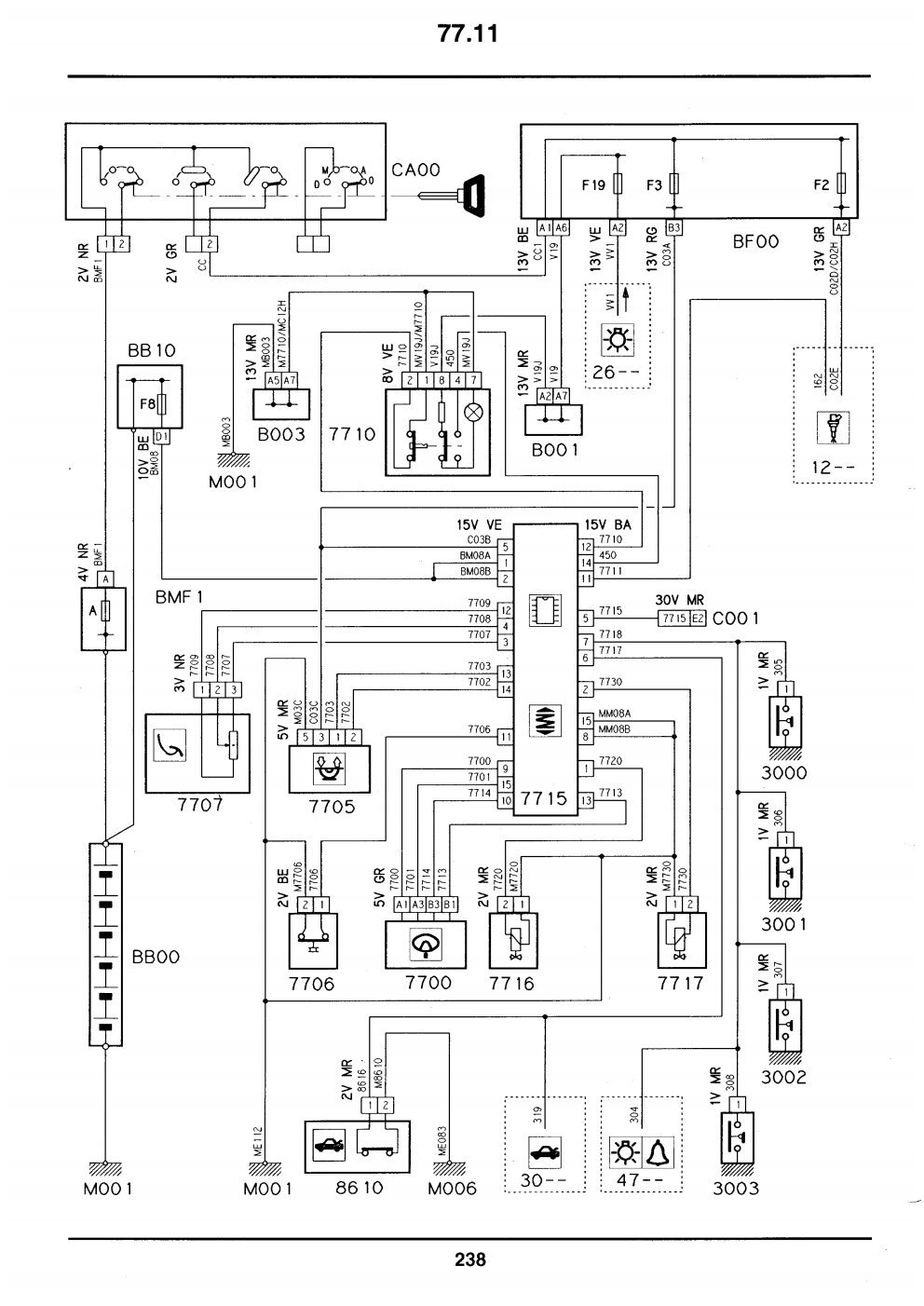

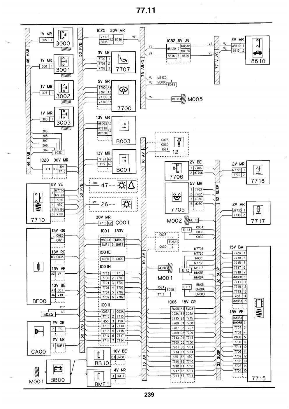

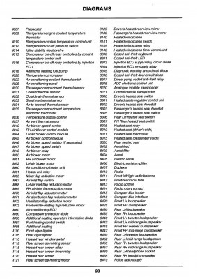

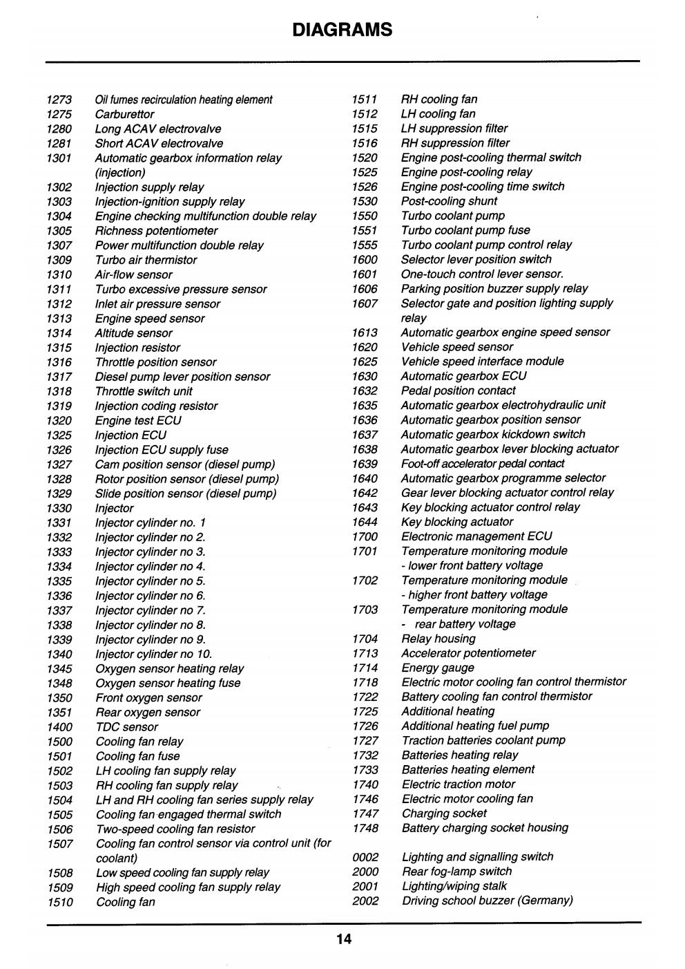

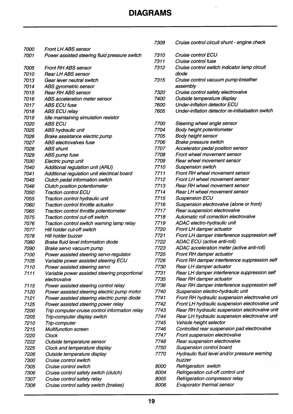

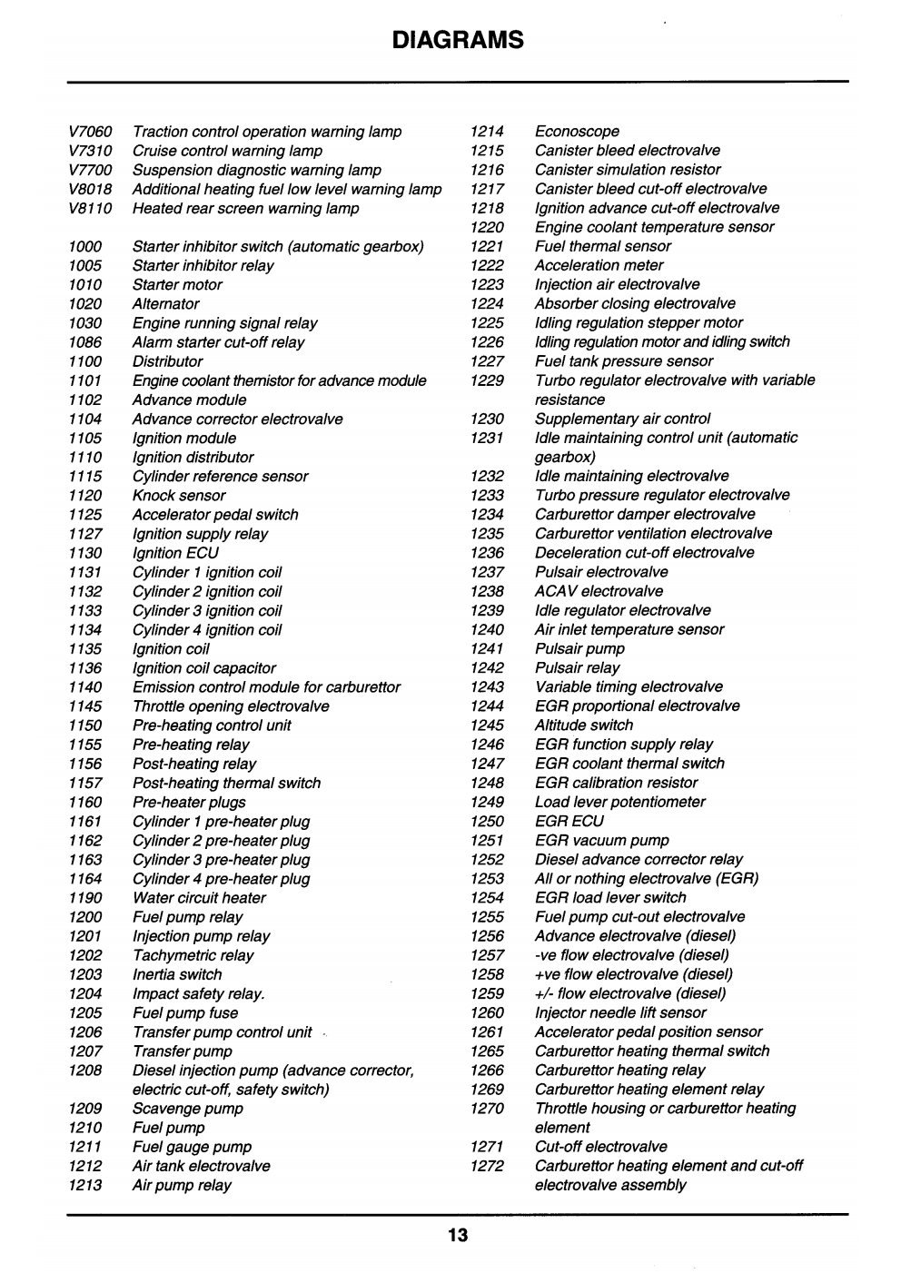

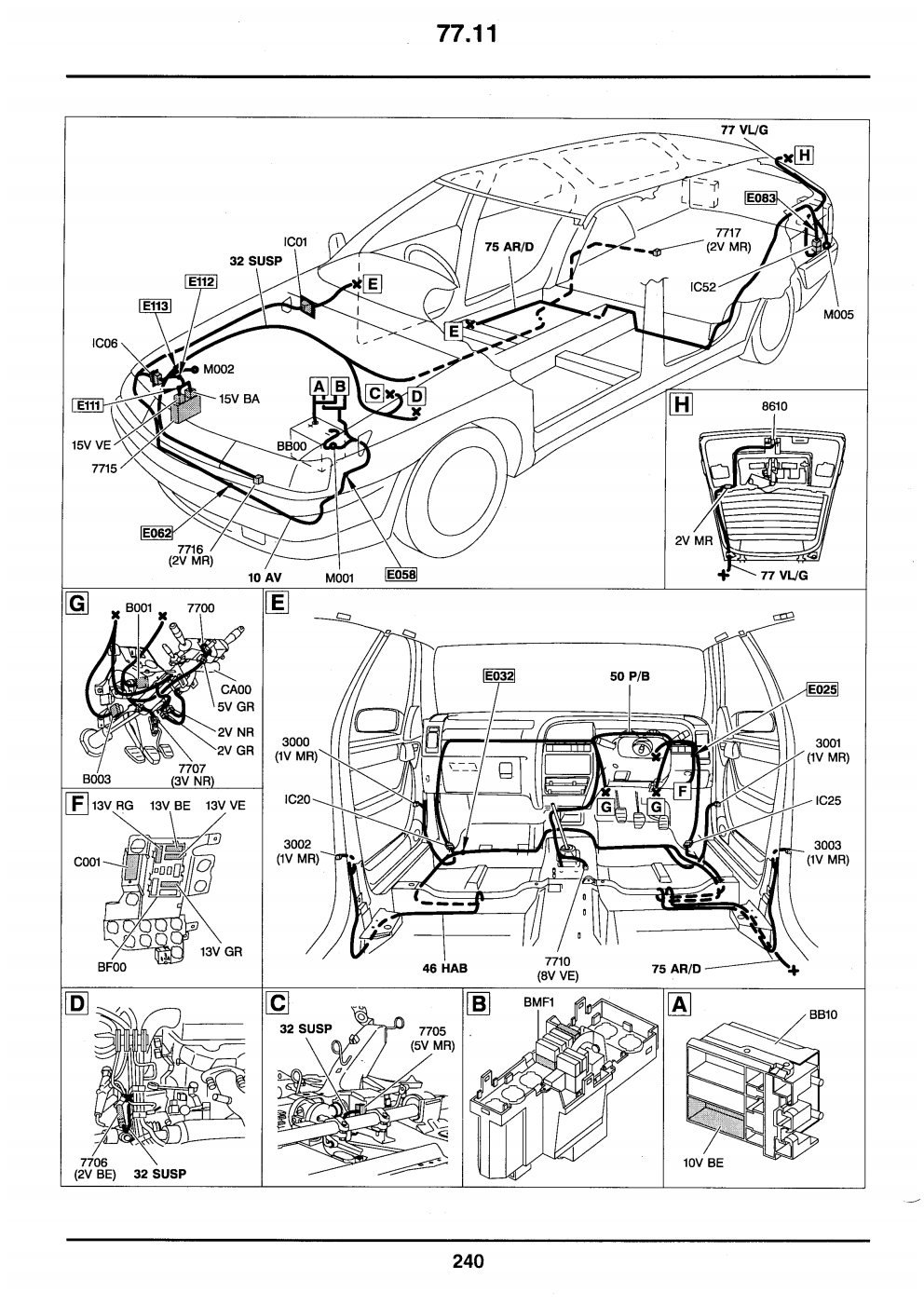

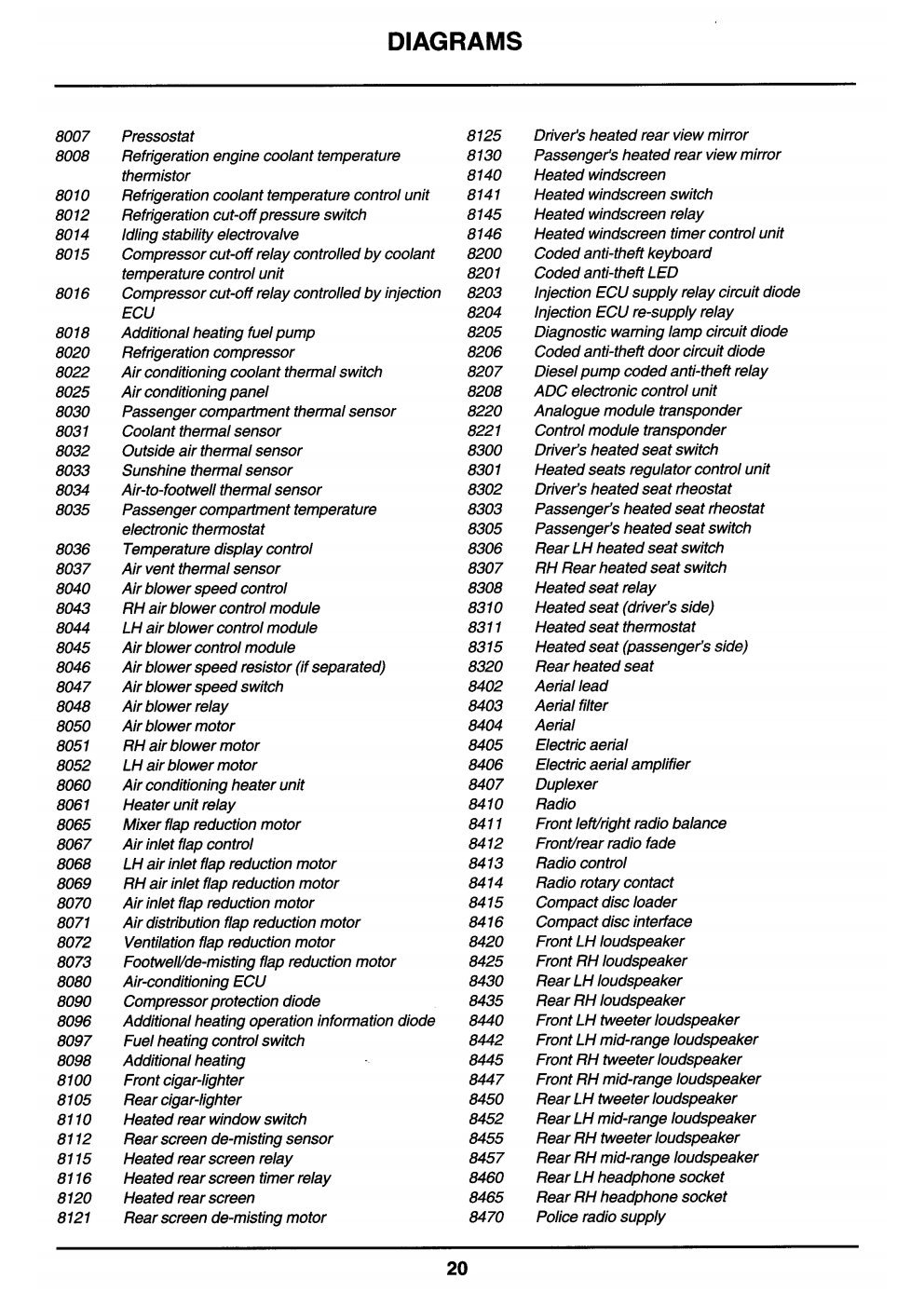

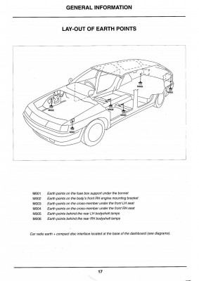

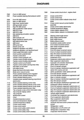

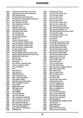

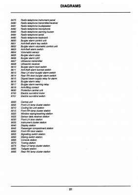

Re: Xantia MK1 2.1 estate 1998 - solid suspension
Hi Martin,
Herewith electrical pages for Estate, MY1998, RP7483--> (yours is 7493), XUD11BTE
including grounding points and component codes
? click to enlarge
Check fuses for ECU supply, obviously.
Any warning light showing on the dash?
Worth checking the black and white 15-way connectors at the ECU for clean contacts.
After that, next step is to check whether each EV is receiving a supply from the suspension ECU.
Best done by unplugging each EV, and connecting in its place a 12v 1W or 2W small bulb (not bigger).
The lamp should show bright (12v) for 0.5sec, followed by dim (3v approx).
d.c. resistance of the EVs is listed as approx 4.8ohm
current for the 12v pull-in is approx 3A
current for the 3v (PWM) hold-in is approx 0.5A
