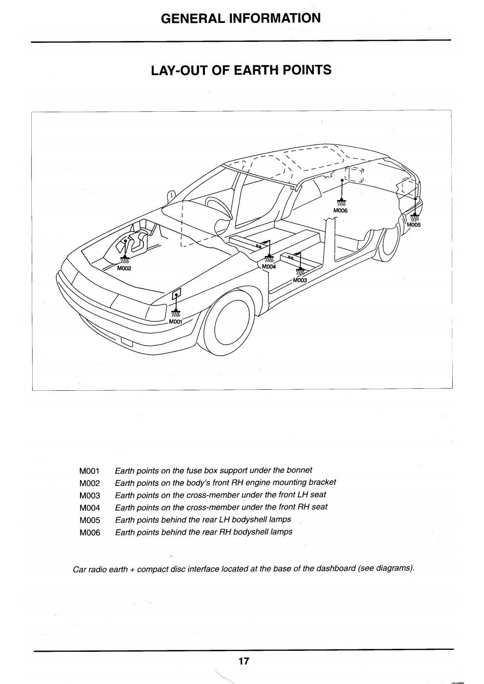

Hi Martin,
Herewith electrical pages for Estate, MY1998, RP7483--> (yours is 7493), XUD11BTE
including grounding points and component codes
click to enlarge

Check fuses for ECU supply, obviously.
