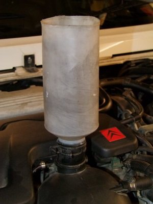

Air-locks in the heater matrix (and worse, the cylinder head) are not unknown, and it helps to use a temporary "header bottle" to force air out of the system after refilling it.
Any 1L bottle will do, bottom cut off, and a short length of old hose, with a snug fit into the car's header tank, so it blocks off the overflow hole. Keep the bottle at least half-full of coolant as the engine gets up to full working temperature, indicated by the fans cutting in at least twice. The additional head of coolant encourages air out of the system, and out of the bleed screws. It also allows you to easily see when air has stopped coming out of the system. Leave in place while the engine cools.

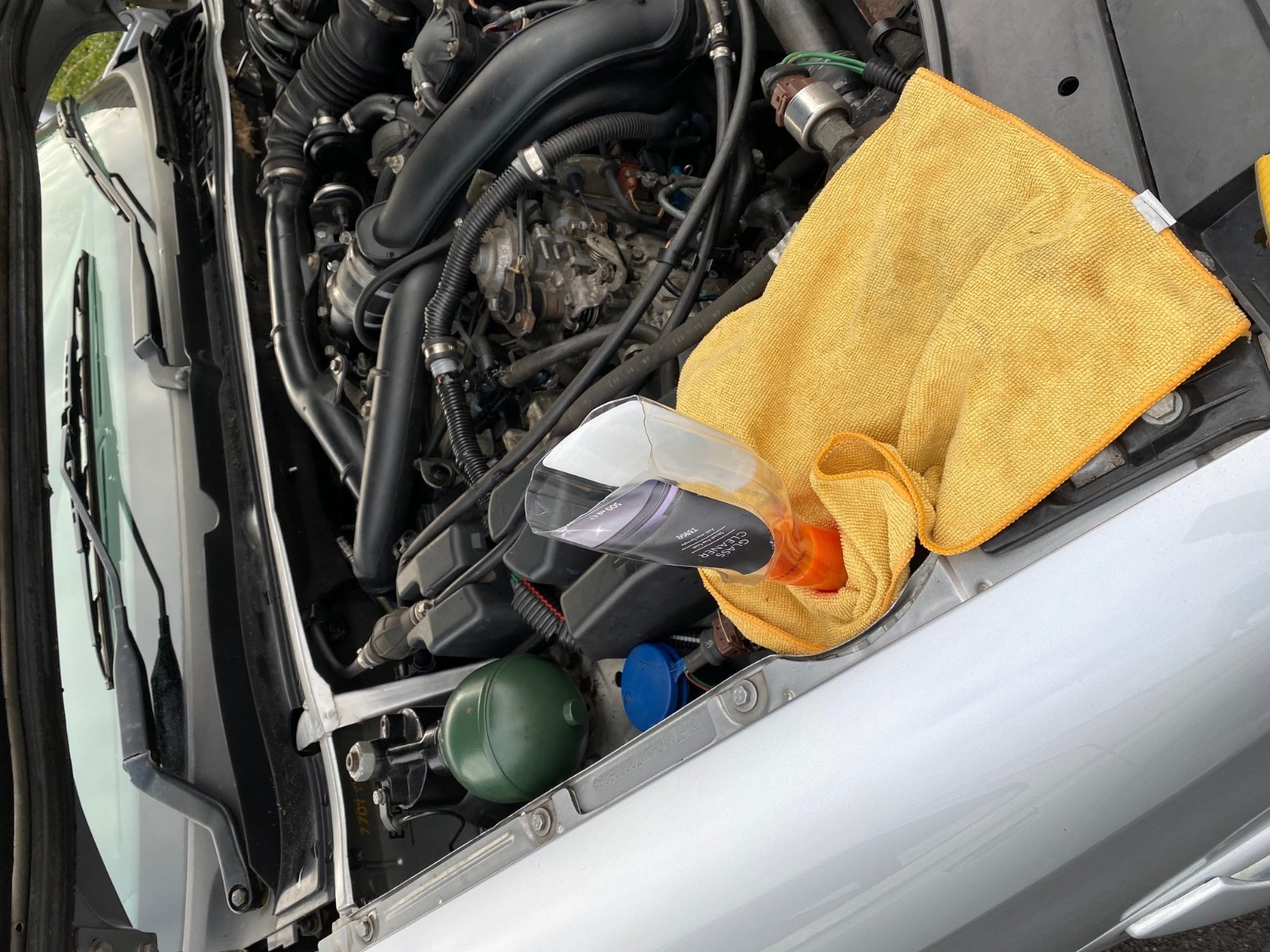

white exec wrote: 08 Nov 2020, 16:49 Result! Good news.
thank you very much! Worked a treat, no airlocks now :-)
