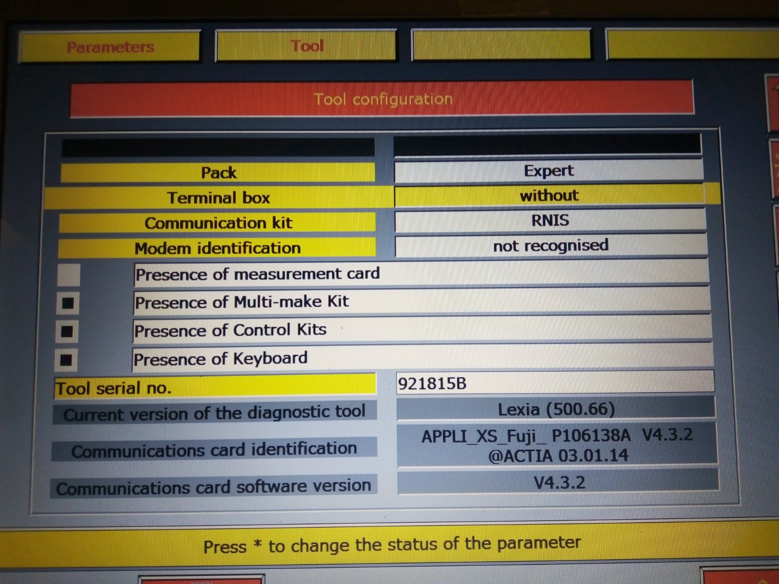

can't communicate with measure card..
(I'm not sure if I have one it says yes on one list and no on another)
and says it cannot communicate with a card in the cable.
and the cable configurations don't match.
when I close the DB program there's an actia pop up which says "internal communication error."

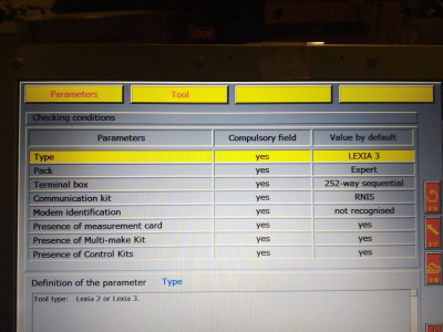

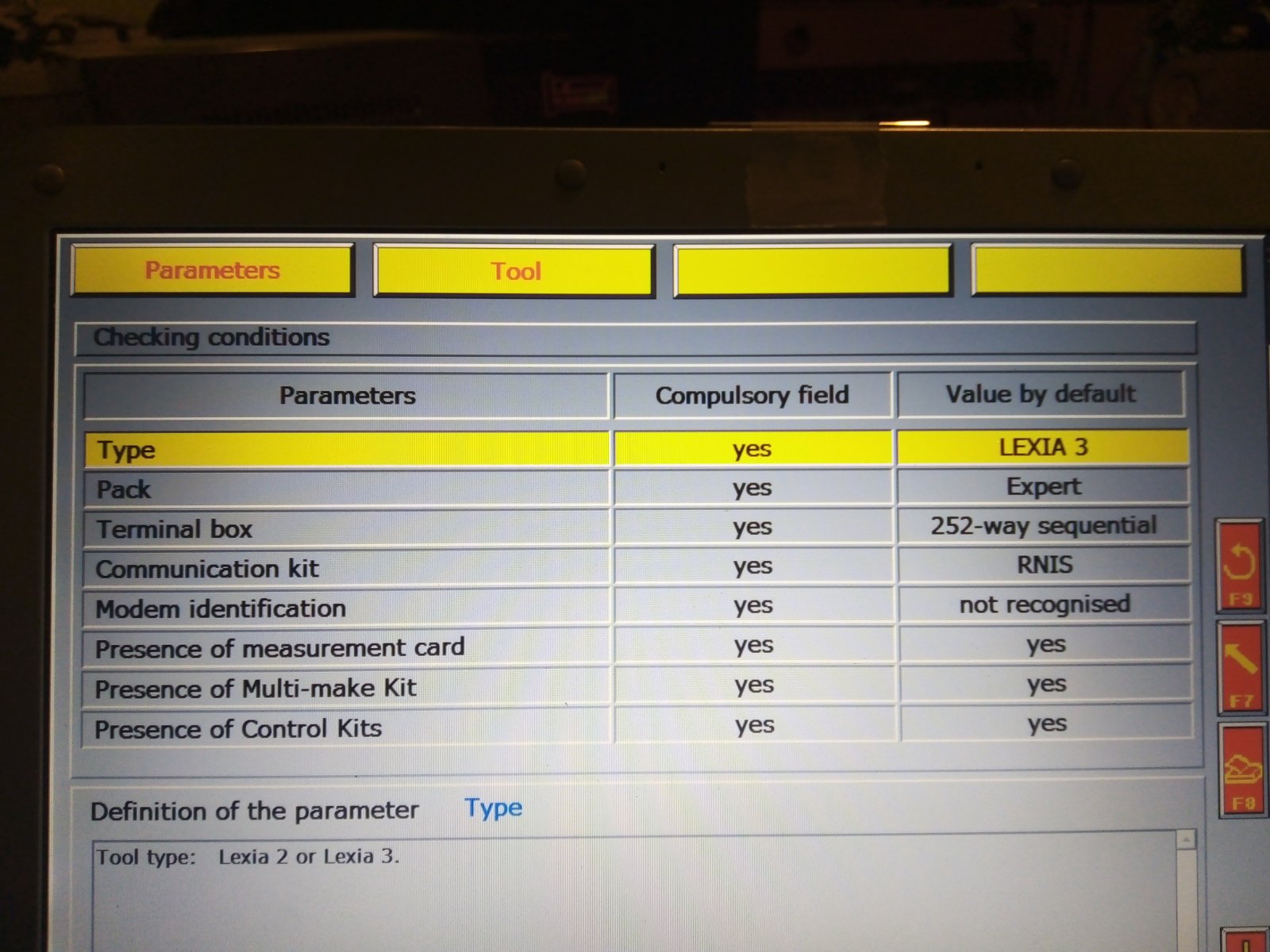

Q* so, first would anyone know how to identify my cable?
(see pics for software)
9780.Z5
the sticker says:
PSA XS EVOLUTION
(barcode)
921815B/40W07/0005451
with QC3AC842-078 printed on it's rubber cable bung.
Q* I think I need to enter my serial number, which would this be?
Q* do some cables have trouble with certain versions of DB?
