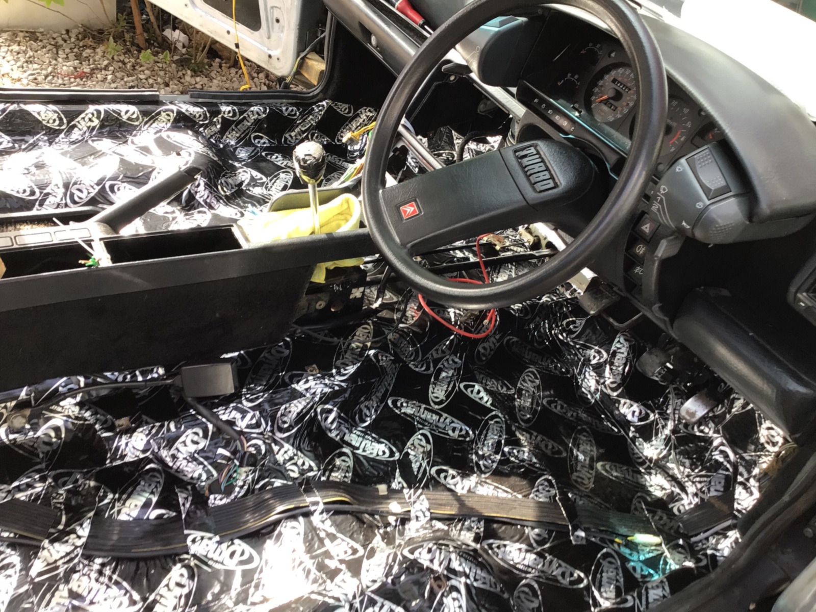

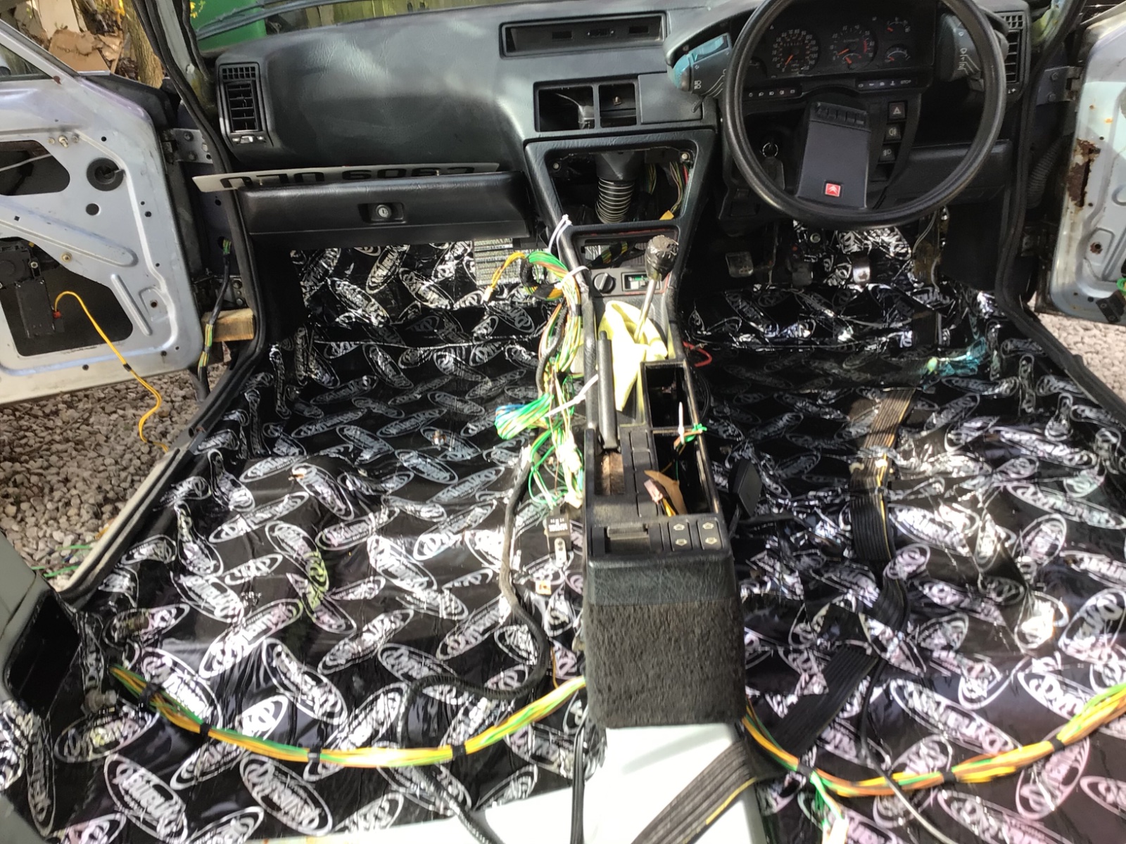

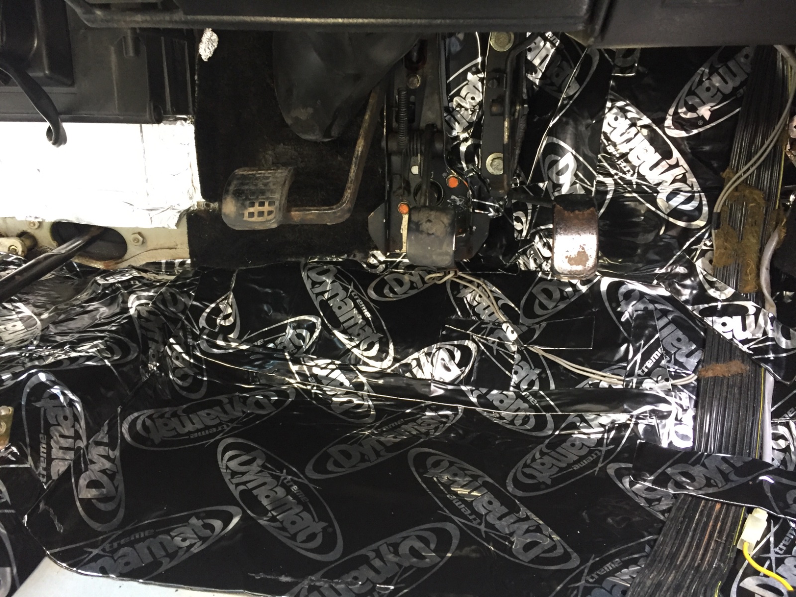

Several hours and sore hands later, and most of the floorpan and fiddly bits are now Dyno-matted.....
I’m determined this car will be quiet!

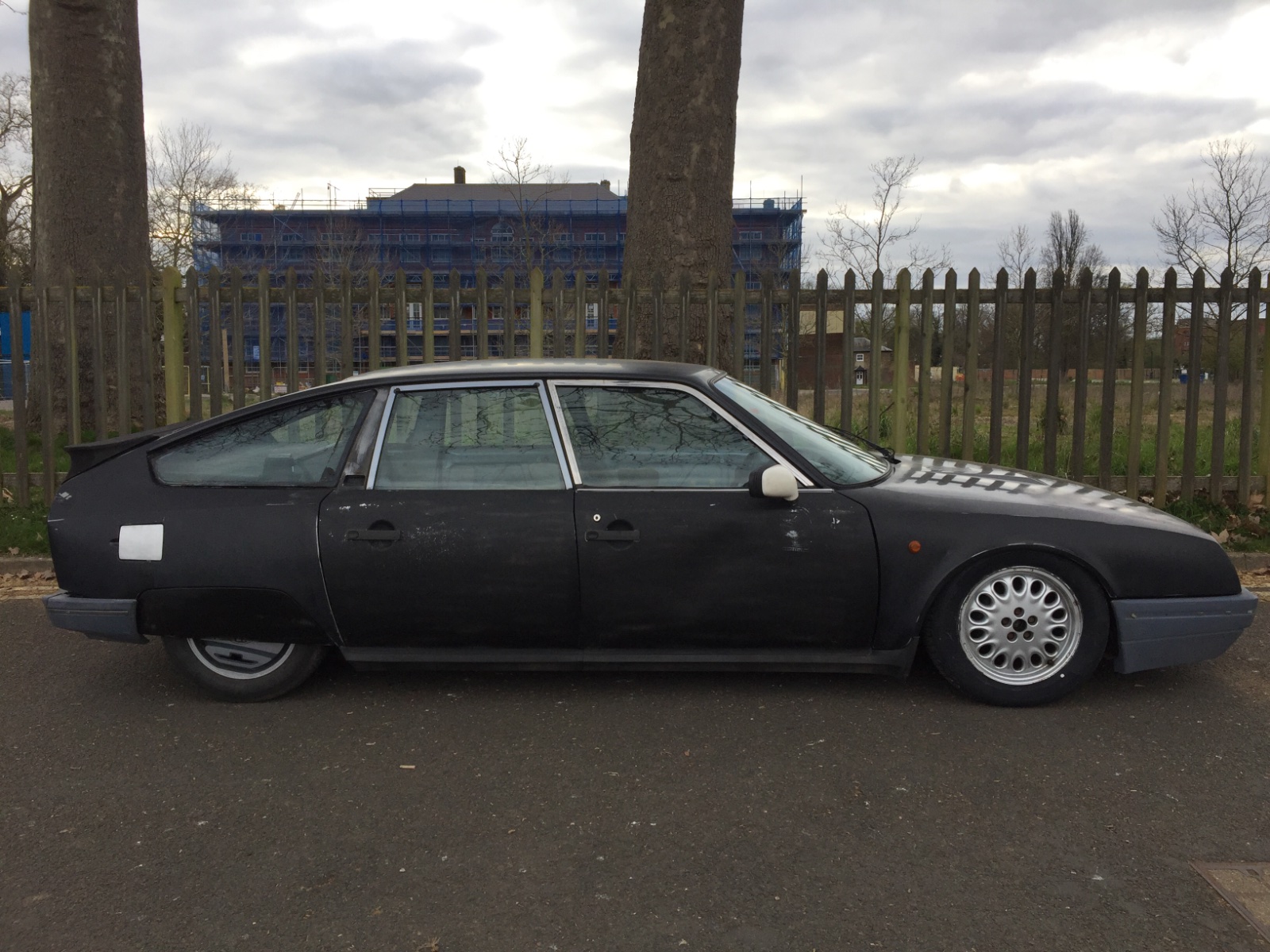

Massive day for my project yesterday. MOT PASSED!!!!!

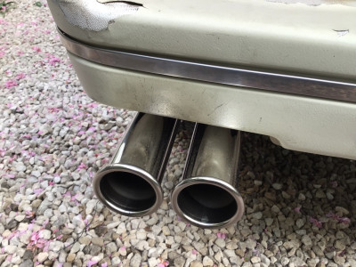

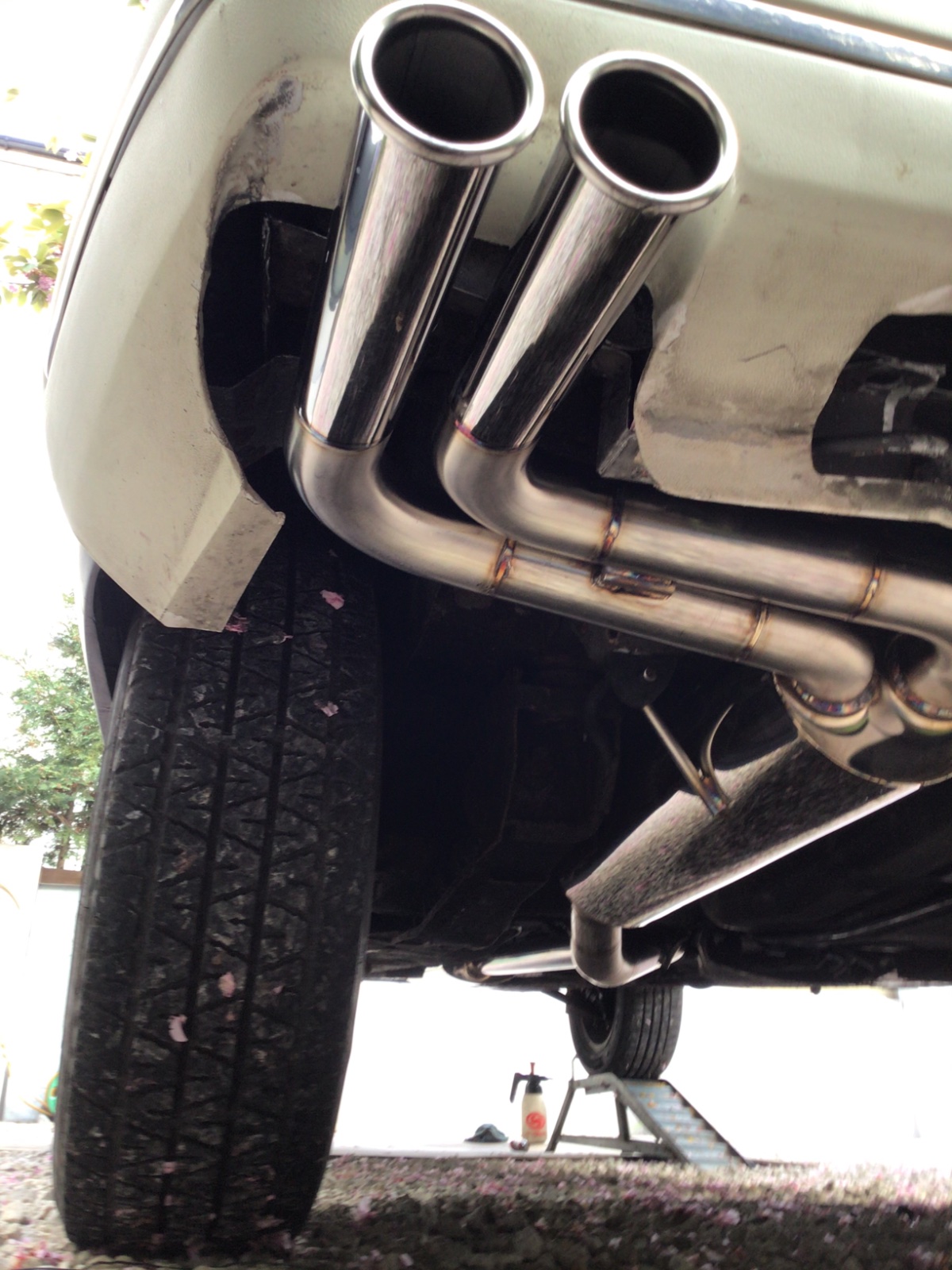

This is just beautiful and has made another transformation to the car........
- x 1751
Bilkob
- Posts: 169
- Joined: 23 Feb 2017, 19:16
- x 47
Re: GTI T2 ‘restobuild/mod’.....
Small company in High Wycombe- ‘Style-Dynamics’. They usually do ‘hot’ VWs and Audis etc but they’re real craftsmen, understood exactly what I wanted (not loud!) and have done a superb job.
