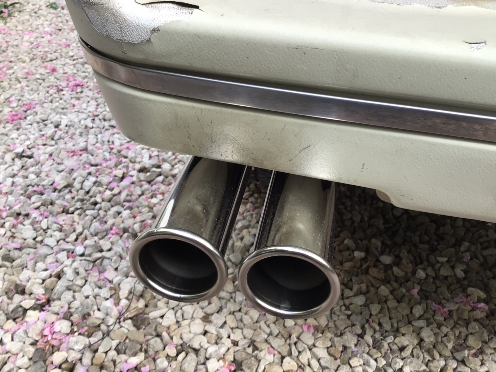

This is just beautiful and has made another transformation to the car........

Small company in High Wycombe- ‘Style-Dynamics’. They usually do ‘hot’ VWs and Audis etc but they’re real craftsmen, understood exactly what I wanted (not loud!) and have done a superb job.

That looks fantastic!
