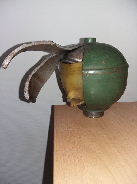

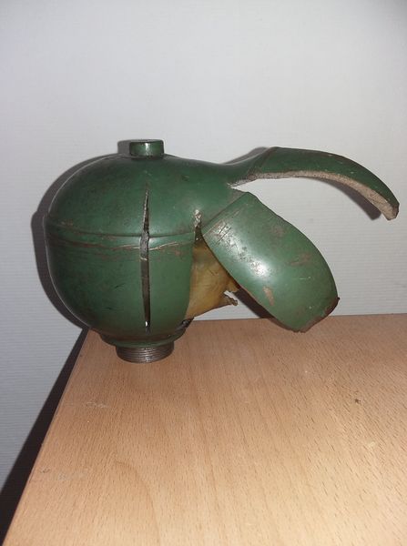

Another failure when the pressure regulator doesn't stop.......... (by the way this is a stocksphere)

Re: Spheres and failure modes
Truly alarming. Have never seen such a thing before.
Wonder if that sphere had had cold-chisel treatment (to loosen it) previously?
My guess is that the diaphragm would never reach saucer sphere spikes in a sphere with anything approaching normal gas pressure, however much system pressure was applied - and would, in any case, not prevent hydraulic pressure building up in the sphere. I think the spikes are there for other reasons.

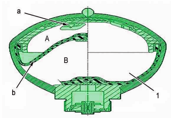

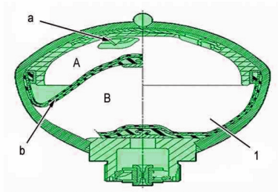

They are there so that in the event of bursting through overpressure, the pre-form prevents projections of metal pieces.
The pre-form can be seen at 'a'

Still not sure how a ruptured (spiked) diaphragm would prevent metal casing splitting as a result of over-pressure, even if completely lined with plastic or another material.
Is there a history of split spheres? Why haven't we heard of this before?

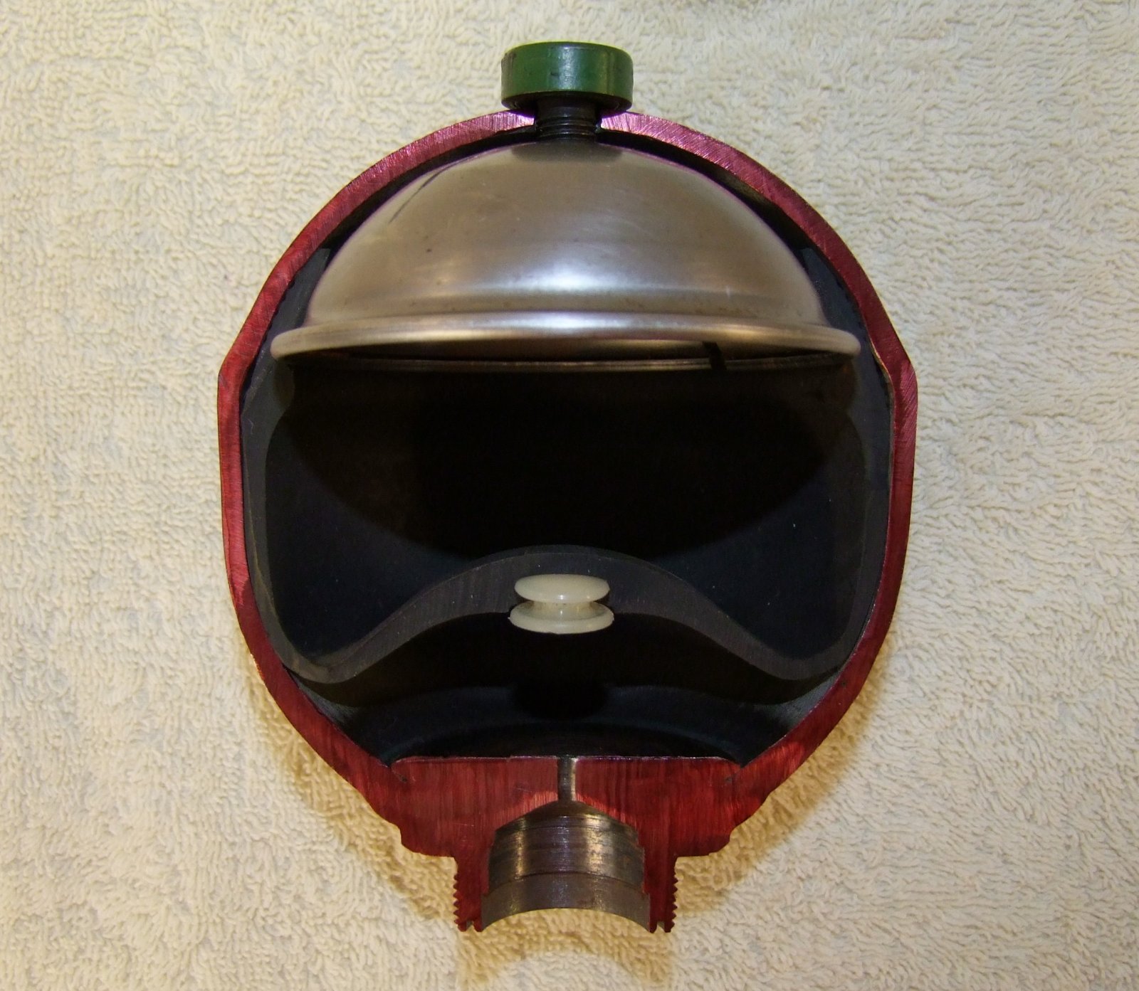

A pukka Citroen sphere here, which I cut in half a few years ago, has a wall thickness of 3.5mm (minimum) over most of its area, and 5-6mm near the neck/base.

Perhaps the burst sphere had been cold chiselled off (though no obvious marks), but more likely in this case, the weld was faulty and it tore away there.

Looking again at the photos above, it does look as if the base weld has given way, which would then allow the sides to 'peel away'. Some years back there were comments on Club-XM about the base weld on some spheres being of varying smoothness (quality?), causing difficulty in screwing spheres down completely, metal-to-metal, on to the machined surfaces.
It certainly does look as if it has failed round the base. It is interesting how straight the failure tears are, but that might be a result of the manufacturing process which presumably consists of serious cold forming.
The weld would probably still be the weakest point, as it would be difficult to get full penetration working only from one side.
T

Have just noticed that the weld at the base, and the way the shell joins the base-plug (threaded part/damper insert), looks completely non-standard, and nothing like Citroen's own spheres.
The squared-off (turned) shell edge is clearly visible and free from weld.
Will try to post a comparison photo tomorrow.
