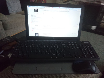

New wireless keyboard and mouse installed to overcome the intermittant space bar on the new laptop and now I have the bonus of the scroll wheel on the mouse which is so much better than the touch pad for working on forums and list type software. Well chuffed with entire upgrade for less than £250

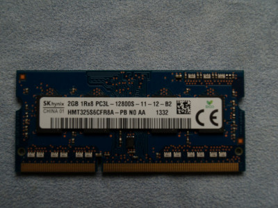

What I really wanted was more RAM for my laptop and a hard drive caddy. Bugger.

I have about a dozen, all the wrong type.

What is the make and specific model of the laptop? I may (through work, if nothing else) be able to find out what type of memory cards it will support.

Hi Steve, I have just done an ebay search, and here are the results. The largest cost seems to be that of shipping;
https://www.ebay.co.uk/sch/i.html?_from ... S&_sacat=0
If your system is 32bit it can only manage up to 4GB (and that includes the Video RAM). Anything more than that will not be seen, and may even cause the laptop to not boot up (as it cannot address the memory properly).

That's a disappointment James as it already has 4 gig.
It runs Linux Mint 64 bit fine too.
It's a Dell Latitude E5530.
Being terminally stingy I don't want to spend more than essential but don't want to buy 8 gig and find it isn't enough.
I was dithering about trying to decide on 8 gig (£37) or 16 gig (£75)Handle 0x004B, DMI type 17, 34 bytes
Memory Device
Array Handle: 0x0048
Error Information Handle: Not Provided
Total Width: 64 bits
Data Width: 64 bits
Form Factor: SODIMM
Set: None
Locator: Bottom Slot
Bank Locator: Not Specified
Type: DDR3
Type Detail: Synchronous
Speed: 1600 MT/s
Manufacturer: Hynix/Hyundai
Serial Number: 0058A469
Asset Tag: 9876543210
Part Number: HMT325S6CFR8A-PB
Rank: 1
Configured Clock Speed: 1600 MT/s
