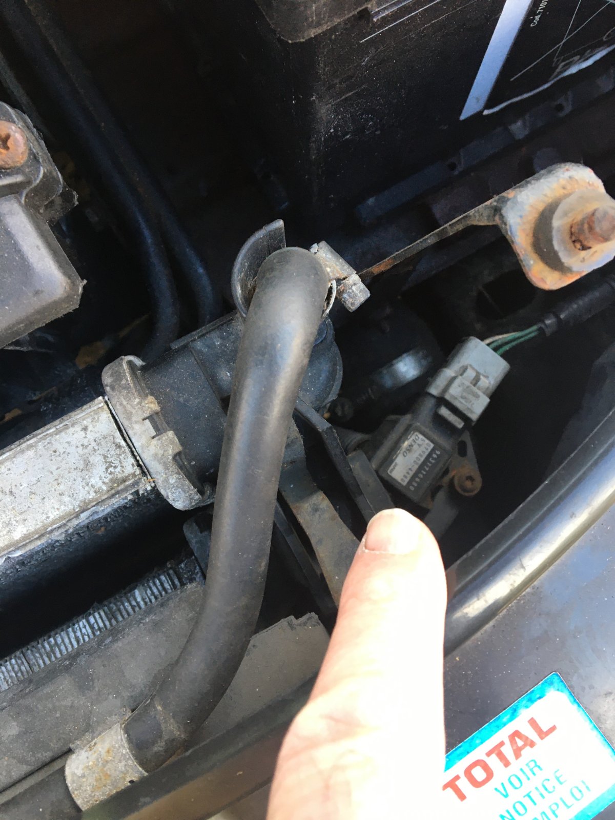

For the induction pressure sensor fault to be registered, (P0234) Major Fault, you need a difference of 200mb at idle between the inlet pressure sensor and the atmospheric pressure sensor and you would receive "inlet pressure sensor coherence" message. Although you are not currently receiving such a fault, you will see 900mb for the atmospheric pressure in Lexia if it is not operational and this would also cause emergency mode. Interestingly, it is all part of the linked wiring.
It's a 3 pin connection. Ignition On. 4.8 - 5.15V betweeb Pins 1 and 2.
At 1 bar (1000mb) you should see 2.3V between Pins 2 and 3 on this component increasing as the pressure increases.
