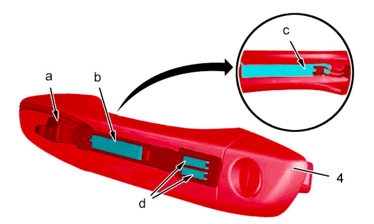

There's nothing to see to be honest as there are 2 sensors - locking and unlocking, so it's likely the unlocking one is malfunctioning - but, I strongly suggest you clean behind the door handle with some mild detergent or car wash solution with a microfibre cloth, as a film can build up that can prevent detection of the unlocking sensor.
I don't have any diagrams, but if faulty it's generally the whole handle that needs replacing, or live with the fob only locking / unlocking.
This is a typical handle and the sensor in question for unlocking is shown at 'C'
