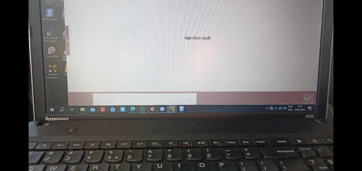

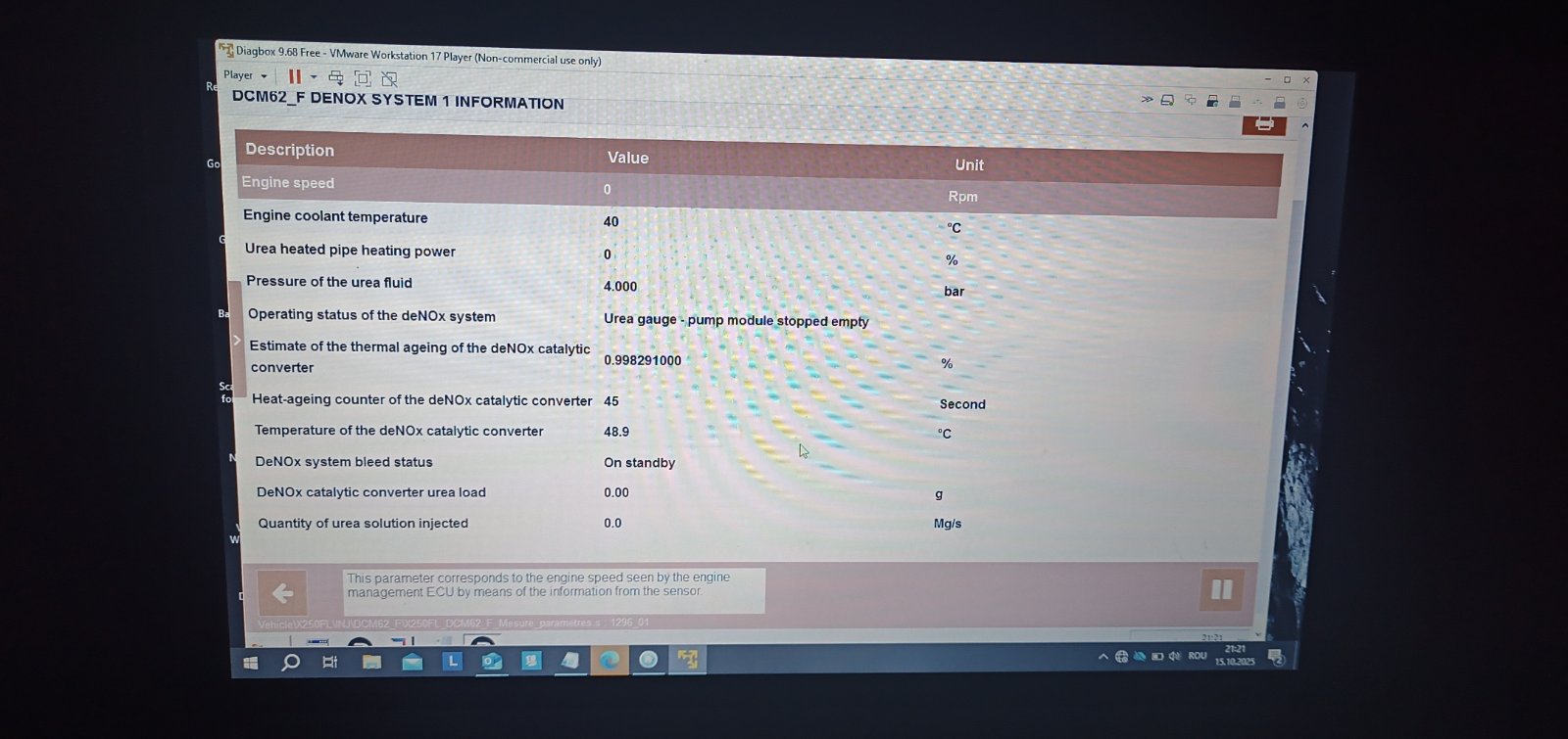

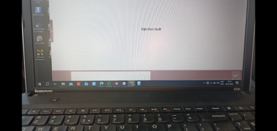

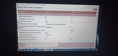

Hi, seems difficult to find more informations about diagnosing these tanks, beside one topic on this forum and little info that I found on some polish forums. Everybody wants to get rid of this system because of poor designs. I asked this question on that topic but I will continue here with my findings.
On the DiagBox both heater tests are failing (pipe heating and tank heating) and I hear no pump noise with ignition ON. My feeling is that I have a defective tank rather than a bad pressure sensor, but I haven't take the tank down to measure the heating elements and the NTC (the procedures are on the Elektroda forum). Does anybody has these problems with the heaters - or these tests are both failing from other causes?
The status of the Denox system is "Urea gauge-pump module stopped empty" - but for sure there are more than 6 litres of liquid in the tank (only water - for cleaning/testing).

Regarding my last post above, I just read on Elektroda forum that the "status of the Denox system" does not take into account the level of urea in the reservoir but it has the following meaning: it is "empty" if the tank was not pressurized when the ignition/power was turned off, and it changes to "full" if the tank was at operating pressure when the ignition/power was turned off.

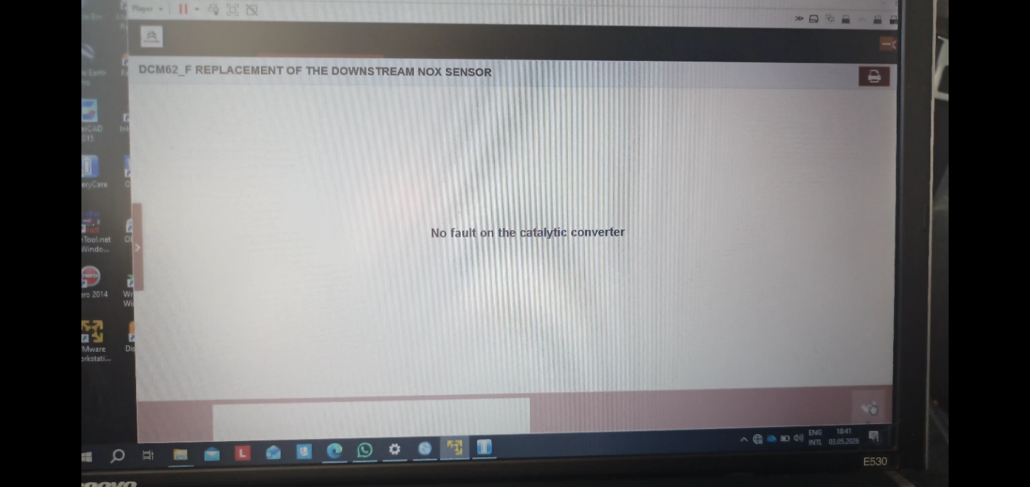

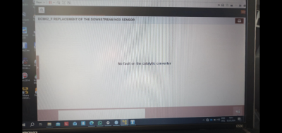

Today I took my Lexia interface and with Diagbox 9.68 free I start the procedure for learning a NOx sensor (It is not changed again, but it has under 1000Km). First, you have to warm the engine above 80 degrees. Then you have to have patience for about 25 minutes. The procedure completes but it's giving me a message that indicates some errors at injection.
A new injector probably is also needed, this one has many years. When I replaced the DPF and restore AdBlue operation it was checked and cleaned well but who knows, maybe still have signs of wear.
I think it is not the SCR catalytic converter to blame. The final message of the test gives me some hope.

No new NOx errors after a 500Km trip, so repeating the learning procedure might calibrated the sensor well this time. Finger crossed.
