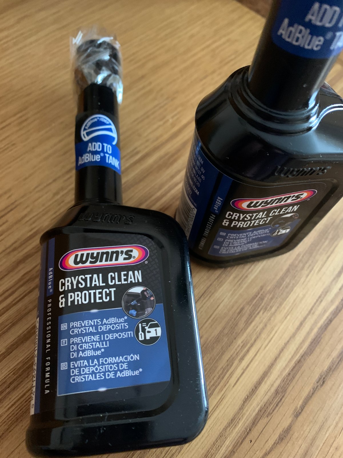

Also, suggestion is to fill the adblue reservoir to to cap/rim and to use adblue additives against crystallization.

Yes that's good advice as far as using an Adblue Cleaning and anti Crystallisation additive. I've just put some in and filled my tank using this Wynn's:
The next 10 litre container of Adblue I buy, I will just put in a bottle of the Wynn's directly into it and then it's already in the mixture when I top the tank up every 2 months. Forte also do an Adblue additive.
These can keep the Adblue injector free of crystal build up too it is claimed.
