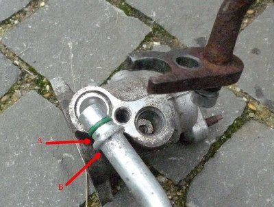

The design of the 'embossed' ring that is incorporated into the pipe fitment means that the pipes are really only good for single fitment. That ring crushes up against a seat in the pinion housing when the pipe is bolted into position. You might be able to get a satisfactory re-use of the pipe(s) if you could find a way of putting a shim in between the 'embossed' ring and the yoke that clamps the pipe into position, but that shim would have to be sub-1mm thinckness to be workable. Another method would be to shave 0.5mm off the face of the pinion housing where the pipes enter, but to do that satisfactorily you'd need the housing on a bench.
Edited in details from a previous posting I made here:
viewtopic.php?p=590623#p590623
The two options I was playing with was either to fit a ~0.5mm LDS proof ring seal around the pipe at point 'A' where the flange sits on its seat, or to use a ~0.5mm packing piece at point 'B' to enanble the flange to press fully home into its seat. Any more than 0.5mm would probably throw out the how the steel HP pipe seats in its recess.

With reference to my photo above - if you could find / make a wafer thin shim that'd sit on the stepped portion of the the pipe hole in the pinion casting, then that would mean you could re-use the old pipe as-is as there'd be a new surface for the ring to crush onto. You'd have to put an identical thickness shim onto the steps in both holes due to the way the pipes clamp into position. I have a pinion casting sitting here in front of me in case you feel the need to get creative and want to go into shim manufacture and need some measurements !

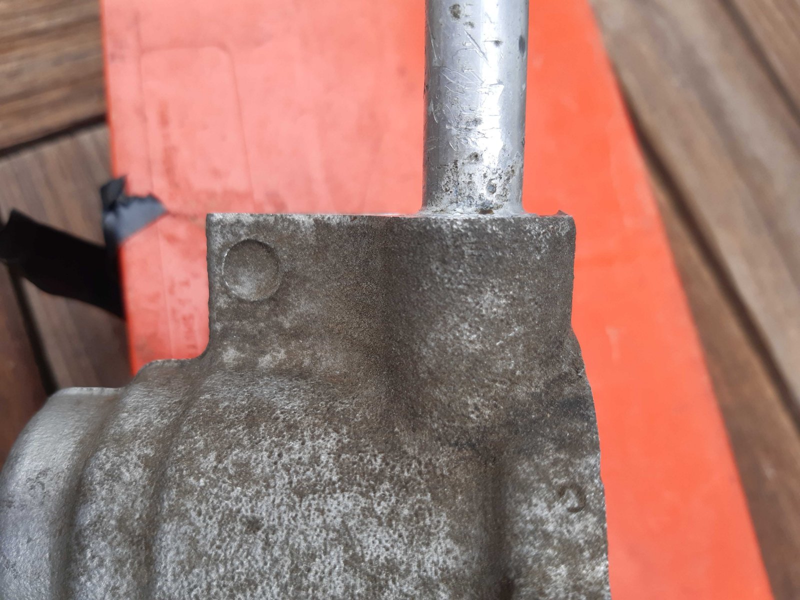

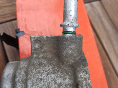

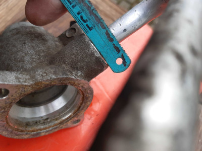

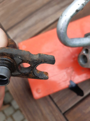

I've just been out to The Shed Of Delights™ to find my old PS pipes. See photos....
How the pipe fits into the pinion housing: Pipe fully home: How far ring protrudes from housing i.e. not very far ! : Yoke that holds PS pipe in place. Note there's a chamfer on the yoke which means even less of a positive fit on the ring: The fitting of the yoke over the silver PS pipe is sufficiently slack to allow the silver pipe to move off alignment in its socket in the pinion housing. The silver pipe is not even close to being a tight fit in tis socket.
