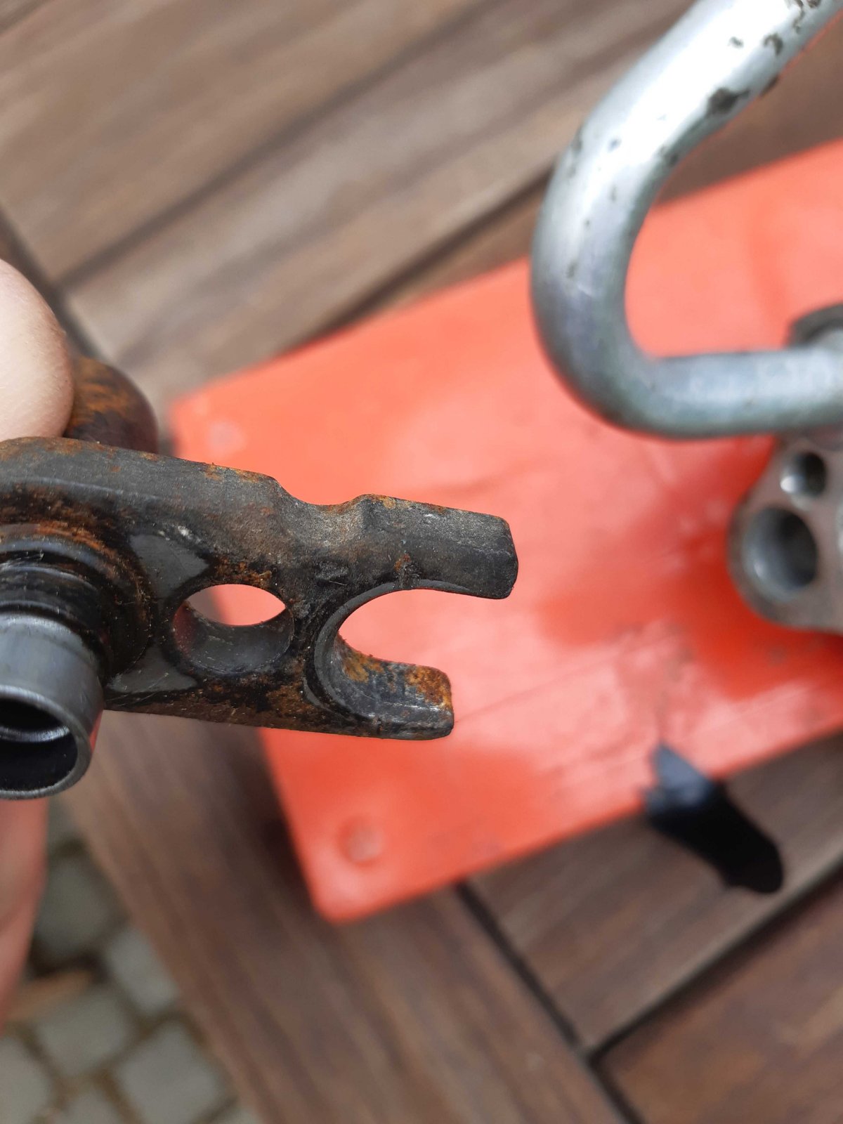

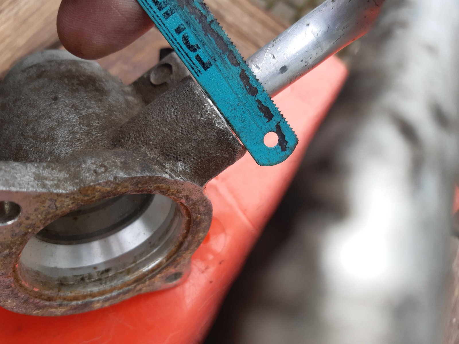

I've just been out to The Shed Of Delights™ to find my old PS pipes. See photos....
How the pipe fits into the pinion housing: Pipe fully home: How far ring protrudes from housing i.e. not very far ! : Yoke that holds PS pipe in place. Note there's a chamfer on the yoke which means even less of a positive fit on the ring: The fitting of the yoke over the silver PS pipe is sufficiently slack to allow the silver pipe to move off alignment in its socket in the pinion housing. The silver pipe is not even close to being a tight fit in tis socket.
