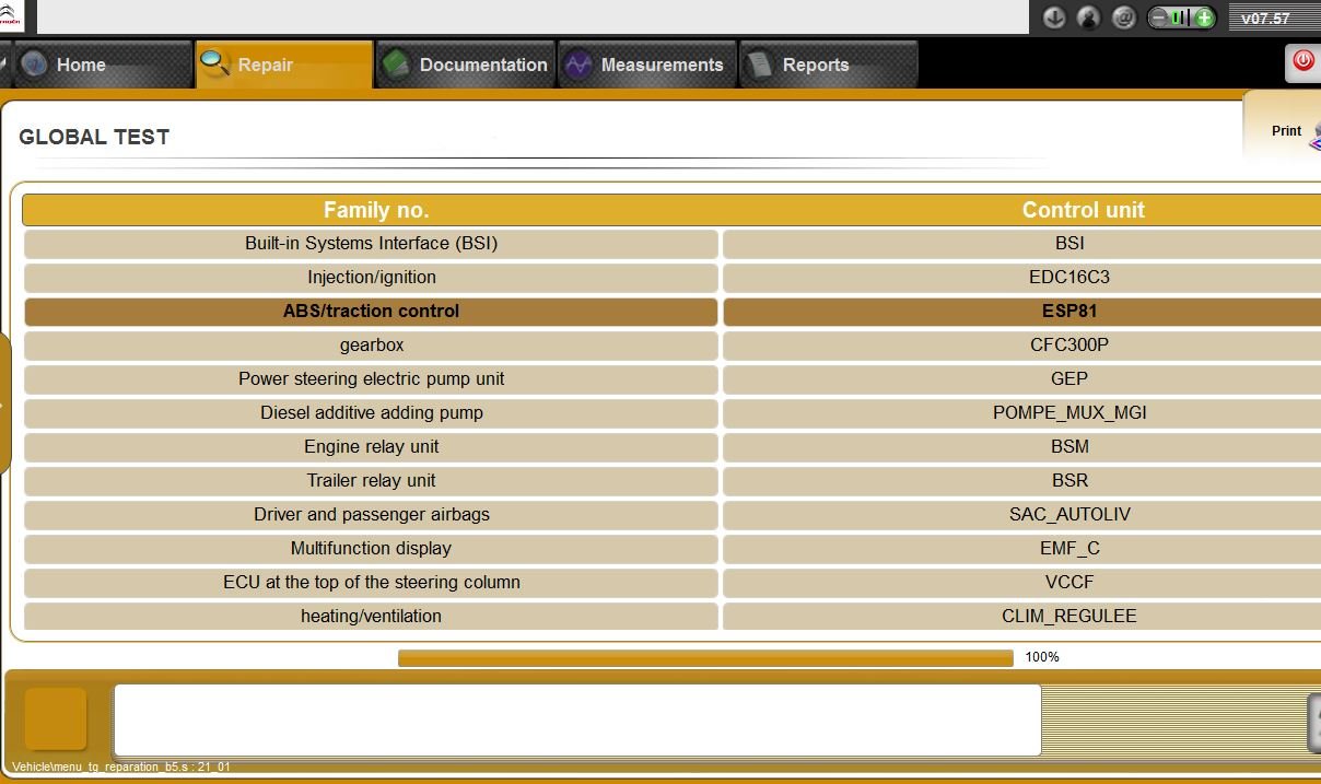

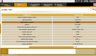

Loaded up Diagbox just now and appears to recognise ABS ECU. Tried global test and retried 'test by function' on Lexia and would not pick up the ABS ECU.

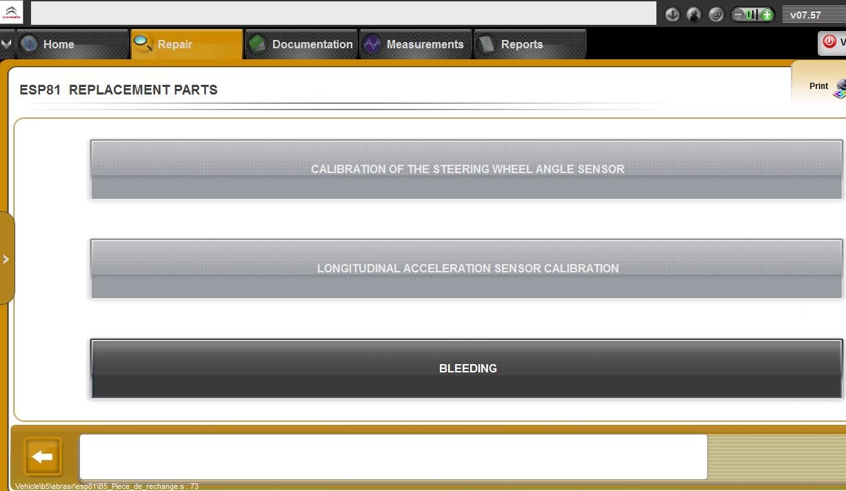

Diagbox screenshots shows the bleeding function available of ESP81 (Bosch 8.1 which is correct according to my technical information), so will give this a go on Saturday, unless someone can confirm what Diagbox does next if I click on 'bleeding':-

Re: Lexia 3 / Diagbox Citroen C4 1.6 HDI
It will be a guided procedure, so be prepared....
This is normally the second part of the operation when bleeding the primary and secondary brake circuits after changing the brake fluid.
This operation is performed in 2 stages:
Carry out an automatic bleed or a manual bleed using the brake pedal (Primary circuit )
Complete the bleed (secondary circuit) with exclusive reference to the diagnostic equipment procedure, which is what I think you are referring to above.
Let me know if you need the steps for the bleeding at the pedal part (which obviously needs 2 people), but the secondary part is guided via Diagbox.

I’ve already used a one man pressure bleeder to bleed as much air out of the primary circuit but have a pedal that goes to the floor. ABS bleed required as I replaced a seized rear caliper.
Was just wondering if I clicked on ‘bleed’ whether it would start the pump straight away as I wasn’t intending to do the bleed last night.
In the limited time I had available, was nice to find the bleed function and that Diagbox can do something that Lexia chant under v7.57

Was also wondering whether the Diagbox by default bleeds two wheels at the same time ie. rear left and right or just one wheel at a time.
Thanks!
x 6950
Couldn't say for sure - but normally the procedure will give you a warning before it starts, so selecting the option will probably lead you to another menu before it starts anything.
