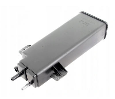

I was just having a look. I take it the vapor absorber is to the rear/fuel tank area.
Only line I can see feeds down under the bulkhead.

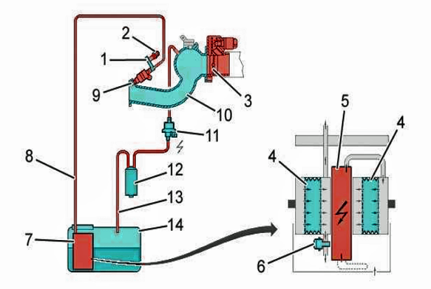

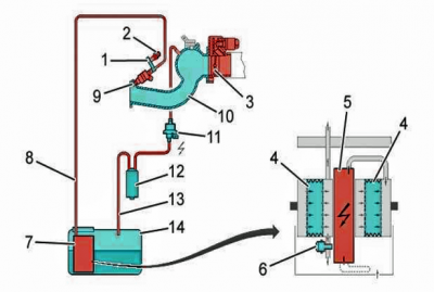

Re: 2009 C5. New owner,some issues
This is what it looks like:
And here in terms of components in the circuit. Item (11) is the electrovalve and (12) the carbon filter / canister:
Key:
(1) Petrol injector supply rail.
(2) Valve SCHRAEDER.
(3) Throttle butterfly housing.
(4) Fuel filter.
(5) Fuel pump and gauge assembly (submerged in the fuel tank).
(6) Fuel pressure regulator.
(7) Fuel gauge/pump module with integrated fuel filter.
(8) Fuel supply pipe.
(9) Petrol injectors.
(10) inlet manifold.
(11) Canister Electrovalve.
(12) Active carbon filter.
(13) Petrol breather blow-by pipe system.
(14) Fuel tank.
Special features:
  • Injection rail without petrol pressure regulator
  • Fuel pressure regulator incorporated into the sender unit
  • Injection rail without fuel return

I had a look from the rear this morning but couldn't see it.
Ive got busted knees so cant really be jacking up/climbing under my cars these days.
Guessing its likely tucked in the passenger side forward of the fuel tank
x 6957
It's possible that it might be located where the additive tank would be on a diesel - next to the fuel tank (on the left side of the fuel tank) as you stand behind the vehicle facing forward. The additive tank would be located under some heat resistant foil - but as this is a fuel vapour canister, I would expect it to be away from the heat of the actual exhaust. Just a guess mind.

Is a vapour canister the same thing as purge canister ?
Convinced but willing to be proved wrong that its the same thing that was hidden behind the n/s wing ( RHD) Xantia i had that was built in 1996 something tells me i asked CitroJim what it was as it was the first petrol Xantia i had owned and had no idea what it was ?

I can see the vacuum line going down under the bulkhead,so wouldn't expect it to be under the wing.
I did peer in from the passenger side but the C5s low and couldnt get a look,really needs lifted. Probably easy seen once its up.
I expect its in the area by the exhaust silencer forward of the fuel tank.
I dont have anywhere here to work on the car but outside the house and with the lockdown I guess I shouldnt be doing that.
Think I might have to put her in a garage and eat the cost.
Ill take her for a run and give what I can see a checkover tomorrow but it seems tight under the bonnet.

Needs to be away from fuel lines and sparks, needs to be purged to air so near an area that gets fresh air pulled in, just thinking aloud

Gonna have to admit defeat. Looked underneath and its all lovely with underbody covers. Nice rusted nuts. Tried undoing one and it eventually sheared.
I can see 2 brake lines and one flexi hose going up the passenger side.
I can see another flexi going up the drivers.
so one will be fuel and one vacuum I take it.
