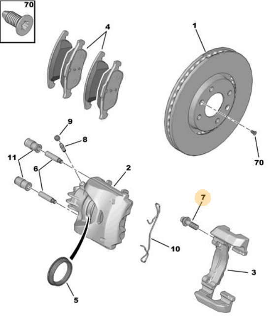

DS4 FRONT Caliper bracket Torx screw bolts
Unread post by Jjj »
Does anyone know where to get these bolts from other than Citroen ds are they Citroen DS only should I snap one in changing front discs
x 6957
Re: DS4 brake change
If it's item (7) - Brake Caliper Fixing Screw, these are part number: 440558. The dimension are: 12x150-40
You can get them from here John:
https://genuine.tomoparts.co.uk/car-par ... 7e-440558/
