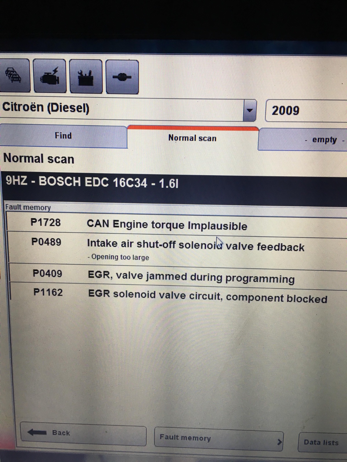

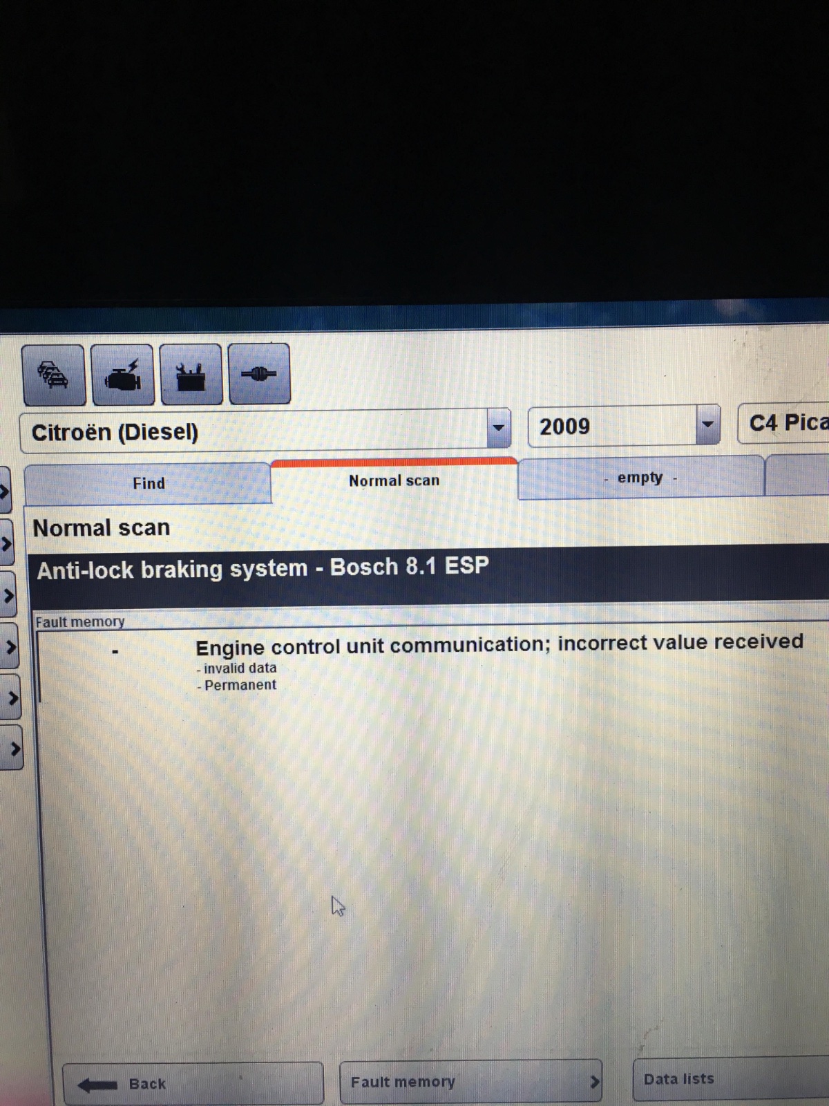

I’ve had my mechanic test the 5v supply to the EGR and he said it’s fine. He said when clearing the faults the only ones that immediately come back are as shown in the pics.

Ask him to an actuator test on the egr, it's the egr, the faults are too similar to be a coincidence.
