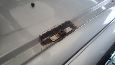

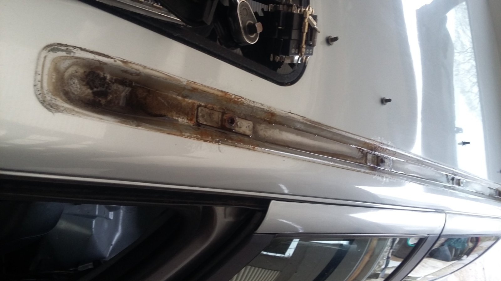

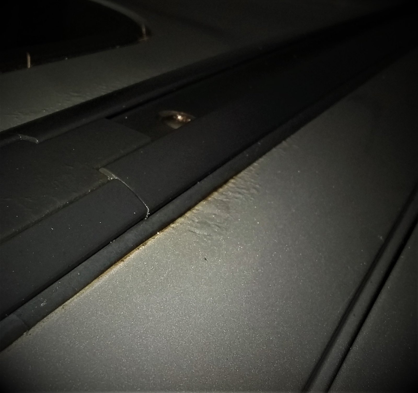

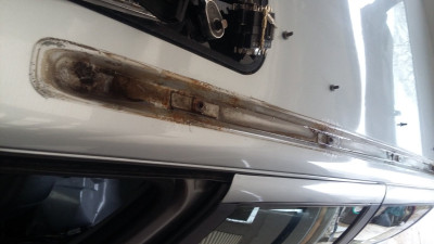

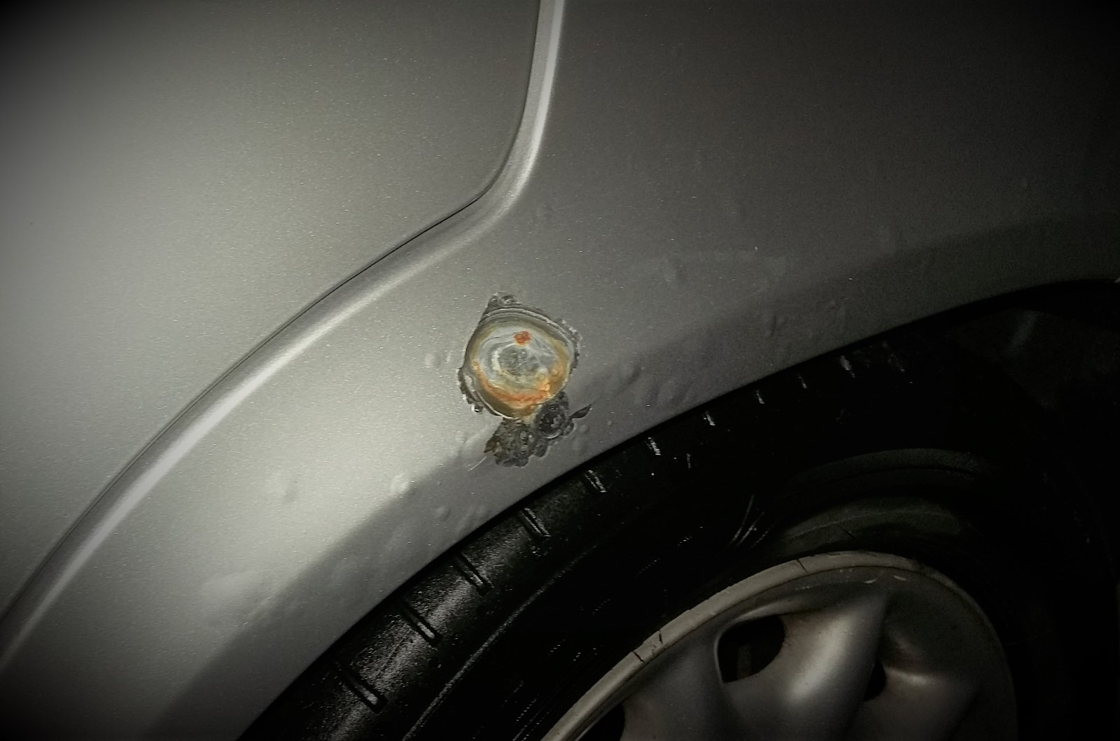

Some roof rail/roof corrosion, this car may now get a black "Wrap" roof. I have always wondered what they would look like on the estate Xantia, this my be the excuse to try.

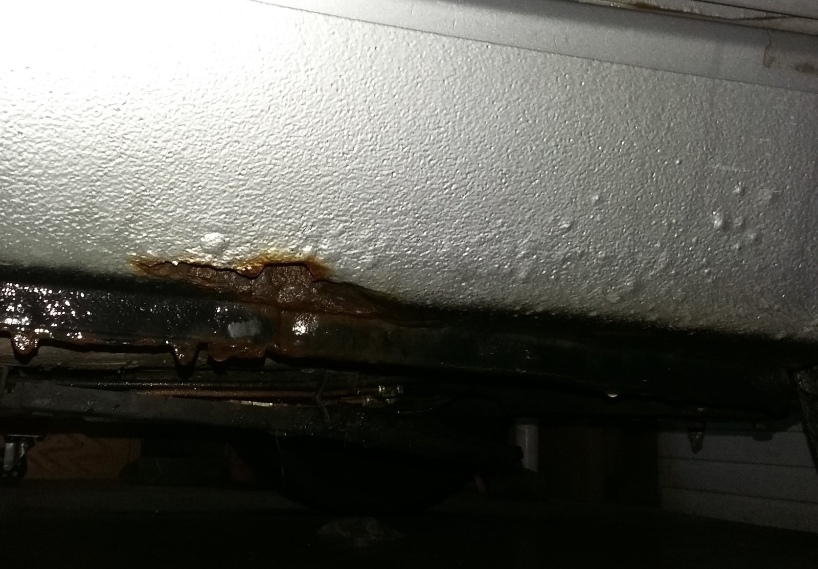

Sill rot and a hole. New sill or patch? we shall see when we cut this out.
Jet Washer + Paint bubble, paint bubble is the looser. They need to come off anyway so touch up paint for now.

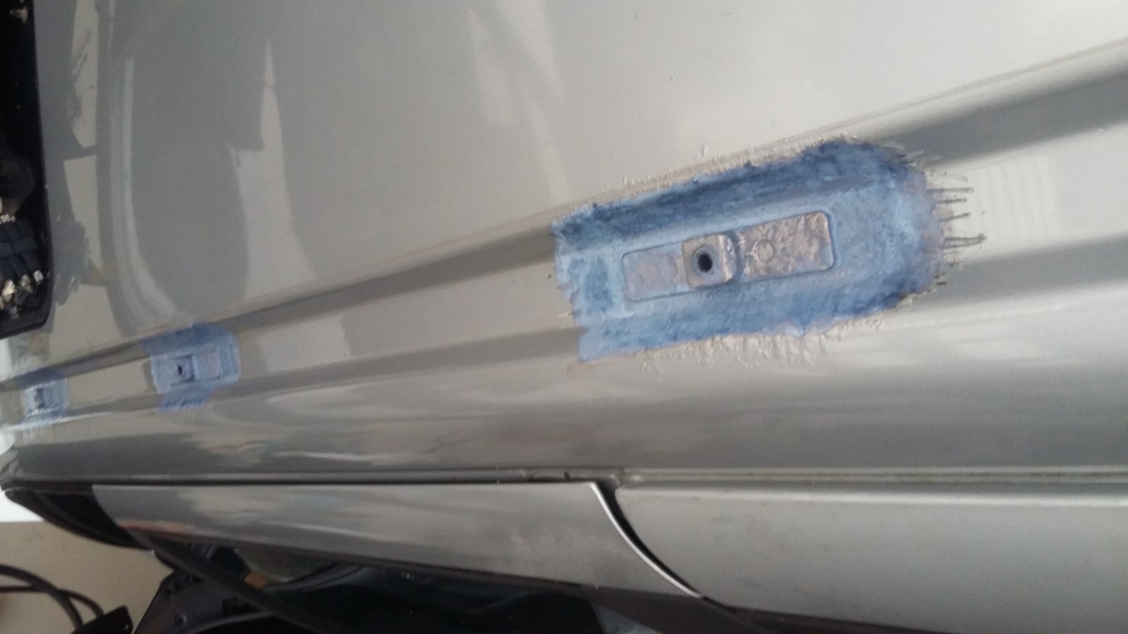

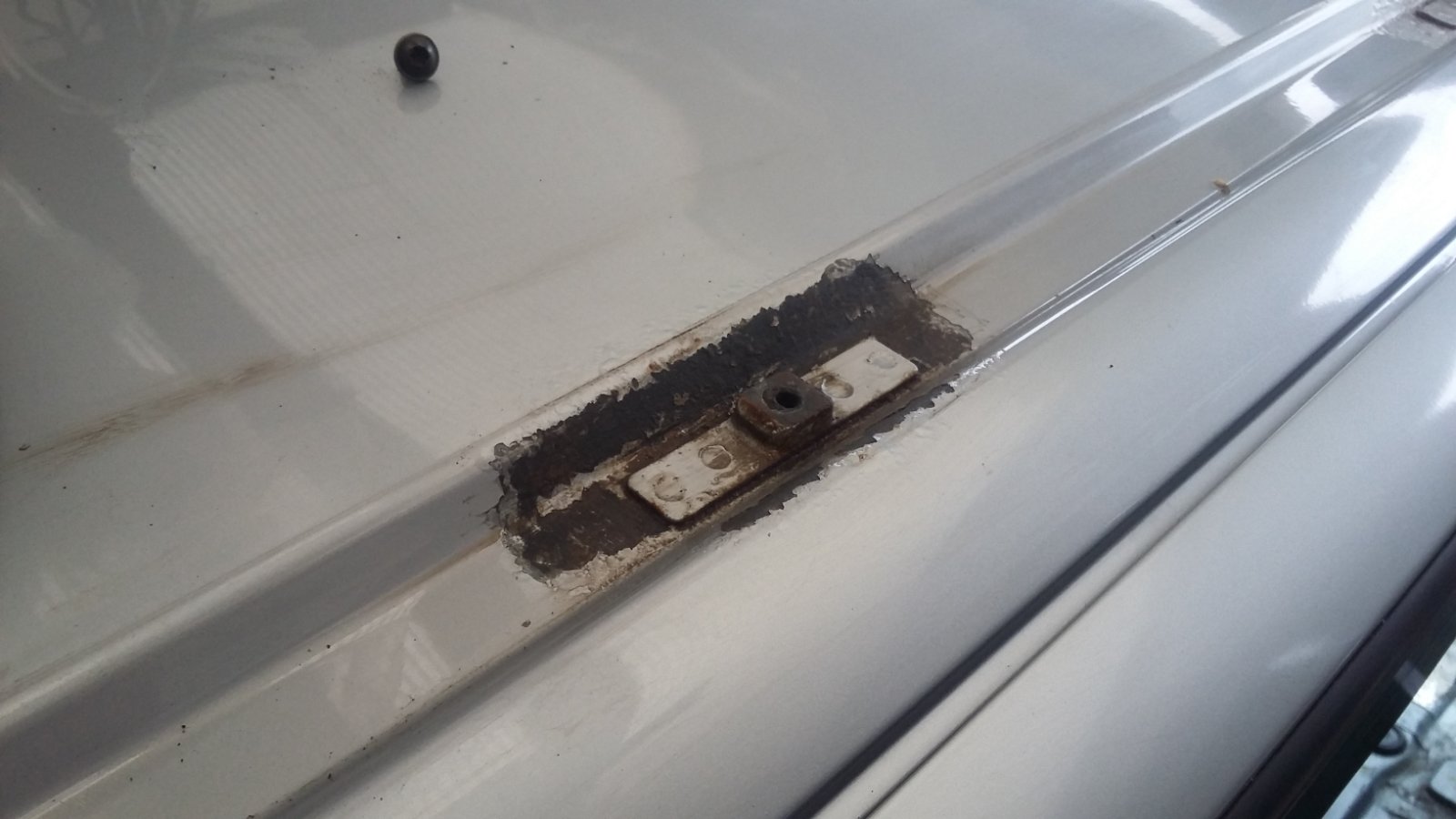

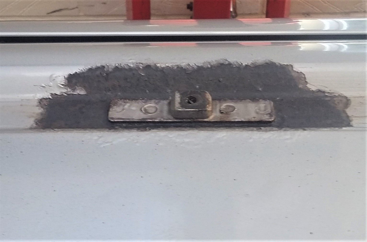

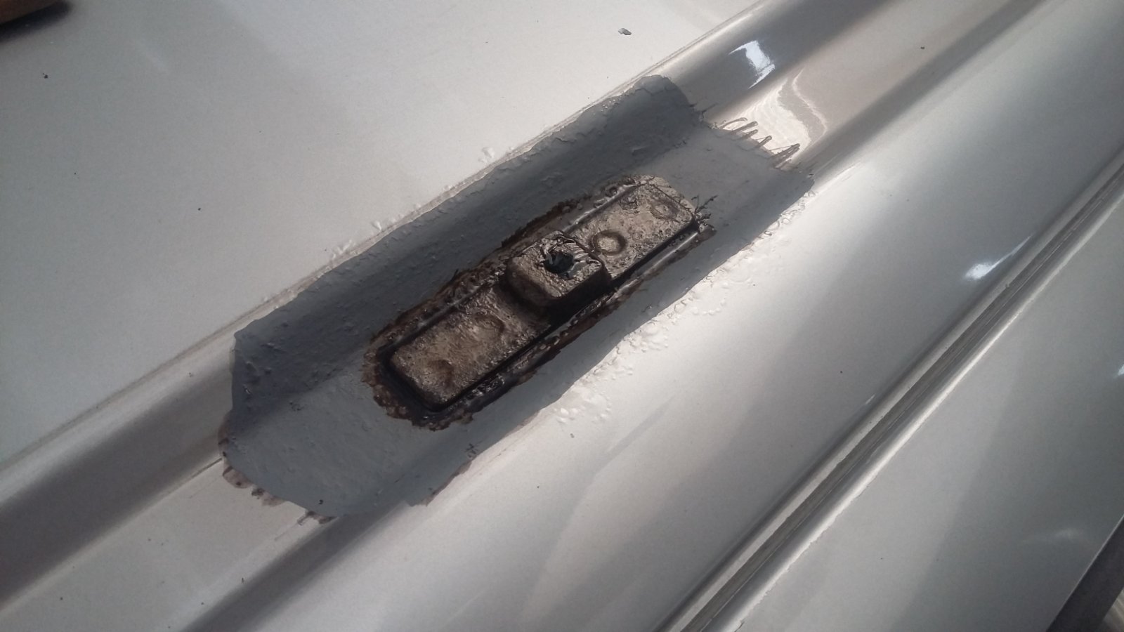

Time to investigate the roof bar channels
errr :(
Screwdriver dug it out to have a look, the black is the zinc coating doing its job, not much "rush"....the pint next to the bars however has bubbles so i am still considering a vinyl wrap (black) roof as I cannot see a respray being worth it.
Some Bilt&Hamber converter as a temporary retardant until I decide with Paul what to do with the roof.

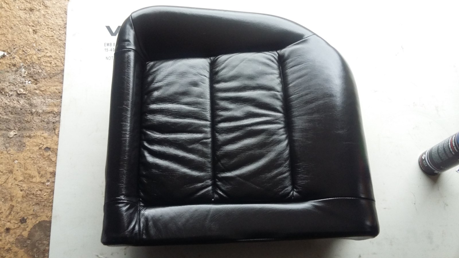

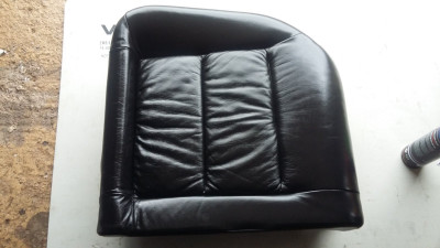

Well the leather looks like it will clean up well...
Posts: 11819
Joined: 28 Mar 2013, 21:05
x 1999
Re: 2.1Turdo 12v Shedroen Estate has arrived
Unread post by Stickyfinger »
That is them cleaned up then.
