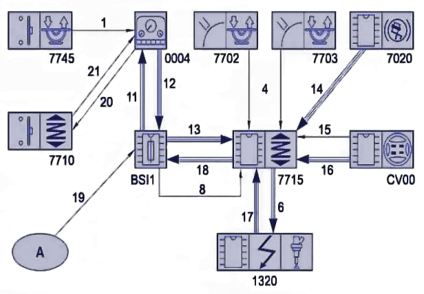

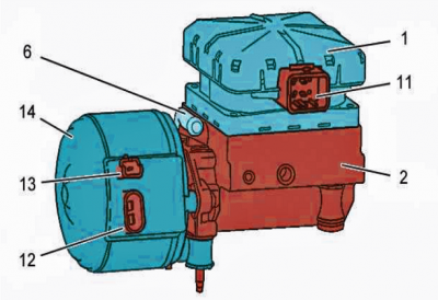

Parts of the BHI on a C5 MK II
Integrated BHI
The BHI, a monoblock which cannot be taken apart, is composed of the following components:
Key:
So can you confirm that the Suspension switch in the cabin is not in 'Sport' Mode as no height correction takes place when in 'Firm' status.
I would also double check the electric plug sockets to the BHI and make sure you can see the pins - if there is any electrical break then it may affect the operation of the electrovalves internal to the BHI (even though the pump motor is working).
| Reference | Designation |
| 1 | Suspension ECU |
| 2 | Hydraulic valve block |
| 6 | Hydraulic pump air intake aperture |
| 11 | Suspension ECU connector |
| 12 | Electric motor supply connector |
| 13 | Electric motor control connector |
| 14 | Electric motor |
- An electric motor to drive the hydraulic pump
- A hydraulic pump with 5 axial pistons
- An anti-pulse accumulator, flow regulator
- 4 electrovalves: 2 per axle, 1 for inlet (raising the vehicle), 1 for outlet (lowering the vehicle)
- An electronic suspension ECU
- 2 anti-sink valves
- 6 hydraulic fluid filters: upstream and downstream of the electrovalves
- 1 overpressure valve

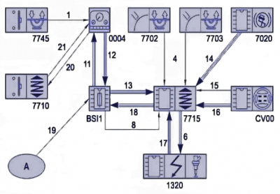

Key:
- Single arrow: Wire connection
- Triple arrow: Multiplexed connection
| BSI1 | Built-in systems interface |
| A | Door switches. Luggage compartment switch (Estate only) |
| 0004 | Instrument panel |
| 1320 | Engine ECU |
| 7020 | ABS ECU |
| CV00 | Steering wheel angle sensor (hydractive 3) integrated in the switch module under the steering wheel |
| 7702 | Front body height sensor |
| 7703 | Rear body height sensor |
| 7710 | Sport mode suspension switch (hydractive 3+) |
| 7715 | Suspension ECU |
| 7745 | Vehicle height push button |
| N° | Connections | Emitter of the signal | Nature of signal |
| 1 | Request for change of height | 7745 | All or nothing |
| 4 | Vehicle height information | 7702. 7703 | Digital |
| 6 | Hydraulic pump motor functioning status (petrol only) | 7715 | CAN |
| 8 | Status of the openers | BSI1 | Digital |
| 11 | Request to light height correction fault. Lighting of height warning lamps | BSI1 | COMFORT CAN |
| 12 | Request for change of height. Request for change to sport mode | 0004 | COMFORT CAN |
| 13 | Ignition switched "+". Request for change of height. Principal brake switch | BSI1 | CAN |
| 14 | Vehicle speed. Longitudinal acceleration. Distance | 7020 | CAN |
| 15 | Steering wheel speed (vehicle not equipped with ESP) | CV00 | COMFORT CAN |
| 16 | Steering wheel angle (vehicle not equipped with ESP) | CV00 | Digital |
| 17 | Engine speed. Starting in progress. Accelerator pedal position | 1320 | CAN |
| 18 | Request to light the height correction fault lamp. Vehicle height information | 7715 | CAN |
| 19 | Information on the status of the doors | A | All or nothing |
| 20 | Lighting of hydractive 3+ activation warning lamp | 0004 | All or nothing |
| 21 | Request for hydractive 3+ suspension | 7710 | All or nothing |
