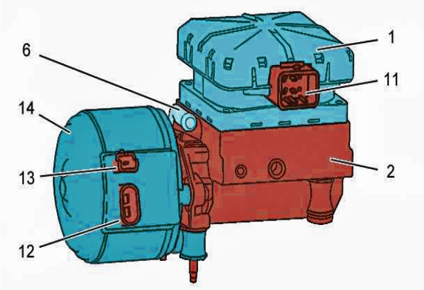

Parts of the BHI on a C5 MK II
Integrated BHI
The BHI, a monoblock which cannot be taken apart, is composed of the following components:
Key:
So can you confirm that the Suspension switch in the cabin is not in 'Sport' Mode as no height correction takes place when in 'Firm' status.
I would also double check the electric plug sockets to the BHI and make sure you can see the pins - if there is any electrical break then it may affect the operation of the electrovalves internal to the BHI (even though the pump motor is working).
| Reference | Designation |
| 1 | Suspension ECU |
| 2 | Hydraulic valve block |
| 6 | Hydraulic pump air intake aperture |
| 11 | Suspension ECU connector |
| 12 | Electric motor supply connector |
| 13 | Electric motor control connector |
| 14 | Electric motor |

F4? That's for the Headlamp washer system in the PSF1 engine Fusebox (if fitted) supposedly...C5 and P2 2-8-2 fan wrote: 03 Mar 2020, 14:27 Is the F4 fuse in the engine bay box ok?
If its blown it could be one of the ride height sensors shorting out(Don't ask how I know this).
7702 & 7703 (Front & Rear Height Sensors) are supplied directly by the Suspension ECU. So if there is an electrical problem with the suspension ECU on the BHI - then it is entirely possible this will affect the operation of the electrovalves - which is why I've suggested a close look at the circuit / connectors there. The pump itself is supplied independently.
