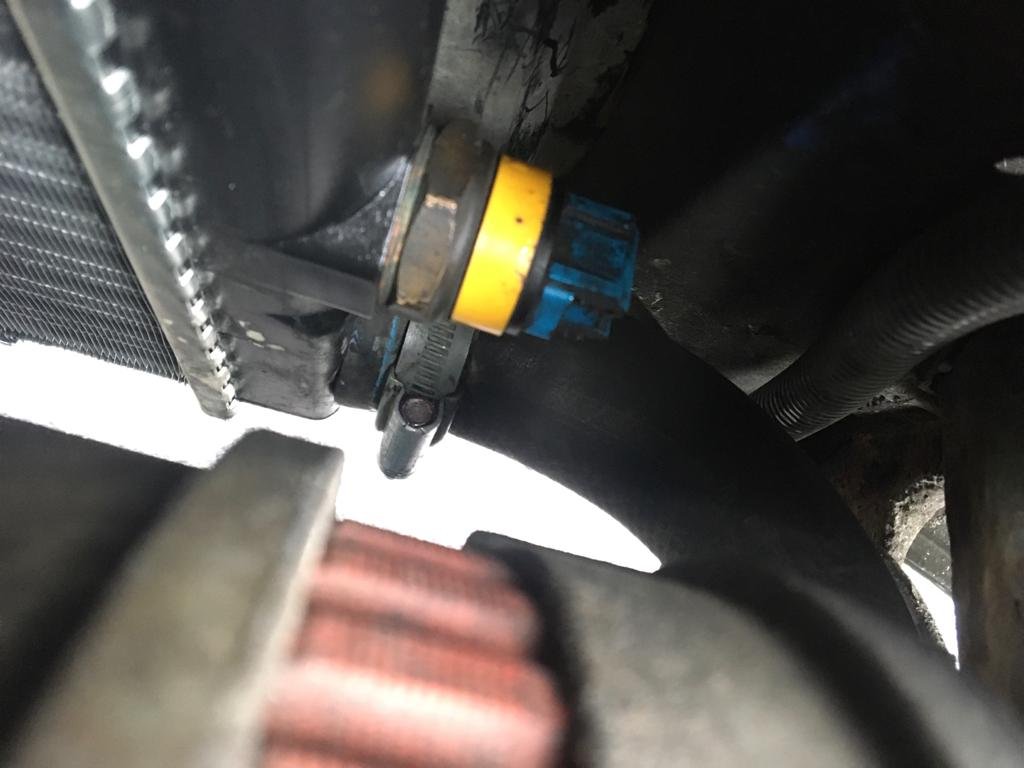

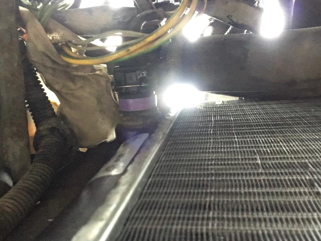

after a full day on the car i've found the fan switch on the rad 3 pin plug (purple ring on it) directly under the feed pipe
and a yellow ringed sensor that had know wires going to it bit had 2 pins, had a good look but couldn't find any wires to plug in to it.

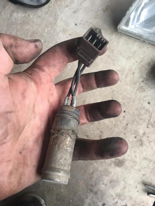

Your first photo shows a fan (slow speed) dropper resistance. This is only fitted to cars having a single fan.
You say you have two fans . . . which is it, one fan or two? (Some cars had space for a second fan, but it wasn't factory fitted.)
You also mention a fan switch on the rad, with three terminals. Could you post a photo of this?

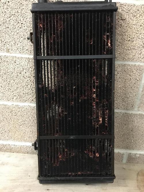

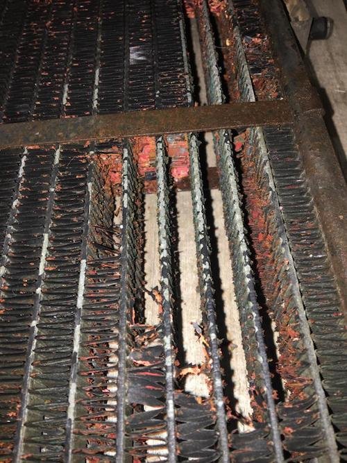

The fifth photograph of the radiator shows that a great many of the fins in between the tubes are missing. This means that even though the hot water may be moving through the tubes I suspect that the heat in them isn't able to be radiated away properly. Even if the radiator tubes have now been cleaned out I think that the radiator needs replacing. You may be able to find a traditional radiator repairer who can replace the core more cheaply but usually a new one is the best answer.

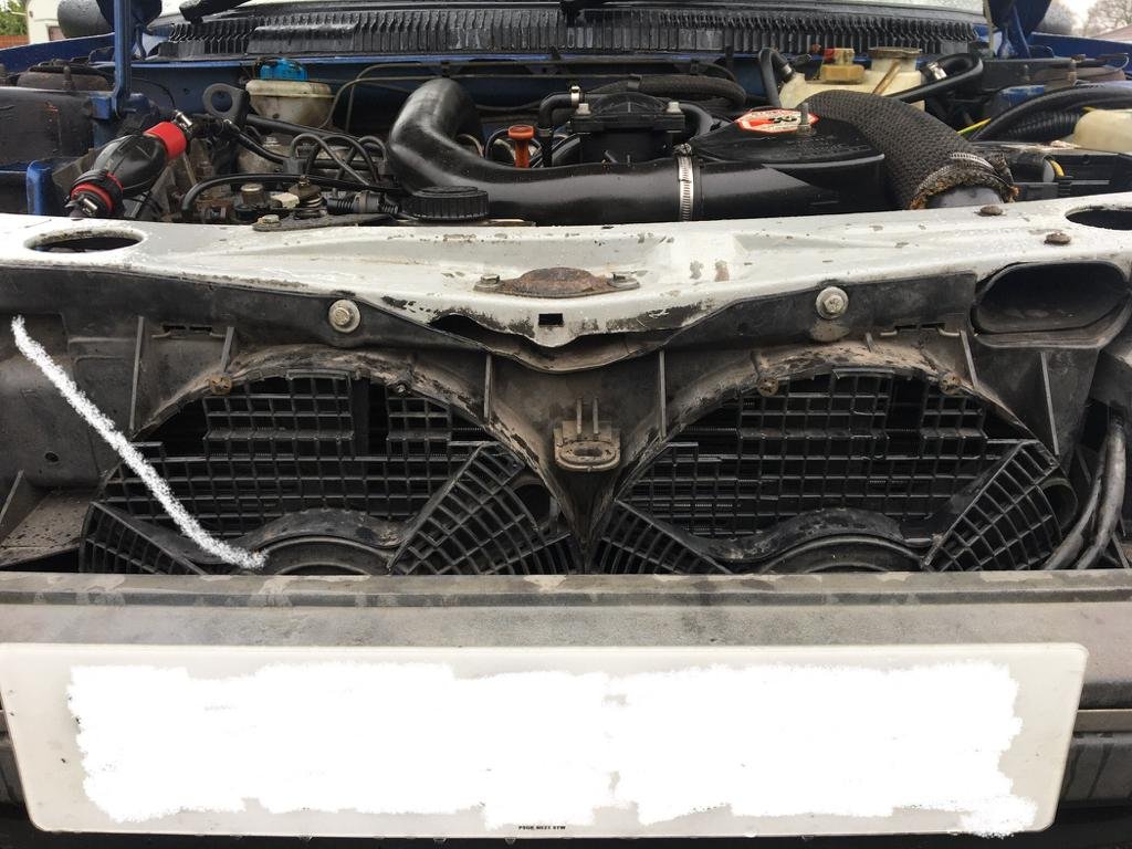

heres more photos there are two fans fitted and wired up (see the two white connection plugs) what i think is the fan switch (looking up from underneath) heres the one with know plug on it (from above)white exec wrote: 14 Mar 2020, 23:04 Very confused now!

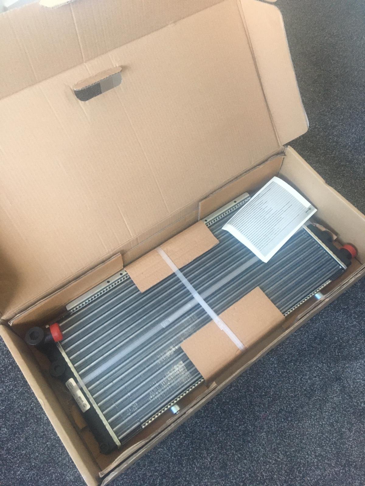

yer!!!Paul-R wrote: 15 Mar 2020, 10:57 The fifth photograph of the radiator shows that a great many of the fins in between the tubes are missing. This means that even though the hot water may be moving through the tubes I suspect that the heat in them isn't able to be radiated away properly. Even if the radiator tubes have now been cleaned out I think that the radiator needs replacing. You may be able to find a traditional radiator repairer who can replace the core more cheaply but usually a new one is the best answer.
i fitted a new rad after seeing that mess
still having the same problem with fans coming on in normal conditions so i think it must be a switch or a wire brake triggering them to come on and stay on whilst moving

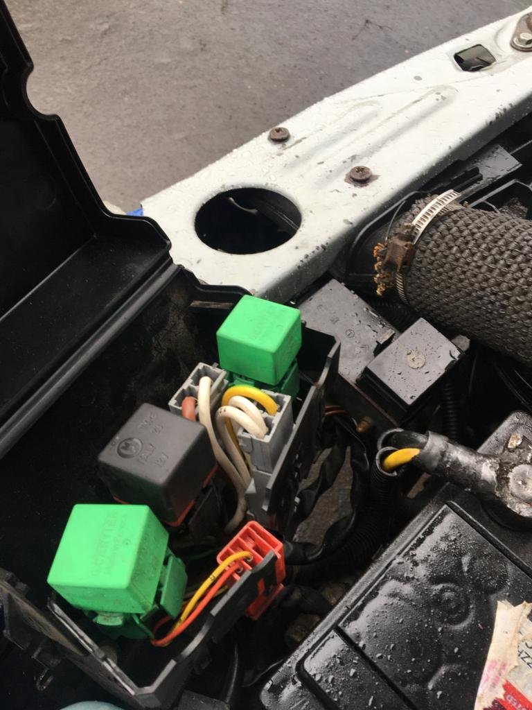

OK, here goes. Thanks for posting the photos.
You seem to have two fans and a thermo-switch, so must also have a bank of three relays (working together) to control the cooling fans.
The relays comprise three identical-looking 'cube' type. Two of them have 4 pins (and 4 connections on the socket), and the third has 5-pins. Important that the 5-pin one goes in the correct 5-pin socket. All three must be present, as they work together.
There look to be two switches screwed into the radiator side tank, one yellow, one purple.
Not sure which is which, but the thermo-switch that controls the fans will have 3 wires connected to it, and will usually be half-way down (or maybe lower) on the side tank.
The 3 wires are
- Supply (or Gnd, depending on the build of the car)
- power (or Gnd) out to the relays, to trigger Low fan speed *
- power (or Gnd) out to the relays, to trigger High fan speed *
If the fans are cutting in at too low a temperature, it is likely that the thermo-switch is faulty, and should be replaced.

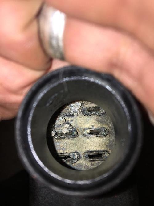

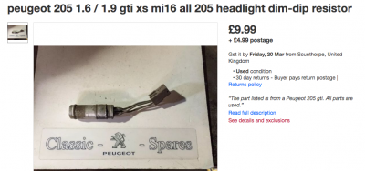

This looks to be the headlight dim-dip resistor (i don't know how it works) took me lots of head scratching and i think i understand what you mean finally.......... (yes i'm slow)
I can see the 3 relays and have a new Temperature switch coming so if that fails i'll look at relays
I do under stand i my be chasing a problem thats not a problem, but i'm getting to grips with car repairs atm so i'm not to worried about the wasted time and money i'm chucking at it

Phased out years ago. If you just put the side lights on, that would bring the dipped headlights on at half brightness to stop people driving around with just sidelights on.
