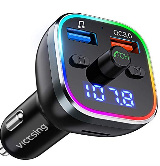

If you really want to have a different option, then consider getting something like this, which will allow MP3 to be played from a mobile or a USB or a Flash Card and transmit to the Head Unit via FM - a simple cheap solution and at £11 it won't make you bankrupt :-D
This will allow you to keep all the functions of your RT4 without cannibalising your vehicle for the next owner.

I already had one of those devices...not good there is always interference from the radios stations. Next owner?? This one will stay with me for a long time. In summer she will have lots of things done, turbo replacement, injectors, shocks, bushings all belts and water pump and maybe clutch. She will be ready for another 20 years. And i already bought a engine with 70k.
