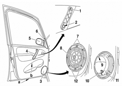

How do the door cards come off ?
Remove:
  • The interior trim cover of the door mirror ( 6)
  • The exterior mirror (5)
  • The door handle trim (4)
  • The speaker grille (3)
  • The screws (7) and (12)
  • Disconnect the connector (10)
  • The speaker (8)
  • The screws (1), (2), (9) and (11)
Unclip the trim panel using trim removal tools.
Remove the trim panel starting from the bottom at " a".
Move the trim panel away from the door inner panel and lift at " b" to release the trim panel from the weather panel.
If necessary, remove the weather panel sealing sheet.

Thanks Marc very helpful , now I've got the dreaded rear wiper working in its own I've read this is a common old niggle with this car .
