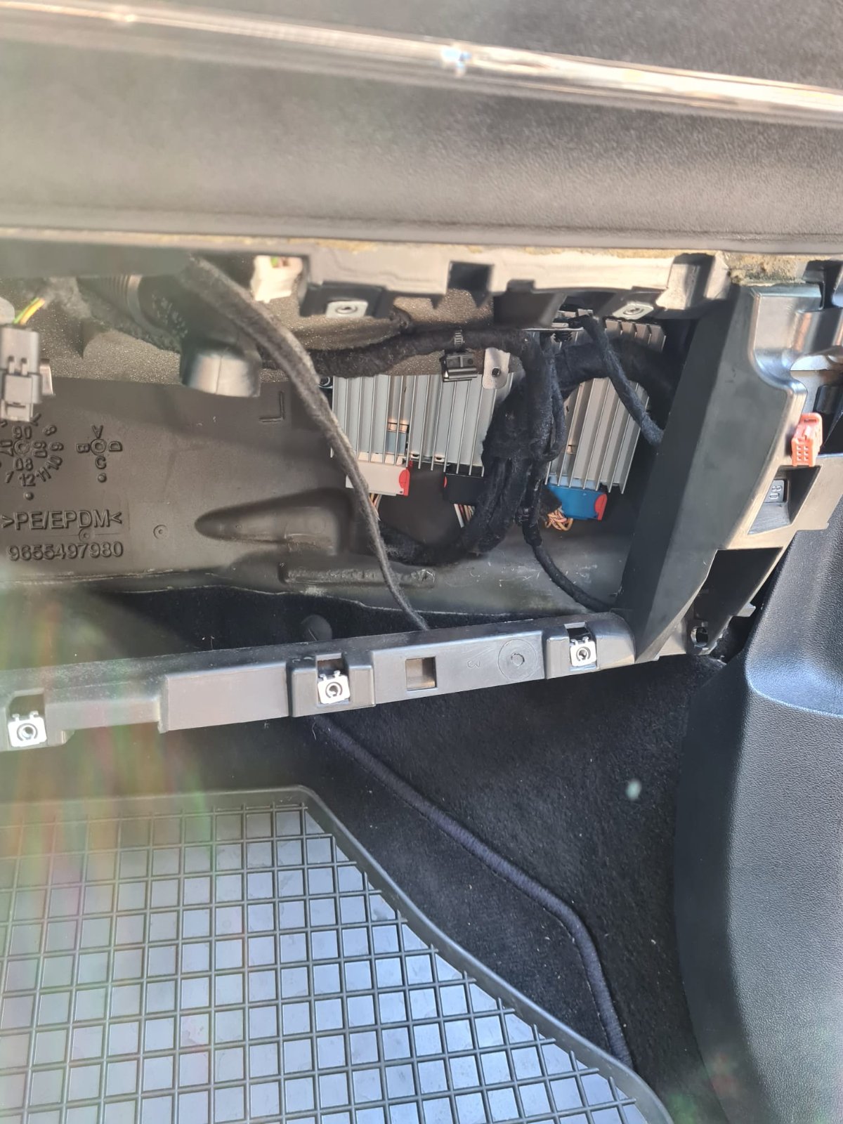

Is it possible to identify via photo which amplifier is this? I hope I attached it correctly. Or maybe via VIN number?

- x 6957
Re: Android Radio for C5 X7
I can only help you with official part numbers, but this requires a membership upgrade - details below if interested, otherwise, you will have to disassemble it from the bracket to check if there is any info on the unit.
