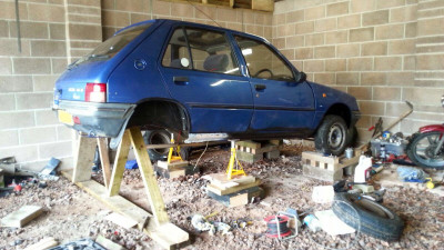

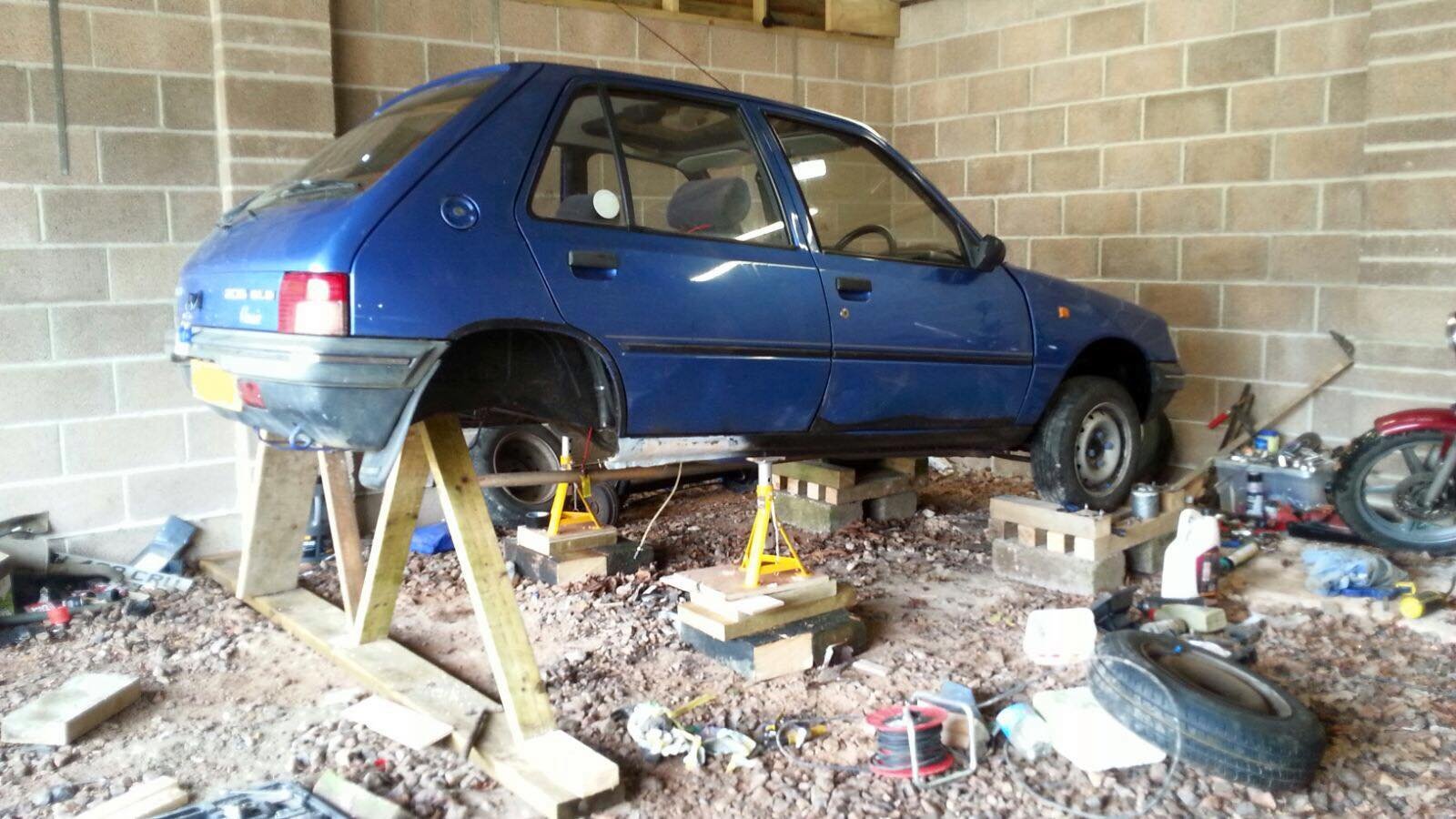

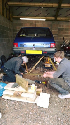

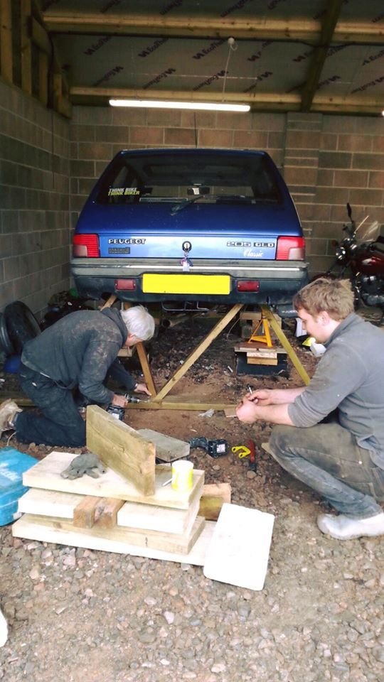

in the mean time here are some photos to make you laugh we had to do some welding and didn't have a pit... some time in the future i'll get a car rollover jig for the full restoration

"Wooden suspension" is usually something Citroen owners complain about (on bad days)!
She's getting some good TLC there.

nowt wrong with a bit of 'makeshift & mend'. I've found a multitude of uses for Concrete Blocks too.
I like to also have a couple of well positioned wheels under a car, so that should anything go wrong there's a good chance the wheels will take the blow of the falling car, rather than oneself.
