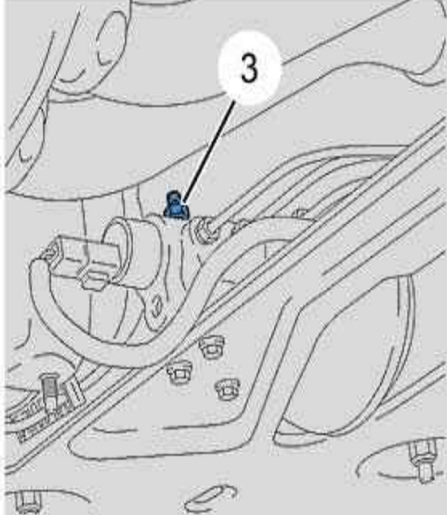

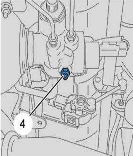

Ok, so on your C5 which is Hydractive 3+:
To depressurise Manually:
The vehicle should be in the lowest suspension position - but if you can't do this because of the fault, then I don't know how this will affectt he operation - but I suspect there will be a lot of pressure - so caution is advised - wear some protective goggles, as I suspect there will be a lot of LDS coming out under some pressure. Do not re-use any LDS that comes out.
| Front suspension: Undo the detensioning screw (3) by one turn. Wait for the pressure in the hydraulic circuit to fall fully. | Rear suspension: Undo the detensioning screw (4) by one turn. Wait for the pressure in the hydraulic circuit to fall fully. |

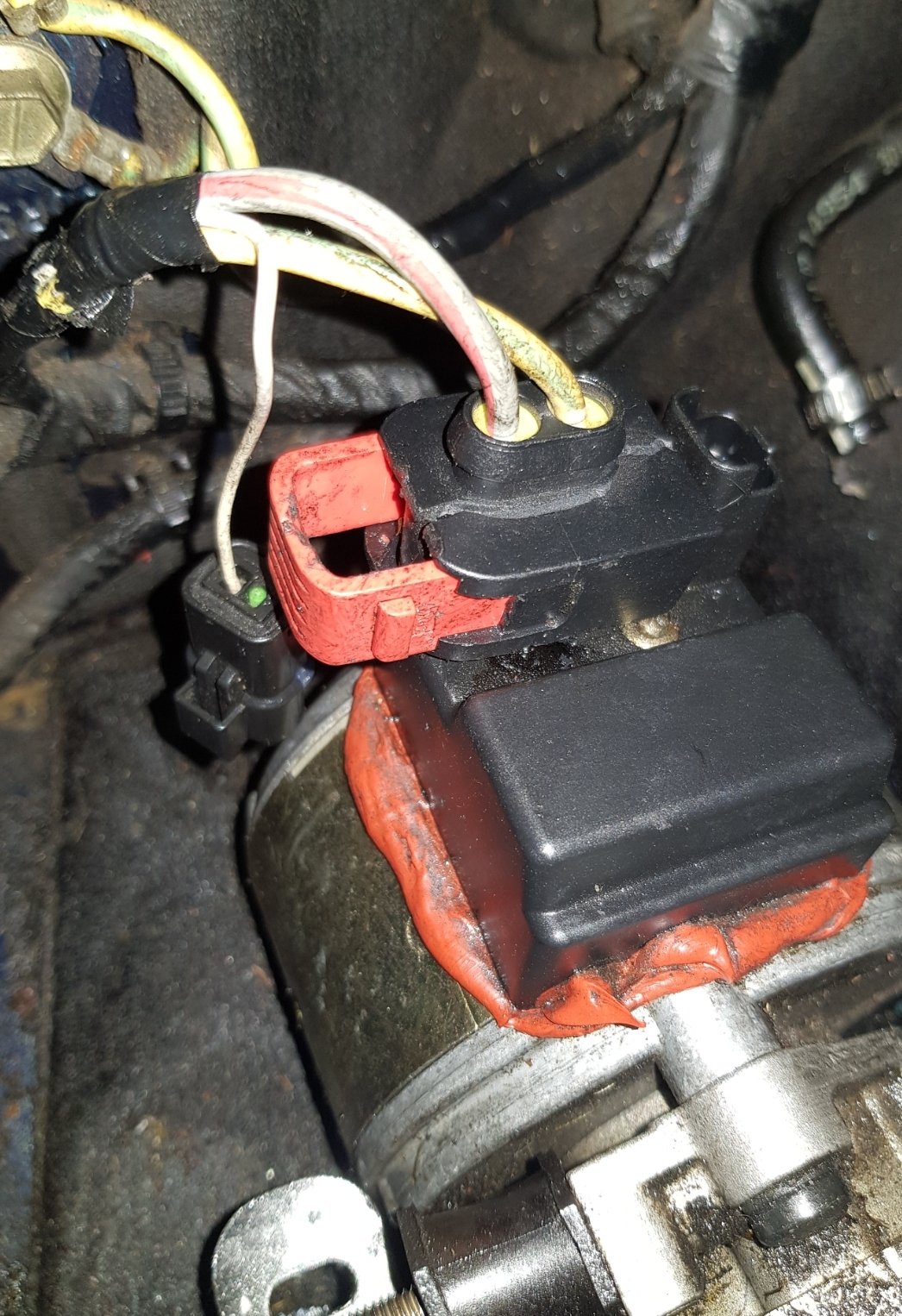

zeeshanzaki
- Posts: 124
- Joined: 18 Jul 2017, 11:07
- x 6
Re: C5 front suspension stuck at highest setting
