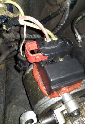

zeeshanzaki
- Posts: 124
- Joined: 18 Jul 2017, 11:07
- x 6
Re: C5 front suspension stuck at highest setting
I decided to remove the pump today before ordering parts. Everything went smoothly but can't disconnect power connector from the motor. I pulled the red clip but the connector is not disengaging from the motor. Looks like someone already changed the pump in the past. Connector is also partially broken. Is there anyway to disengaging without completely braking it. If I can't remove the motor, i am going to put it back and sell the car to wrecker.
