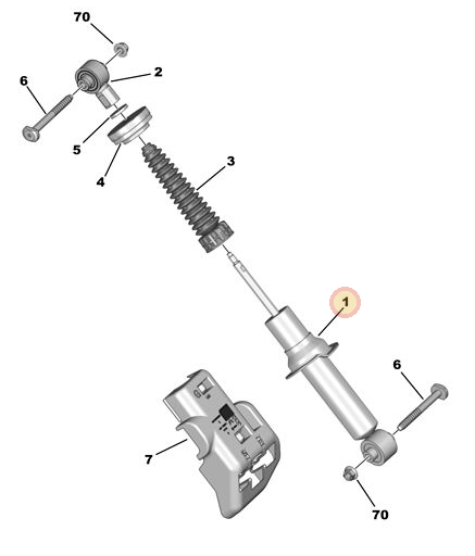

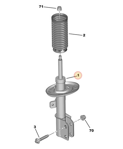

Thanks for your Forum Donation. If you have any future part number requests, just pop the request up in this thread:
So your DS7 would appear to already have variable damping suspension, so should already be adjusting itself to the road conditions. The front struts are programmed to 'Suspension Law 3', so one assumes there are other laws that may be configured via the dealerships diagnostic system. You have a suspension ECU that handles all this, so maybe worth checking whether there's anything the dealer can do to change the law and alter it.
Although the Hyrdractive C5 is a completely different system with self-levelling that the DS system doesn't have, you still only got the best ride with a load of weight in the rear. It never skipped the road at all, but was noticeably better with weight in the rear.
Maybe it's the same with your unladen DS7. Try borrowing the neighbours for a while in the rear and go for a spin with a boot load of cast iron radiators and see if it still jumps.
But in reality, another member was asking about DS shocks in general and there are no alternatives at present as these are specially designed for the vehicle. As you can see form the price, they're not exactly cheap because of this.
Front Shocks
(1) Front Variable Suspension Shock Absorber, Left, part: 9827150780, £298.37
Front Variable Suspension Shock Rear ShcAbsorber, Right, part: 9827150680, £298.37
Rear Shocks
(1) Rear Variable Suspension Damper, part: 9827152080, £270.61 each
The vehicle is just over 5 years old now, so would normally be due for a check / change if necessary. Not sure what mileage you have on the vehicle, but they can last 50-100k - but that really depends on the road conditions - if you live anywhere like me in the rural countryside of Wales, where they've never heard of that invention called tarmac, then you'd be heading for an earlier change rather than later. We have stone chipped roads full of uneven surfaces and pot holes everywhere, so I will be looking at changing mine sometime - but luckily I can upgrade mine to the Hydraulic Progressive Cushions by KYB that make them for PSA.
I already checked for the other member on his DS regarding replacements by KYB, but they don't supply them (yet).

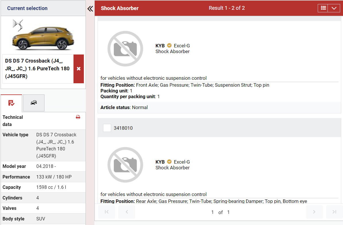

Regarding the shocks ALWAYS replace them in pairs, because of road handling and stability issues. The prices I quotes above are dealer prices inclusive of UK VAT (20%), but exclude fitting costs.
I just had a look at KYB and again for the DS7, with your suspension struts, they are not available yet as you can see from the picture:
The correct ones don't seem to be available from alternative suppliers that I can see.
