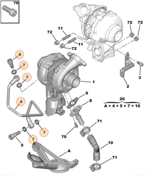

Can the lubrication pipe be removed and replaced with out the need to take off the turbo or DPF? Mine is weeping oil badly from the union beside the top banjo bolt.
Is there any better pipes to be had for this connection?
If not would you have a part number for the correct part for my Citroen please?

Yes, Two 13mm head nuts - odd deep things with integral washer. Access isn't great, quarter inch ratchet and short extension (or deep socket might just reach) is best.Gazzaman22 wrote: 17 Oct 2022, 20:51 EDIT------I think i see why mine wont come out now..... There are 2 bolts need undoing @19 in the last picture - i think....
Don't forget the temperature sensor - not pictured in that image, but in the other upper threaded boss and of course the two differential pressure sensing pipes before and after the DPF.
Think temperature sensor is 14mm hex and the pressure sensing lines 19mm hex. Can be very tight/reluctant to undo, crows foot recommended to minimize chance of rounding off

Item (4) TURBO LUBRICATION PIPE (EP 14MM), part: 037968, £89.63
Item (5) TURBO LUBRICATION UNION BOLT (DIAM 12/10X150-29), part: 037660, £10.69
Item (6) TURBO LUBRICATION UNION BOLT (DIAM 12/10X100-29), part: 037655, £9.80
Item (7) COPPER SEAL (12,2X18 EP3), part: 015708, £2.86

Can the pipe be removed on its own - Without the need to touch anything else?
Didn't know about the other!

Ah, sorry Marc for the hassle, no need for procedure, I just re read the procedure on the last page and it says that the dpf does need removal.
So it has to come out anyway. Obviously the other end is behind the dpf, and there is no way to remove the pipe with out taking it out.

Sorry missed this bit about the pipe leaking when I replied earlier.
Yes the lower connection is too buried behind the DPF to unfasten it without DPF removal first.
Some info on that turbo pipe here,
viewtopic.php?t=73096
Short version, it makes a terrible mess if left. Is reducing feed of oil to the turbo so I'm not sure I'd recommend leaving it really.

I'll leve this with Matt now unless you need any other info - as I've a few major things to sort, but yes, I agree with Matt, don't leave it leaking.
