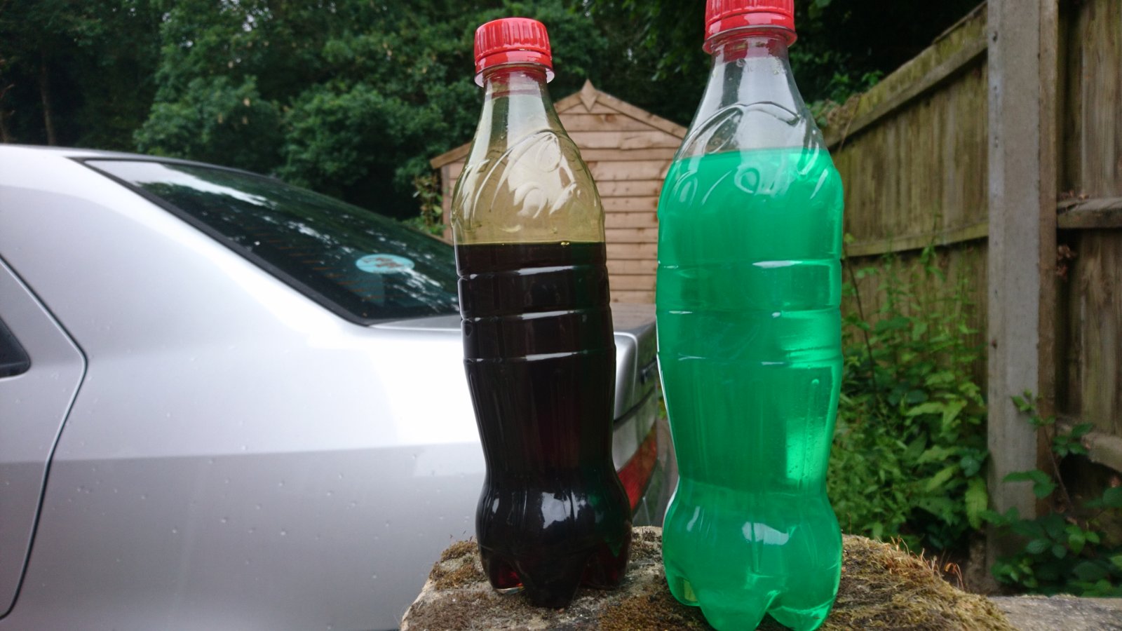

white exec wrote: 10 Nov 2019, 12:55
Dirty LHM can be anything from brown to black!
I can concur that old LHM can be anywhere between yellowish to brown to black
It does seem to me that LDS has not been used and the fluid described is actually old LHM and not really bad.
Where as This stuff was proper bad, taken out of my Xantia a few months ago.
Hydraflush is good stuff, keep up the citroebics but seems that maybe you have got good LHM in there, just need spheres checking
x 1751
Re: Replaced my flat accumulator sphere, still getting a bumpy ride
admiral51 wrote: 10 Nov 2019, 14:47 Where as This stuff was proper bad, taken out of my Xantia a few months ago.
Reminds me of an old brew called Syrup of Figs! :-s
Deserves a slot on POTD

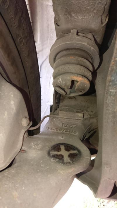

Bit of an update, I've replaced the accumulator sphere with a proper one. Still just the same
Was underneath replacing my exhaust this afternoon, and saw this
The bumps tops are definitely seeing lots of activity
x 1751
They come into contact if the car ever sinks (or is put) to Lowest setting. During normal driving they shouldn't be doing too much.
At least that one looks in one piece. With the PU foam they're made from cam go dark brown and crumbly. When new, they're a pale biscuit colour.

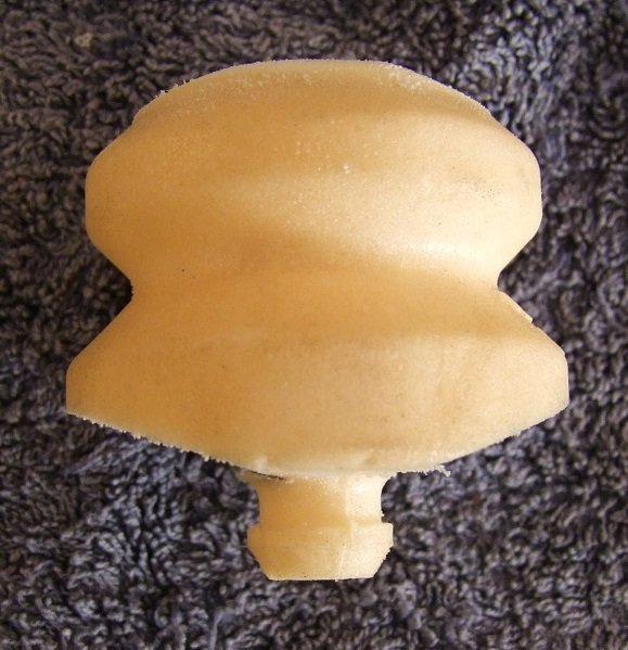

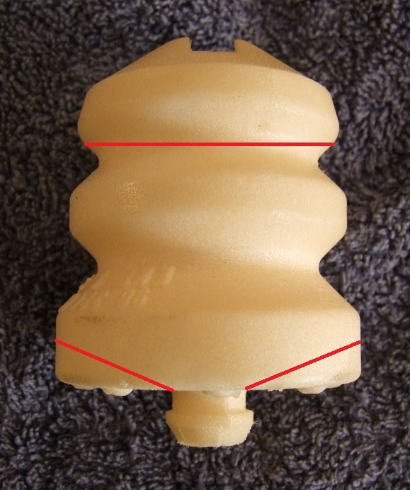

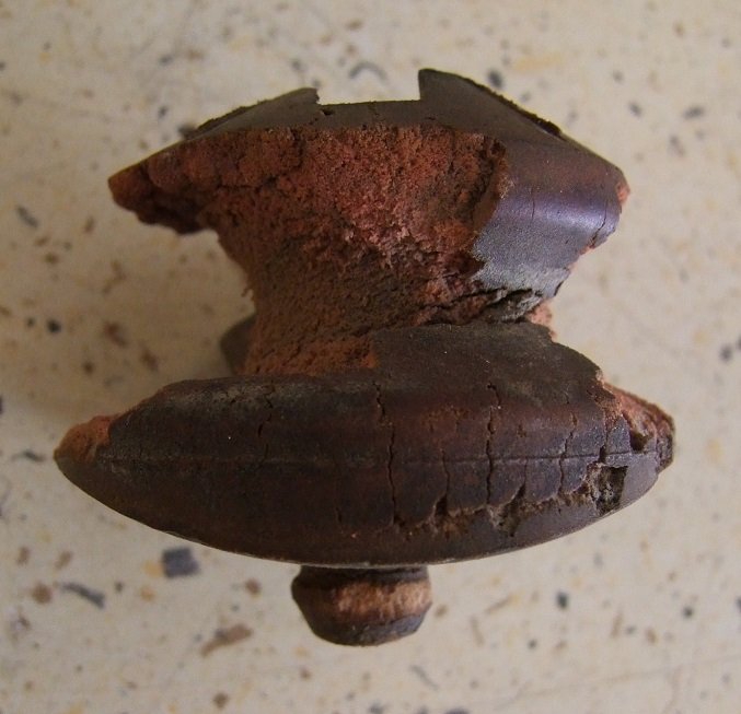

A grotty one (XM rear, inside the cross-tube), now NFP...
A new one, for downsizing...
And a bit of shaping...
