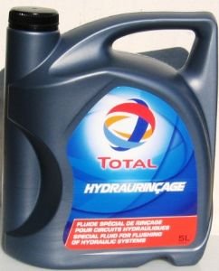

If LDS fluid has been in there it probably won't have done any real damage, as it is also a mineral hydraulic oil. Not recommended, though.
Rather than b*gg*r about, get hold of a 5L container of Total Hydraurincage. Available from Citroen parts counters (they may have to order it in), and a few other places. Price is just a bit more than LHM+. Suck/syphon/empty out most of the contents of the LHM reservoir, and replace with H'cage. Then bleed the system at the brake calipers, until H'cage emerges. Top up the reservoir to the correct level, and run the car on it for the recommended 1500-5000km. It is essentially LHM, plus cleaning agents, and will remove dirt and contamination without damaging the system. Afterwards, drain and refill with LHM+, and re-bleed until green stuff appears at the bleed screws.
