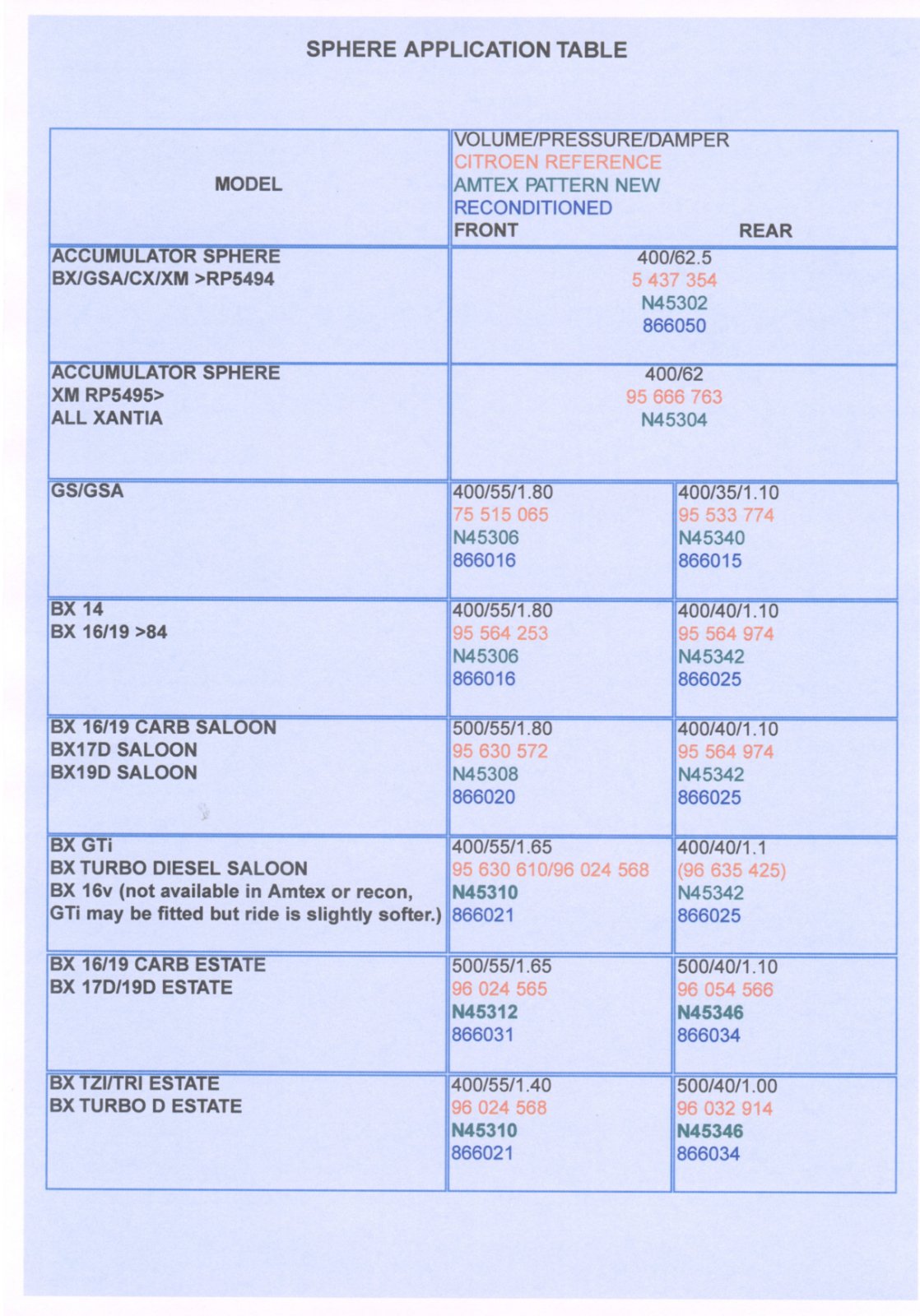

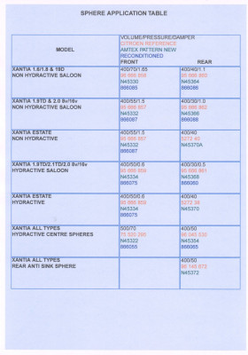

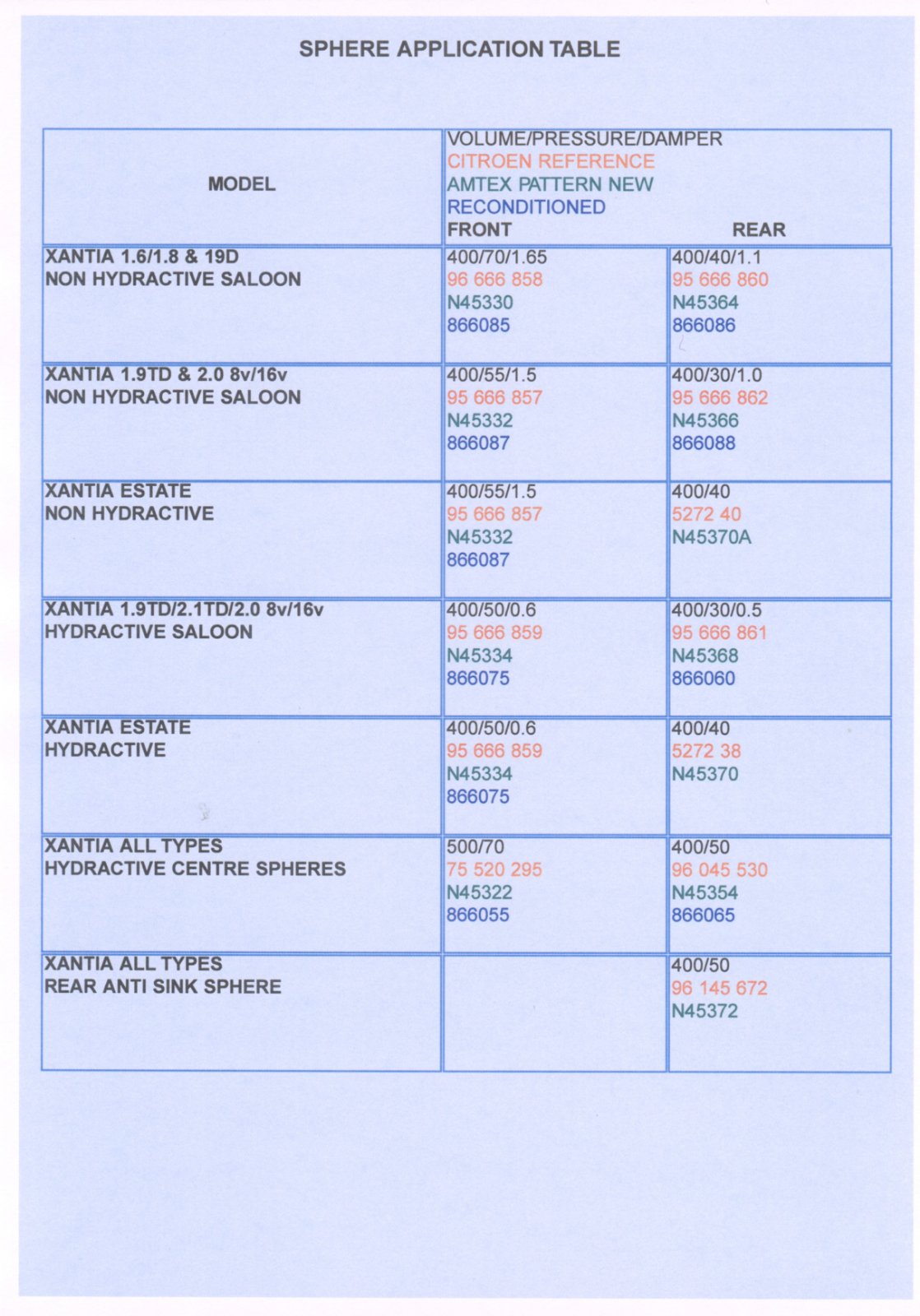

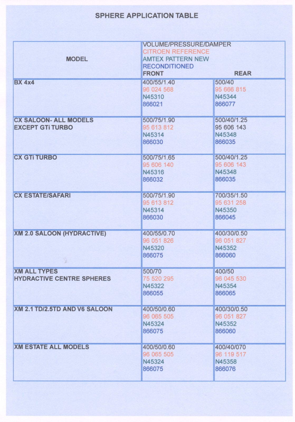

Found it - the missing damper data for that sphere:
400/70/...
Really difficult to track down, as various folk (Citroen Parts, IFHS...) don't list it, only the volume and pressure.
Get the damping figure wrong, and you could be All at Sea, literally. (Ask Graeme.)
Had forgotten all about this old table, which contains rather some very full info on sphere for the various vehicles. The part numbers are mostly still current.
Not sure where this came from, but it does tell the whole story.
Check also against Private Cars data, and Parts, when ordering.
So our unloved 95 666 858 appears at the top of p.3, and is 400/70/1.65, in case anyone wants to use it elsewhere.
400/70/...
