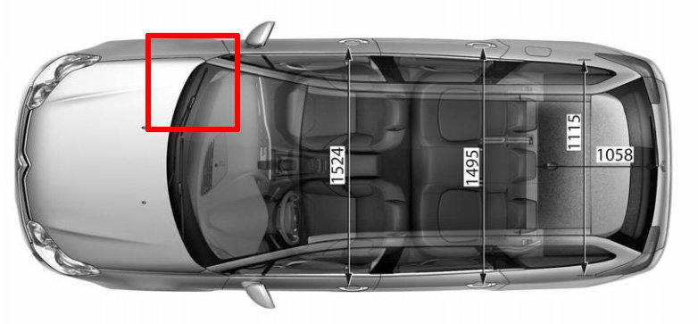

Yes, all of the above mentioned has been checked first time. Unfortunately none of them.GiveMeABreak wrote: 01 Nov 2019, 02:42
Just a few ideas - might be off beat but it has to be something that's moving about and I'm almost 90% sure it's int he cabin somewhere.
The noise is coming from this area (at least I guess) I already think it coming not from the cabin but definitely near to it.
What else can it be? Some part of the suspension?
Thanks

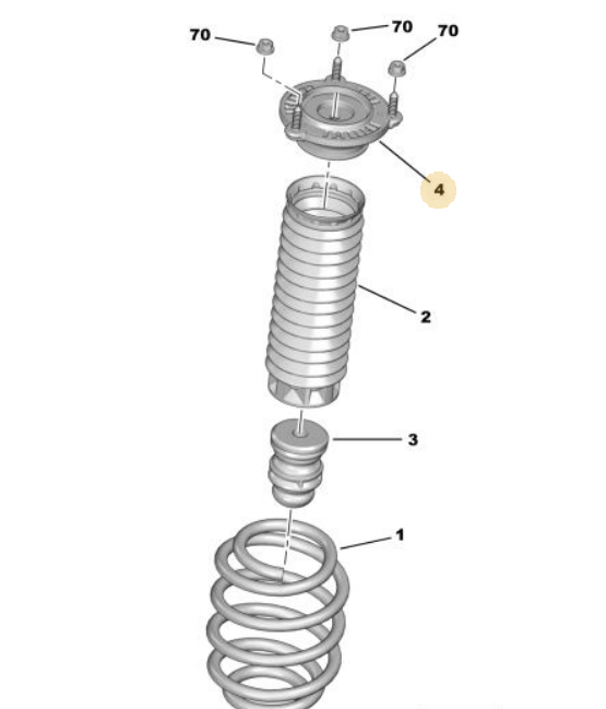

I was going to suggest an engine mount next, but glad you have nailed it down - that would make sense it being a suspension strut mount as it is very near the area you indicated.
4 is the strut bracket (part 5038E6) for reference.
