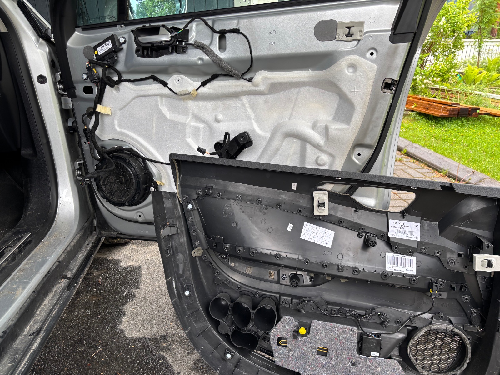

Is it really "not-doable"? Is there a differences in wiring outside door panel? I have x7 with heated/massage/memory seats - would like to move them to basic model with only heated seats. Naturally can move all switches and (inside door) cables easily from donor car.
In image is a door of this Exclusive version with electrics (passanger door on LHD), Nordic model if that makes any difference. What is that ecu box on upper left corner - for index mirror?
