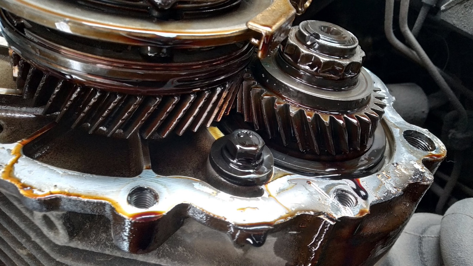

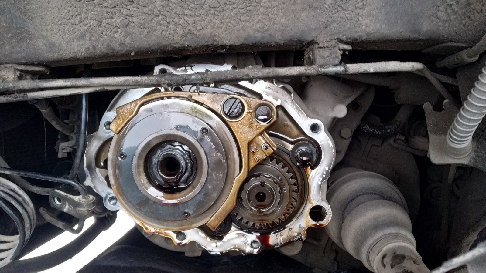

I’ve finally had chance to look at this again.
The selector rods on the gearbox all look fine. With the gearbox endplate off I can clearly see 5th gear engaging fully. I swapped the gear over from a secondhand gearbox but the fault remains. With 1 front wheel off the ground I can turn the wheel and see the engine turn over, after half a turn there’s a judder and graunch in the gearbox.
Any thoughts?
Thanks
Any thoughts?
Thanks

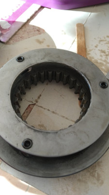

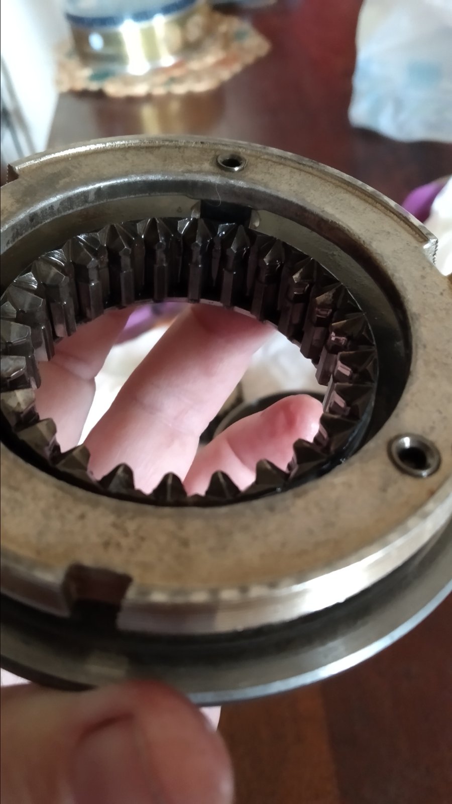

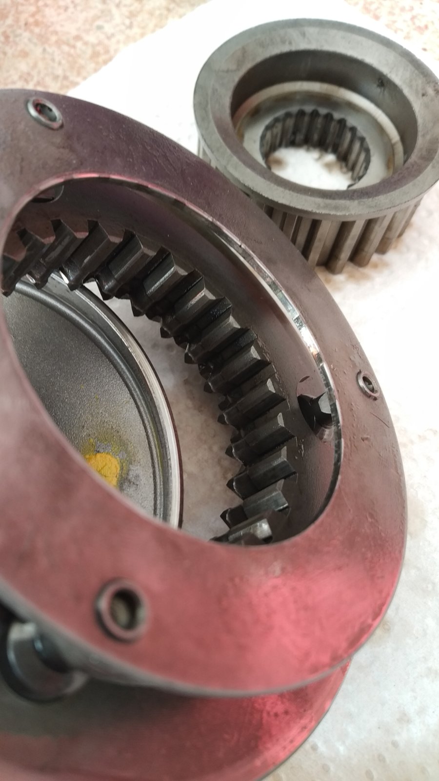

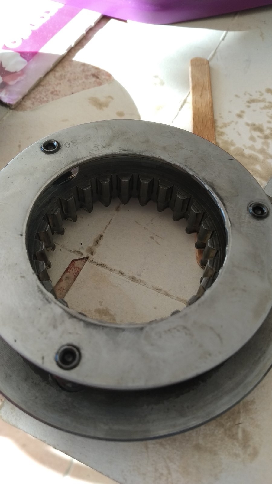

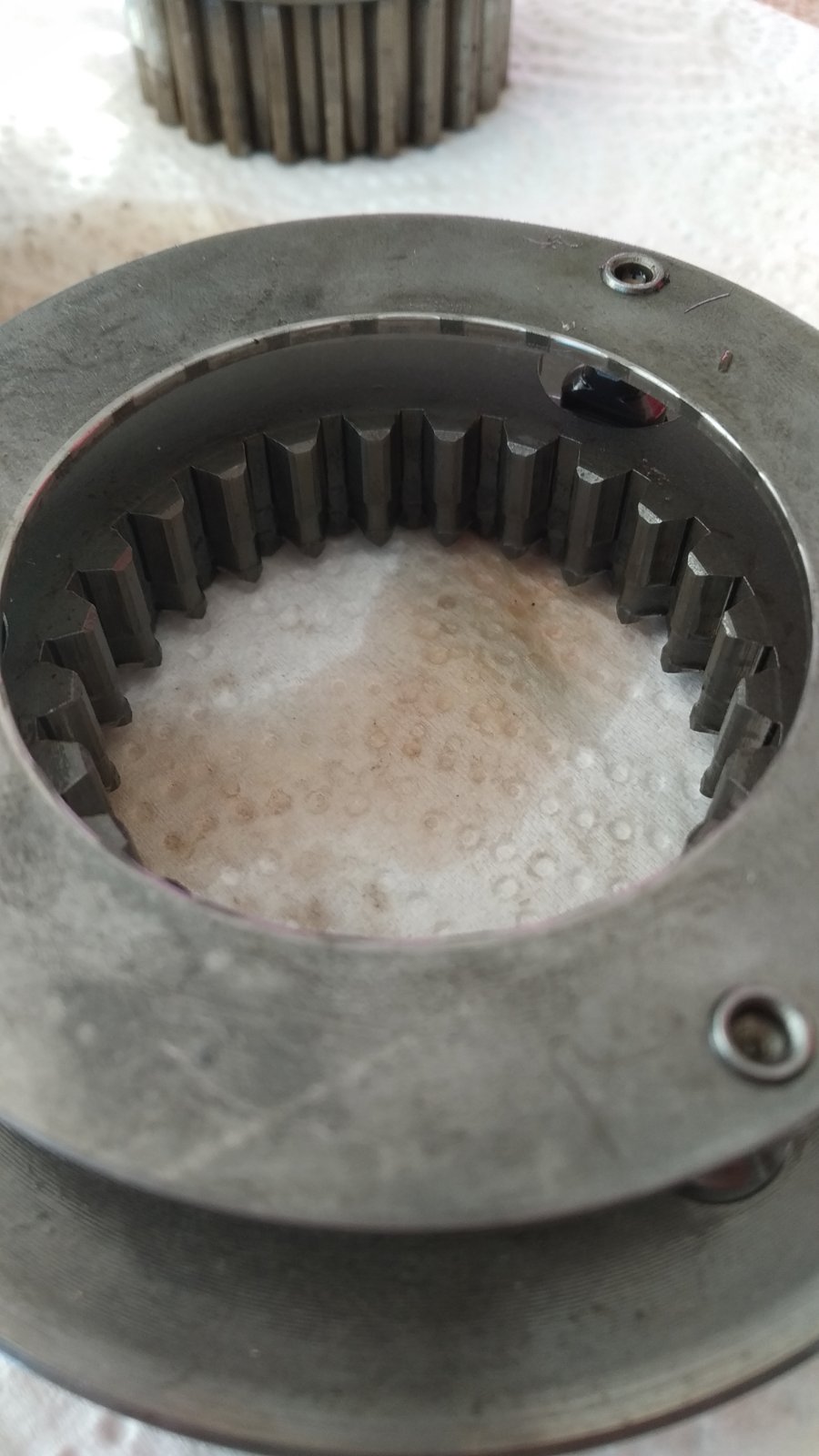

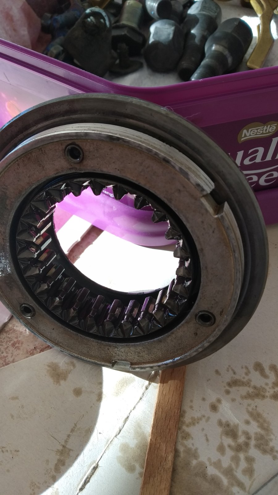

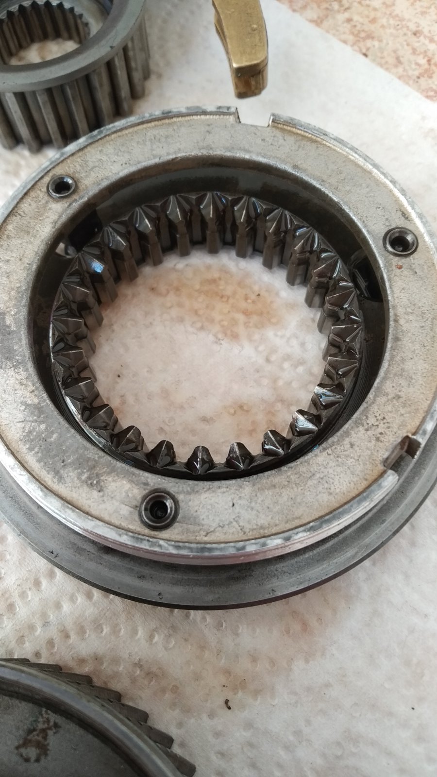

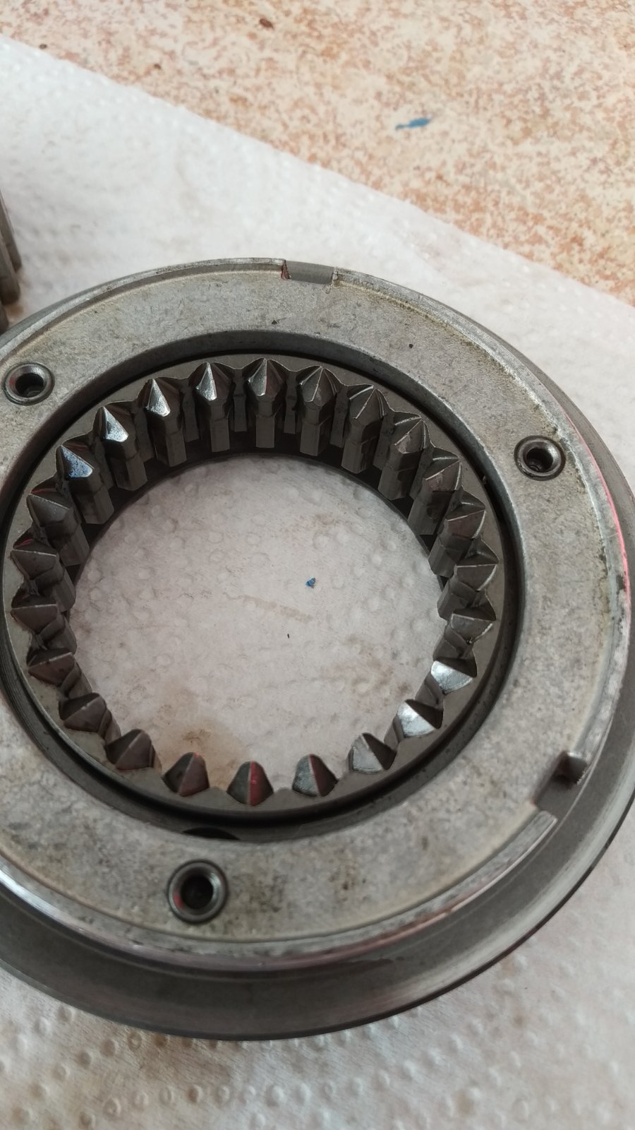

Your gears look pretty chewed up with indents in middle.
For now, I see your options as, bad bearing which causes gear to jump out due to side torque.
Gear freely spinning on shaft.
Gear getting angled when you apply torque.
None of which is good but what can you do. I'd recommend getting another ML5 box from the wreckers. They are reasonably cheap.
Getting a bearing etc. replaced and shimming it can be a major pain.
Fix your release bearing too and clean the gearbox shaft and just replace the clutch.
It is hard and impossible to find out what's really wrong. Xantia's had problems with gear linkages that caused improper meshing of gears and tightening/putting strain on geartrain.
As said, if you remove the linkage, you should be at least able to put it in all gears. And yes, don't rotate engine backwards, timing belt is not made for that.

Are you sure the gear is actually keyed to the shaft and not rotating independently? It does look a bit chewed up at the end. I always used to get a secondhand box for spare parts, new bits are expensive, there are probably some going for scrap - if you can find them.

Is the gear actually turning the shaft round? I don't know how the drive is transmitted, presumably the synchro hub is splined to the shaft so the gear should lock into it when engaged. Did you change the synchro hub as well or did you notice any damage on it?

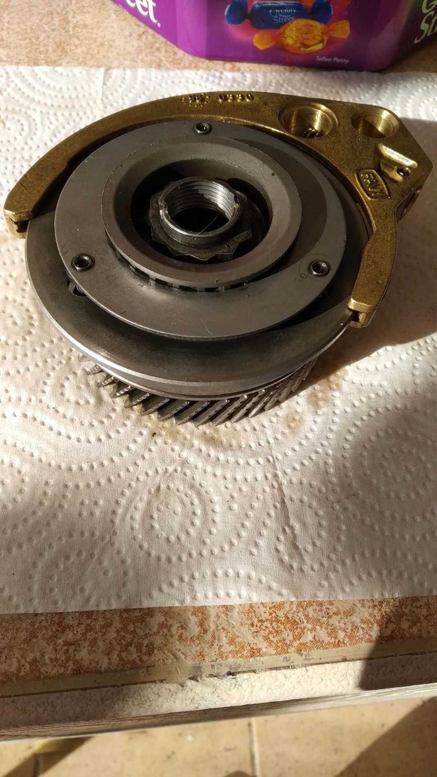

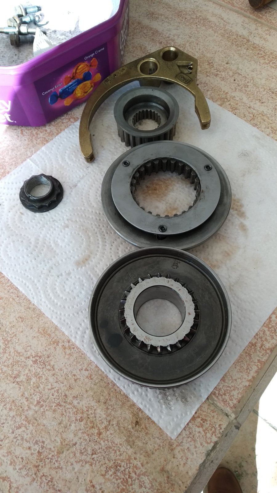

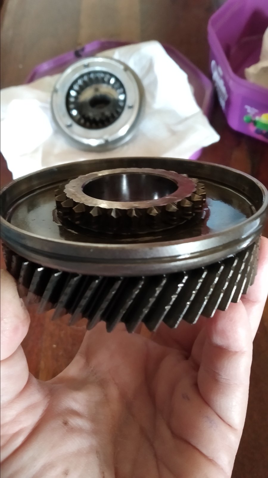

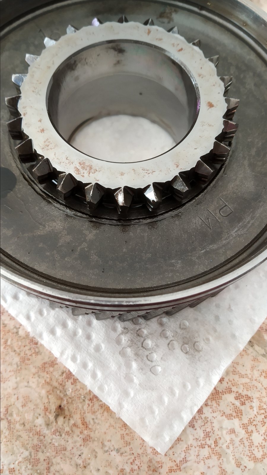

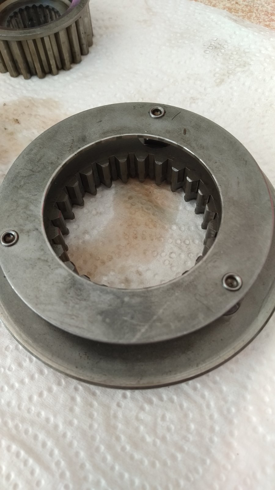

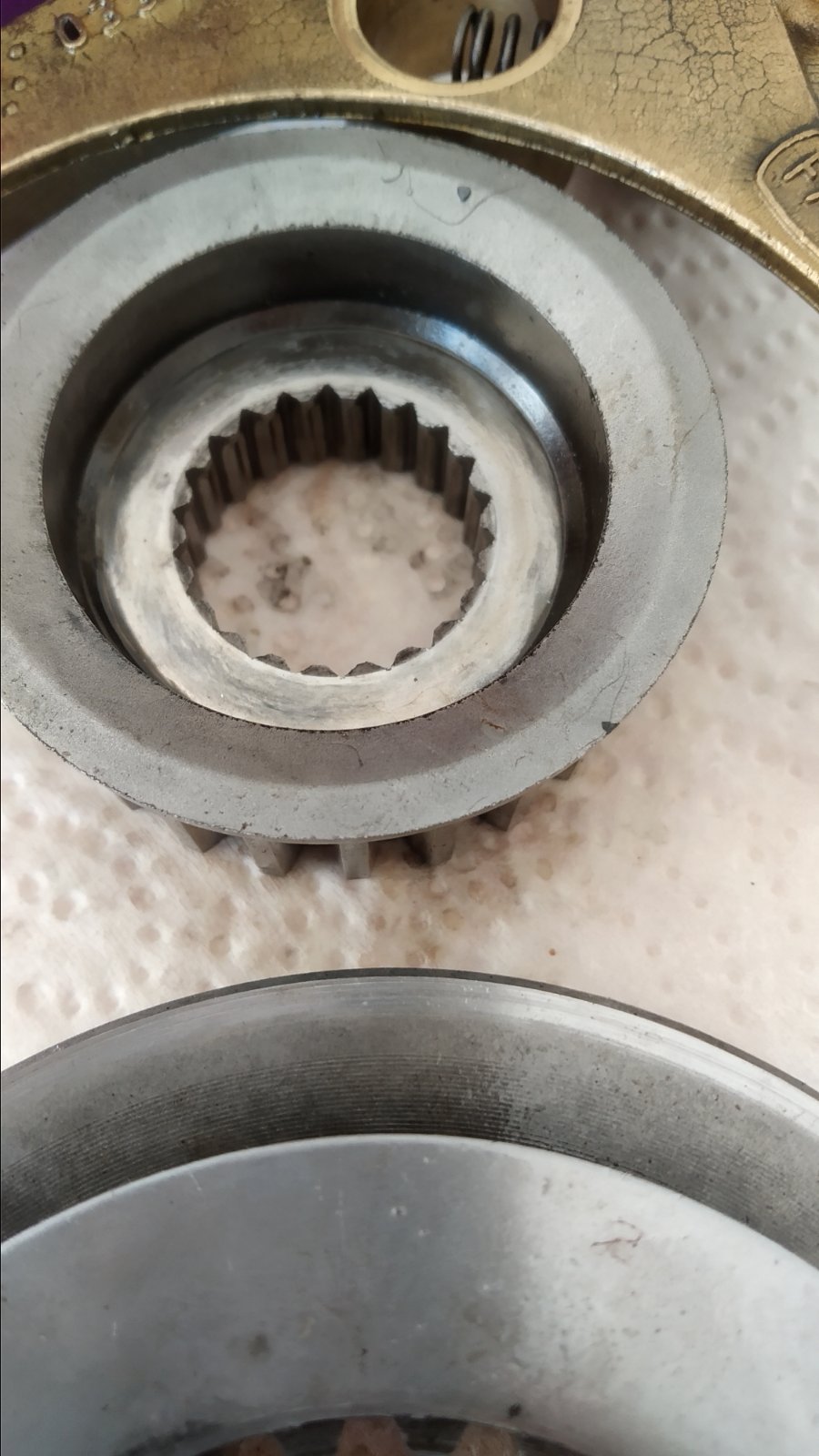

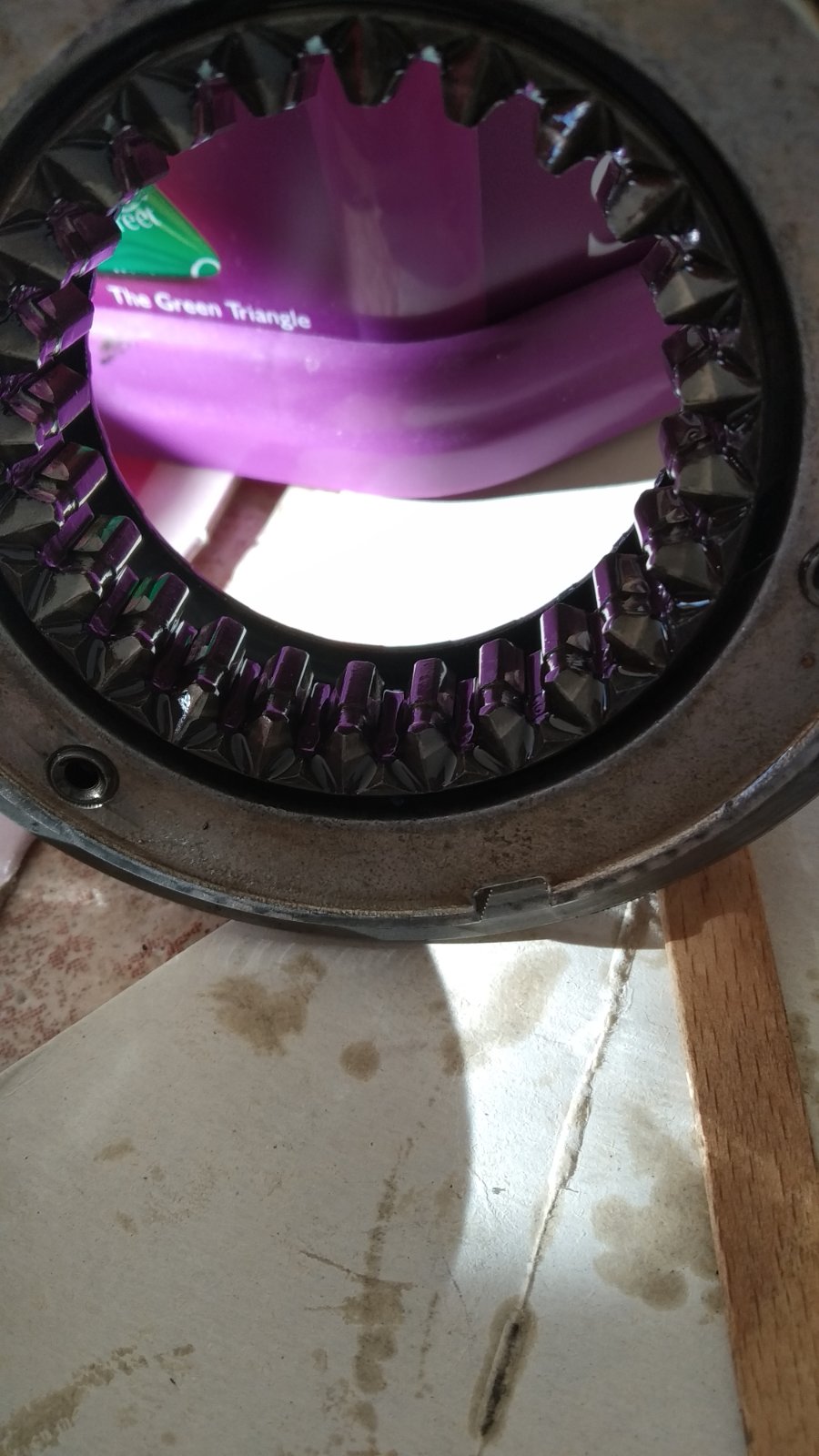

I changed the whole lot, except the plain bearing as I thought that might be matched.
Some pics of the original gear. (There's a pic of the second hand gear in there somewhere but I'm lost as to which me it is - they look the same!)
I've ordered a clutch as it wants changing anyway. Going to disconnect the gear lever to make sure that the engine isn't pulling it out of gear. Thought I might take the gear plate off and watch what happens in 5th as it goes clunk.

Basically what you are doing is, gears are always engaged (except reverse), you are just engaging and disengaging the sleeve that connects it to a shaft.
Check if the gear on reversing shaft doesn't rotate freely (the only shaft with fixed gears, they are press-fit.
download/file.php?id=19542&mode=view
Not sure if that inner part should be rotating, looks like it's welded. Or it's just me

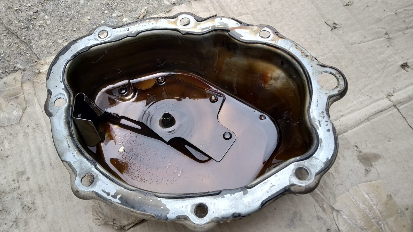

I’ve finally got around to getting the gear box out. Going ok so far. What’s with the plastic tray on the top of the gear box? Sigh. Will let you know how it goes.
