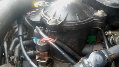

Perhaps you can post a photo of your engine bay, and the water outlet?

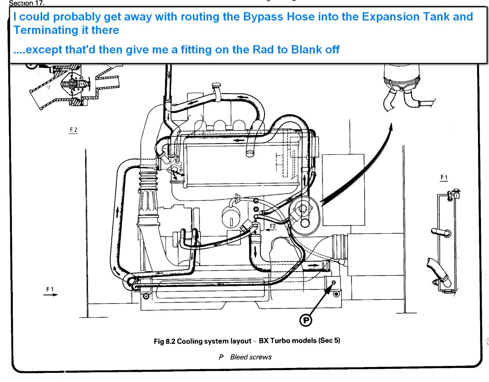

I'm getting there Chris, edited copies of your images with text as I'm 'getting it'
It'd be really helpful if one of my BoL's gave me a Cooling Schematic for my 405
....but while BoL 950 (Peugeot/Talbot Diesel Engine) gives me a very early one
....BoL 3198 (405 Diesel) doesn't supply one at all.
Its raining hard here at the moment so I can't take a look under the bonnet very 'efficiently' as yet to work it out that way, but I'll get there.
Next thing is, where is the Hose that I'm going to put on the Bottom of the Expansion Tank, to Feed into the junction at the rear of the engine; attached at the moment. We have a temporary Printer Scanner at the moment hence the Heath Robinson approach .

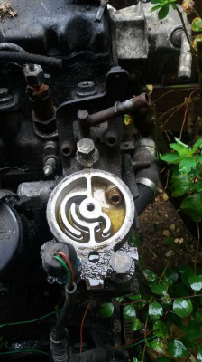

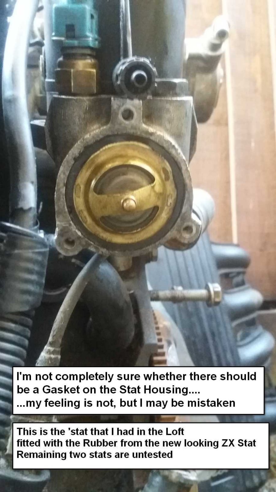

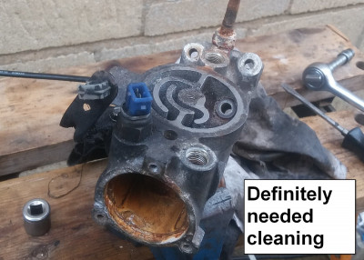

I was busy with the Fuel Filter / Stat Assembly yesterday by the way. Imagine my delight, upon spending the better part of an hour cleaning that off the ZX 'Spares' engine, which was much cleaner than the 306 one (in part coz, unlike the 306 lump, its been stored with its Fuel Filter Housing on it for the past three years)
...to realise that the Cable for the Cold Start was badly frayed at the clamp, so its 'unusable' without changing the Cold Start thingy.
...so I ended up cleaning this. Its now re-fitted, with stat; but I omitted to get an 'overview' photo. I was tempted to use the shiny new looking stat from the ZX lump, but nowhere was it marked with its opening temp; even though the mfr had bothered to stamp it "Motorad" which was a bit daft, so I robbed its un-perished rubber for this one which I've tested on which the rubber was perished.
Does anyone definitively know whether there's s'posed to be a Gasket on this housing, I think not, but I'm not 100%

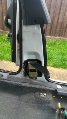

I also took half of the Interior of the car apart to lift the carpet, I'd forgotten that you have to take top and bottom trims off to get to the hidden B Pillar screws behind the seat-belt. That was boring. Having lifted the carpet I did find just a little water, enough to feel my efforts had been worthwhile. I'm gonna put that down to a window left ajar, unless it happens again... More worryingly, I also found water beneath the rear seat on the Offside, that's probably coming up past the Fuel Tank Sender. Another time, bigger things to think about....

I’ve been over-thinking this, haven’t I (it’s a family trait)
So all I have to do really is to divert the Bypass Hose at its connection behind the Fuel Filter Pot, with a new length of plain Hose, to the Header Tank
and onwards to the Radiator via the Original Bypass Hose, which I'll need to lengthen a little (its a special 'Bayonet' type fitting where it meets the rad, so I can't use plain Hose) .
and that’ll do. Simple as that !

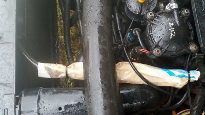

The Air-Con gubbins, circled, will be coming out, so I can bang it on the Bulkhead here, in much the same place as shown / described on the BX.

If you could post a photo of the thermostat housing/water outlet/where the temp sensors and 'stat are, that would be of interest.

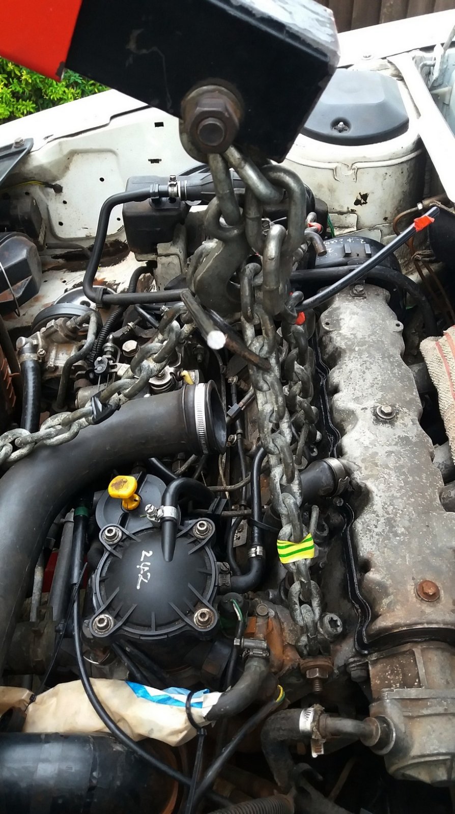

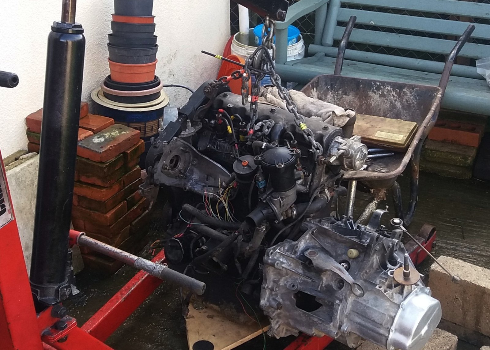

Thanks Doctle, with that in mind I'm gonna hold off on the Compression Tester for the minute; I did think that in all probability a Ratchet on the Bottom Pulley was never gonna suffice.
I have however just bought a 'new' Engine Hoist, which as yet I haven't collected. It may be the case that I can get it sufficiently steady, perhaps with a couple of Ratchet Tie Downs secured either end of it to Tent Pegs or similar; that I can spin it up on the Starter....
...or it may just flail about crazily, making it impossible to short the main lead and the Solenoid connection effectively.
Will it try & rotate 'backward', ie toward the Bulkhead, when the Starter turns?
Space limitations mean the lump 'll have to come out 'upwards', with the car returned to its wheels (and therefore the subframe in situ) to be pushed away backwards once the engine's clear of the slam panel. I won't have room to pull the engine & hoist forward of the car. Might be simpler to to detach the Gearbox before lifting, will see.

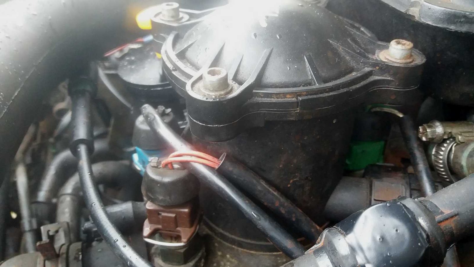

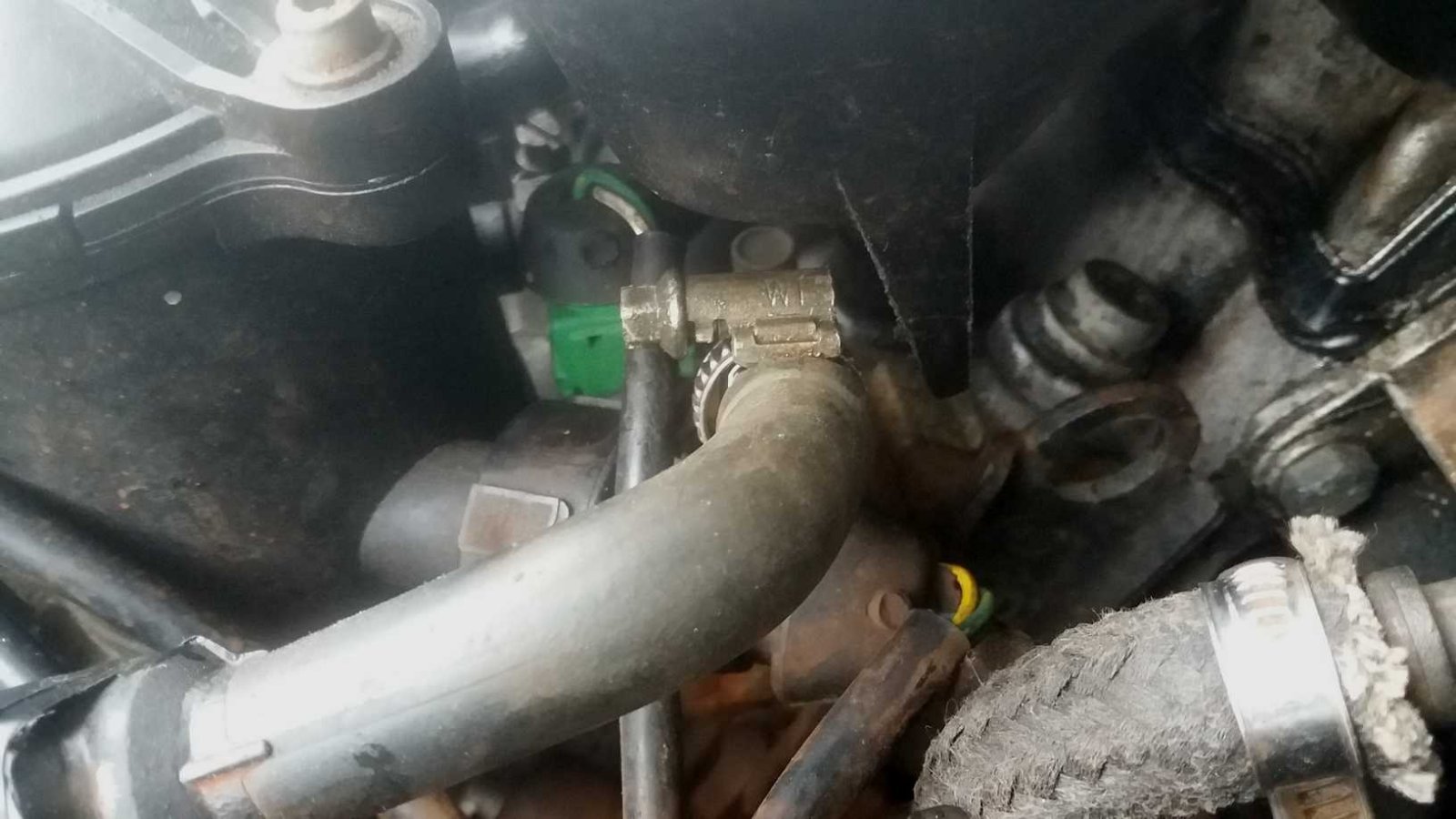

Chris: Sender pics as suggested.
My 405: if I'm correct the Brown Sender nearest the camera is for the AC. I need to careful where this gets its power in the course of removing what's left of the AC; as disconnecting this trips the fan failsafe to set them on fast. Blanked on the spare engines.
Blue I'm guessing is Temp Sender 'after Stat', this is common to the 306 and ZX lumps also. If I remove the feed to this the Temp Gauge still works.
Green sender partially hidden behind the Fuel Pot I'm guessing is Temp Sender 'pre-Stat'. I'ver never tried disconnecting this as its difficult to access The eagle-eyed might've noticed two pin pricks in the insulation tape on my Bypass Hose, where the Bleed Screw should be. This together with this ugly bit of plastic bag, is my attempt at a 'Self-Bleed' until I've got a header tank on it; and ultimately its 'new' engine. Obviously it'll lose coolant too, but we'll see how quickly. Its primarily about keeping the coolant away from the air intake, which also has Insulation tape around its holes. I've not changed the Fuel Filter in 32k, but its never run low, so its of marginal importance. Better pic of the green Sender behind the fuel pot. Fuel pot sender also visible (with green/yellow wires) This is the ZX Lump. The Senders and Blanks were the same on the 306. Neither had AC IIRC (the 306 didn't even have PAS) I can't be sure, but I'm guessing this is the second water temp sender on the ZX. Apologies for awful photo. Its pee-ing it down here again so I've used what photos I have rather than uncover the engines. Only the ZX Lump has this Sender, on the other two engines its blanked off.

Coolant temp sensor colours are pertty much standardised across our engines:
Brown
Triggers cooling fans to come on at full speed when it goes open circuit (or disconnected).
Early cars - simple switch
Later cars with ECU controlled fan speeds - variable resistance
Blue
Feeds the gauge (called 'dial' in some parts lists)
Variable resistance
Green
On fuel-injected cars, this feeds coolant temp to the injection ECU.
Not sure what this might do on your NA engine.
???? Could be a High Temp dash warning light, and this a simple thermal switch ????
(BX had one of these)
Any spare port on the water outlet casting will do for the header tank.
Blue
Variable resistance
Green

So, a little update from me.
Engine lifting was uneventful, save for a slightly bent Lifting Eye. Its easy to see why it bent, coz without a Spreader Bar, I'm 'pulling sideways', so I'm going to look at potential ways of strengthening the mount / bolting up something stronger.
One of the key reasons for the dry run was to see how much the engine moved on lifting; and I was surprised that the answer was 'very little'. If it was gonna sway like crazy on lifting and potentially put a huge crack in me front end, which I've toyed with removing but probably won't...Pump ....I wanted to know about it in advance. It just came a little 'vertical' and dipped slightly at the Gearbox end. Definitely nothing to be concerned about.
The new Header Tank and all of its associated Gubbins are here, including some eye-wateringly expensive Hose (nearly £8 a metre). I worked out I should need about 130cm including an 'Overflow'. Seeing as the car's running so well, time is short and it just keeps on raining every time
I try to make progress (its that time of year after all); I've put off fitting it for the moment, which I can see taking hours on end by the time I've faffed with suitable bracketry to get it to mate nicely with the Bulkhead.
Instead, getting the engine 'turnable' is the next priority by fitting the 'new' Injector Pump thereby allowing me to 'unlock' the Cam Belt Pulleys.....
...next time.

Puxa
- x 1751
Re: 405: Major Works
The header tank is very posh; didn't expect that!
Is its cap a pressure cap? Needs to be about 1.3bar.
