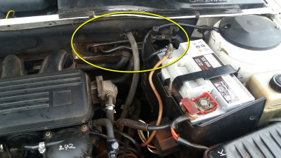

The Air-Con gubbins, circled, will be coming out, so I can bang it on the Bulkhead here, in much the same place as shown / described on the BX.
