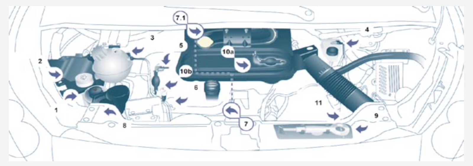

- x 6946
Re: Citroen despatch 1.9 diesel fuel issue?
Click image to Zoom
For the 2:0 Lt engine the priming bulb is 10b
