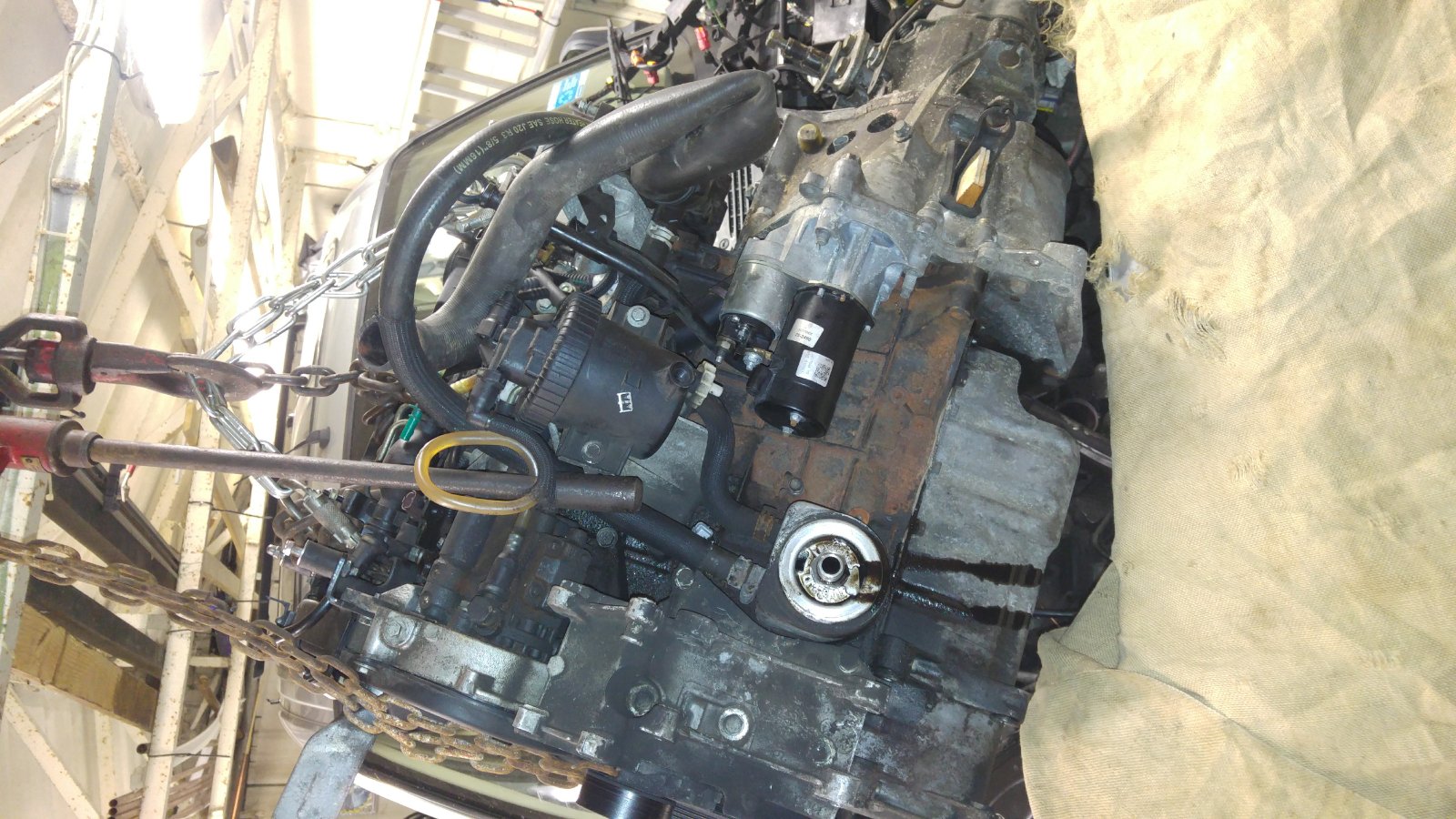

Don't mind about the VIN number. If the engine is a 2.0Hdi on a 2005 Berlingo, the starter motor is in the front of the engine. When you look from the front, the starter motor points to the left from the flywheel and is attached with 3 bolts. They usually have 8mm hex heads and are in a tight spot. Good tool for them is a ratchet spanner with a 8mm hex bit.

You can see it in this photo
2.0 hdi 2004
